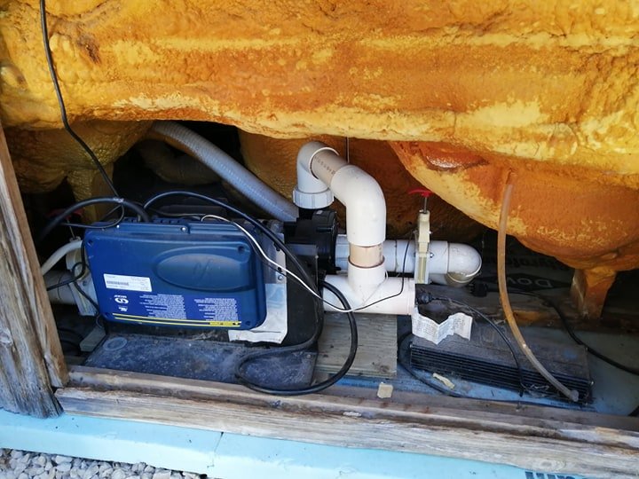

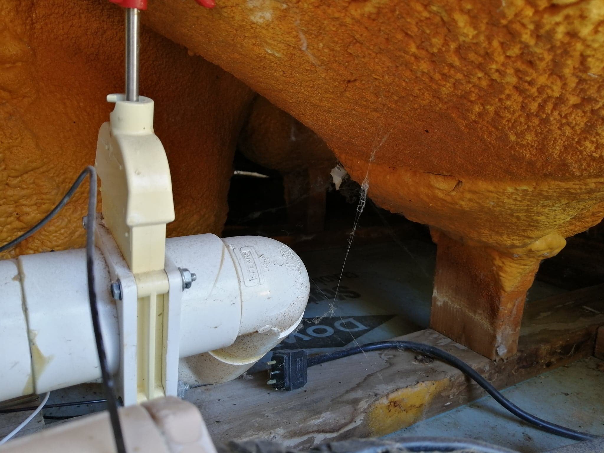

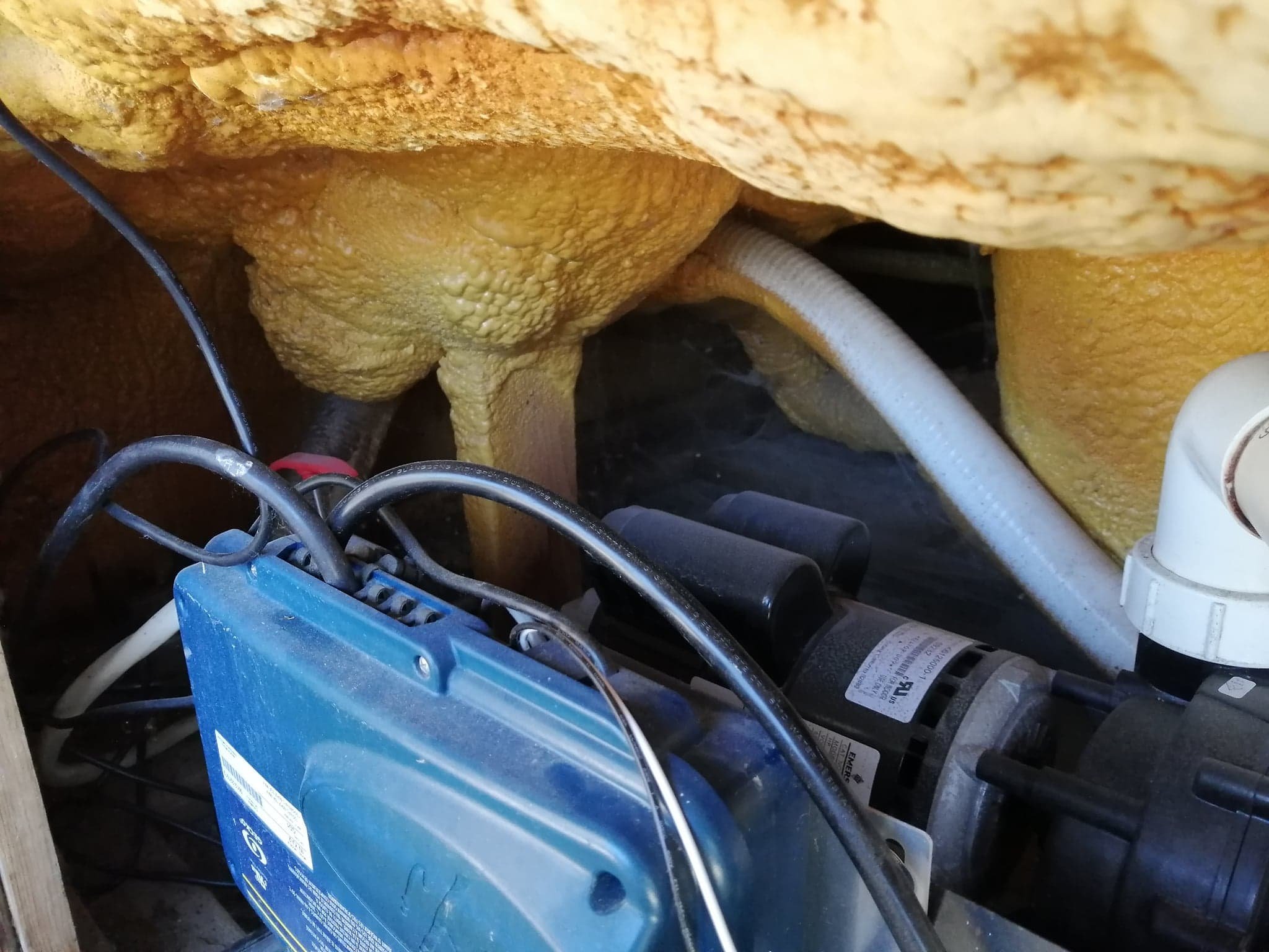

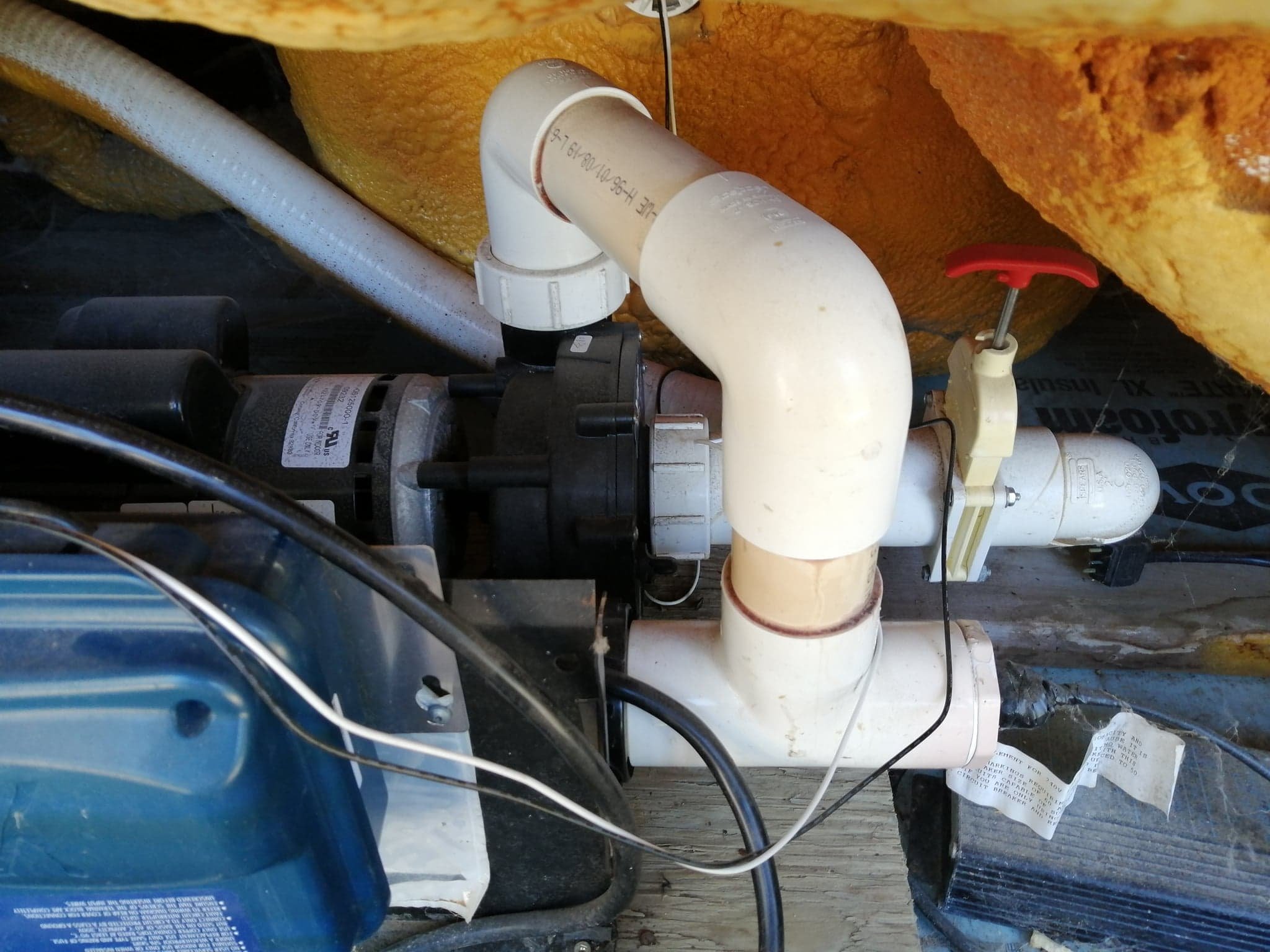

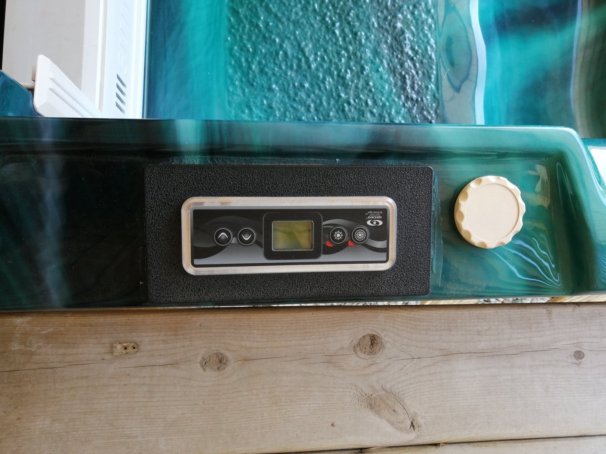

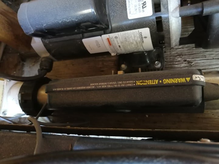

north Posted June 28, 2020 Author Report Share Posted June 28, 2020 14 hours ago, RDspaguy said: Post some pics of the equipment area, paperwork doesn't help us see it. It is probably a small hose coming off of the pipes near the pump and could be stuck back in a corner or have the connection on the bottom edge somewhere. It may have been removed, as they are a common leak issue. I use this. https://www.spadepot.com/Shake-a-Vac-II-Spa-Pool-Water-Vacuum-Drain-P850 Thanks. Wasn't sure what was important to see so I took pictures of everything. Quote Link to comment Share on other sites More sharing options...
RDspaguy Posted June 28, 2020 Report Share Posted June 28, 2020 Look around the very bottom edge on the outside of the spa for a hose connection. It is often at a corner near the equipment, sometimes recessed under the rounded corner cabinet. They are infrequently used and often break when fiddled with, so I would still recommend the link I posted or the hose trick suggested. Or even a cheap sump pump. Of course, disconnecting any of the threaded union connections at the pump or heater will dump it fast but will get the equipment wet. Quote Link to comment Share on other sites More sharing options...
