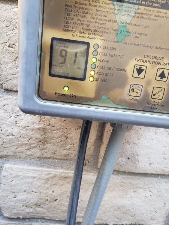

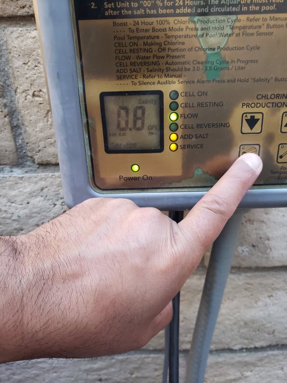

Harry2212 Posted June 5, 2020 Report Posted June 5, 2020 (edited) I have jandy aquapure 1400 model with service light on and cell on light is not on with salinity at 0.8 ppm Edited June 5, 2020 by Harry2212 Pics Quote

Elemental Construction, In Posted April 22, 2022 Report Posted April 22, 2022 Turn off the system and unplug the little board and then reinstall it. Turn on the system, wait for about 5 minutes, and then hold the little white button for 5 seconds. otherwise You need to replace your sensor. Quote
