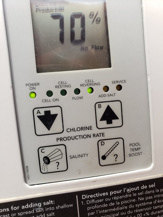

dkstl Posted March 29, 2014 Report Share Posted March 29, 2014 Periodically, I get low flow indications after I installed a new trisensor on my AquaPure 1400. Should I press the calibrate button when the pump is on low speed or high speed? Also, does the system produce the chlorine when it senses a low or no flow condition? Thanks Quote Link to comment Share on other sites More sharing options...
Pool Clown Posted February 12, 2015 Report Share Posted February 12, 2015 Lo is a low water temp, not lo flow. No flow will not produce Cl. You can push the calibrate button on either speed as long as you are not getting a low flow display on the LCD. I realize it has almost been a year since you posted this. Sorry for the delay. Quote Link to comment Share on other sites More sharing options...

Russmd Posted April 26, 2016 Report Share Posted April 26, 2016 I've been wrestling with the no flow situation on my Aquapure 1400 for years. I've been through new cells and sensors. Newest sensor was 6 months ago, the newer kind with 2 silver discs and the little box in the cable. It fits into the third port of the cell. I keep it very clean. Lately, I've been getting the flow light sporadically off again, doesn't generate chlorine. No error codes. Chlorine level is perfect, 3200, by sensor and test strips. Flow is excellent, 50gpm on the flow meter. All board tests are good. It is extremely annoying. My cell is on the same switch as the pool pump - what I'd really like to do is void all the warranties and find out a way to bypass the flow sensor / spoof the system that flow is good. Perhaps a "wiring modification" however I'm not sure how the flow sensor even works. Any explanations, thoughts, or ideas? Thanks, Russ Quote Link to comment Share on other sites More sharing options...
Russmd Posted April 26, 2016 Report Share Posted April 26, 2016 Ok, Am I correct in assuming the flow is measured by thermal mass dispersion? One of the metal sensors is heated and its temperature measured vs the other sensor (control). The faster the flow, the faster heat is carried away from the sensor and the less the temperature difference between It and the control. If that's the case, I was considering experimenting by placing a small baffle or diverter in the cell that diverts more flow directly onto the sensors, thus dissipating any difference in temperatures much faster. Any engineers out there have a comment on this? Quote Link to comment Share on other sites More sharing options...
Pool Clown Posted May 12, 2016 Report Share Posted May 12, 2016 You are correct with how the sensor "feels" flow. Circumventing the unit's flow sensing capability is extremely dangerous! The unit must be able to tell when the water flow stops. You may think that when the pump shuts off, that the unit will shut down (providing that the unit is wired to the pump) and, no problem. This is true, however there is a scenario where flow can stop without the pump turning off. In the event where the water level drops too low, or otherwise the pump looses prime, can create a condition where the unit would continue to produce hydrogen gas in the plumbing and, well, you can imagine what could happen. There was one customer that had two separate bodies of water with two separate sets of equipment. He couldn't figure out why every couple of days the plumbing on his spa would explode! Turned out that he had his cell cables crossed, and was producing chlorine/hydrogen in an environment where there was no flow. Quote Link to comment Share on other sites More sharing options...

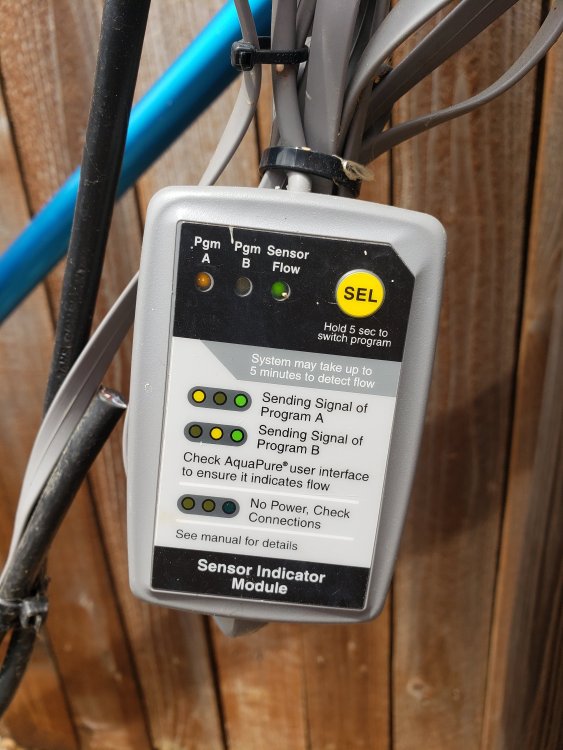

BorisDDS Posted July 10, 2016 Report Share Posted July 10, 2016 Hi Pool Clown. I have a question/problem my jandy nature2 fusion had a salt water sensor replaced last week, the previous sensor didn't have anything attached to it other than cord, new sensor has a small board "sensor indicator module, but the main iAqualink always show cell reversing, is there a programming need to be done for the unit to operate correctly? Thank you for your help Boris Quote Link to comment Share on other sites More sharing options...
Pool Clown Posted July 14, 2016 Report Share Posted July 14, 2016 To answer both of you... The parts that you purchased should have had an instruction sheet with them. If lost or stolen, you should be able to get .pdf's for them at http://www.jandy.com/en/products/water-sanitizers/aquapure Quote Link to comment Share on other sites More sharing options...

sc5.4 Posted January 9, 2017 Report Share Posted January 9, 2017 Do the new type R0452500 Jandy Flow Sensors still need the little calibration circuit board like the ones before? Or does the new one have it built in the box on the cord? Quote Link to comment Share on other sites More sharing options...
Pool Clown Posted January 10, 2017 Report Share Posted January 10, 2017 I don't think there is the board anymore. To be honest, i haven't worked on one in a while. I have kinda gone in another direction with SWCG's. Now i'm mostly installing/replacing with the IC40's. A lot less problems. Quote Link to comment Share on other sites More sharing options...
sc5.4 Posted January 14, 2017 Report Share Posted January 14, 2017 I don't think there is the board anymore. To be honest, i haven't worked on one in a while. I have kinda gone in another direction with SWCG's. Now i'm mostly installing/replacing with the IC40's. A lot less problems. FYI -I just installed the new style flow sensor. It doesn't need the calibration board. My black epoxy sensor failed after getting a bubble type crack in the epoxy that let water into it. That caused a 170 code right away. Quote Link to comment Share on other sites More sharing options...

Beths Posted May 31, 2019 Report Share Posted May 31, 2019 I have a no flow light on with a new salt cell. Any suggestions Quote Link to comment Share on other sites More sharing options...
Pool+Sun=Fun Posted August 7, 2019 Report Share Posted August 7, 2019 Hello, I'm hoping Pool Clown will give some guidance please! so basically my question has been asked by alwaysproblems. Our pool is aprox 30000 gal saltwater with Jandy pro series equipment. Pool built 2009 new to us as of this yr. We have replaced the salt cell and the flow sensor already....help what do we need to do now? I cleaned the filter hoping that would solve the problem but that didn't help...today the pool shut itself off for about 3 hours. I turned power supply off wait and turned it back on....took 20 for it to come back on...the whole time the sensor lights took turns going on and off but the no flow and Question; choline indicator is at 70% but says no flow and the cell reversing light stay on and the cell reversing light stays on too. Thanks in advance. Quote Link to comment Share on other sites More sharing options...
