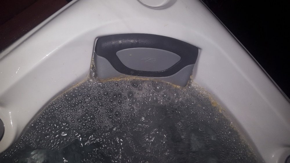

Goldglv Posted June 26, 2018 Report Share Posted June 26, 2018 I've seen this yellow gunk around the water line before, usually shows up when the jets are running then seems to disapear. I've only had the hot tub for about 6 months, I add bromine and shock once a week. Last night I decided to completely empty the hot tub so I added half the bottle of Sea Klear System Flush, let the jets run for about 30 minutes, emptied the hot tub and scrubbed down the shell. Rinsed inside with the hose, emptied out what I could again using a pump. Then I added fresh water, turned the hot tub back on, started the jets and saw all this junk again. Anyone know what this is? Since I already emptied and started with fresh water, how am I supposed to get rid of this? Thank you... Quote Link to comment Share on other sites More sharing options...
rftsr Posted June 26, 2018 Report Share Posted June 26, 2018 It's a biofilm which is a cluster of bacteria that is hard to kill and lurking deep in the plumbing. Really gross and a bit unsafe as clusters of bad bacteria would be. You can use a product called AHH-SOME which will clean it ALL from the interior pipes. This does not happen if spa is maintained chemically with sanitizers. I would switch to Dichlor instead of Bromine and shock once every 2 weeks at least and change your filter every week. This has happened to many who think they are properly sanitizing but are not, so don't feel bad. 2 Quote Link to comment Share on other sites More sharing options...
Goldglv Posted June 26, 2018 Author Report Share Posted June 26, 2018 I was planning on using Nitro's Decontamination procedure but I'm reading mixed things about bleach being safe to use...... Quote Link to comment Share on other sites More sharing options...
rftsr Posted June 26, 2018 Report Share Posted June 26, 2018 I use Nitro's Dichlor and Bleach method and it's a breeze! Just make sure you use regular plain Chlorox and not the splashless. I used that once and Foam City. I've also used AHH-SOME on and older tub and you wouldn't believe the gunk that came out. It was really super clean after. 1 Quote Link to comment Share on other sites More sharing options...
