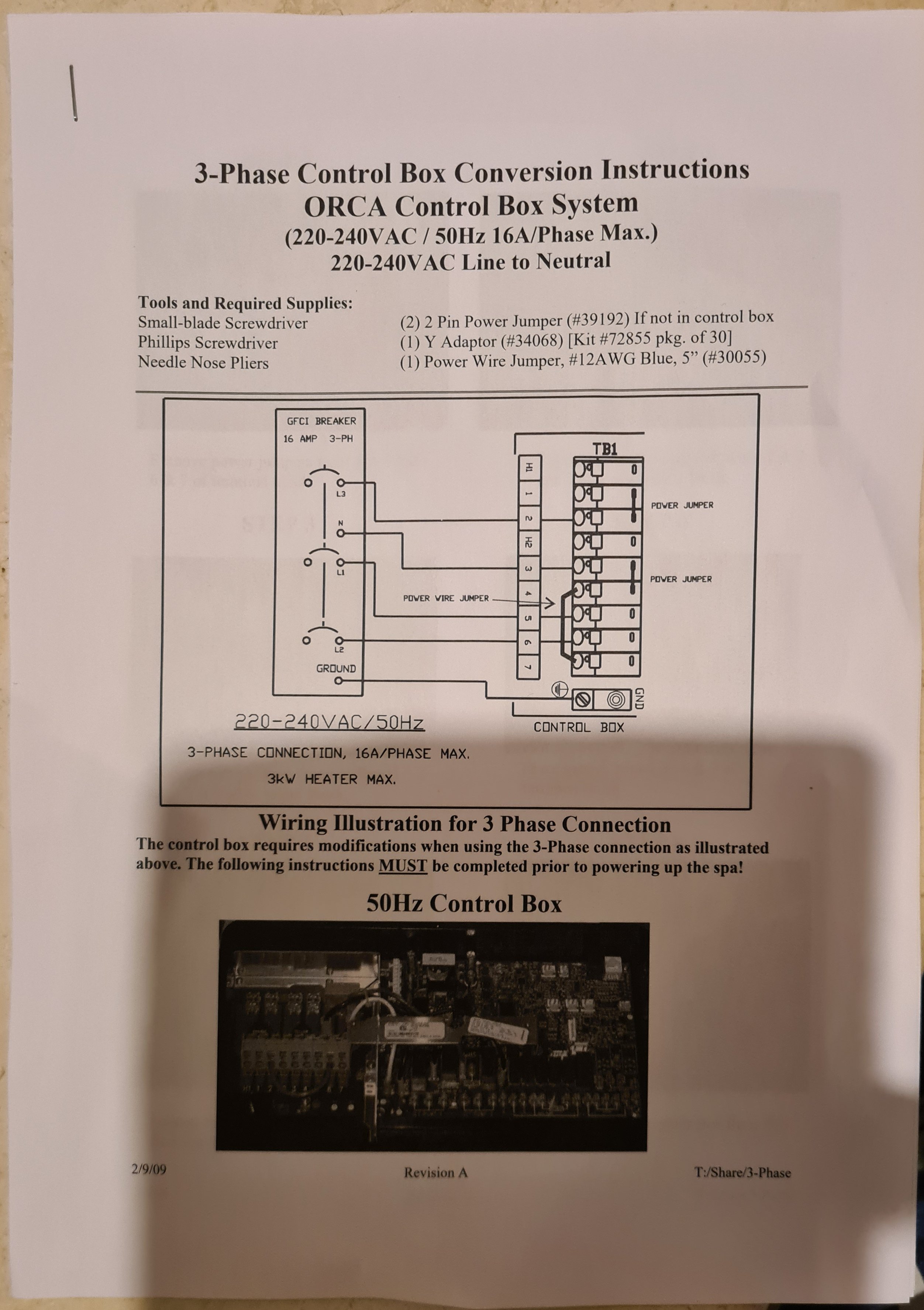

martijndk1983 Posted January 27, 2022 Author Report Share Posted January 27, 2022 @RDspaguy I don't want to be a wise guy but look what I have. The full schematic and how to for 3 phase.Don't know the benefits but it is possible. I have it from a hotspring dealer. Quote Link to comment Share on other sites More sharing options...
RDspaguy Posted January 27, 2022 Report Share Posted January 27, 2022 But it's still 220-240v, as it shows on the diagram, not 380v as you said in your post. You're just using a third phase for the other circuit. As I said before, raise the voltage and you fry the board. This does not raise the voltage, though you might read a higher voltage in the box if you test across circuits. Nor does it offer any advantages over using it single phase, aside from one less wire in the conduit perhaps. I'd have to see the single phase wiring diagram as well to see if it changes the heater voltage, but I doubt it. Although that may be the reason for the 3kw heater restriction. This would make it heat faster, but would not improve efficiency. Heat output is in watts (3kw) and so is your electric bill (kwh, kilowatt-hours). Same heat for the same money, higher voltage just delivers it faster. But if it were operating at 380v the diagram should show that, not "220-240VAC 50hz" https://www.electronicshub.org/difference-between-single-phase-and-three-phase/ This covers it pretty good without getting too technical or busting out the trigonometry. 1 Quote Link to comment Share on other sites More sharing options...

martijndk1983 Posted January 28, 2022 Author Report Share Posted January 28, 2022 U have right it is stil 220 but then 3 times the load if you want. But I doubt if I get a benefit at all.so after a few weeks I know more. I was not clear in what I mean, thats because I don't know a lot of electricity. Thanks Quote Link to comment Share on other sites More sharing options...
