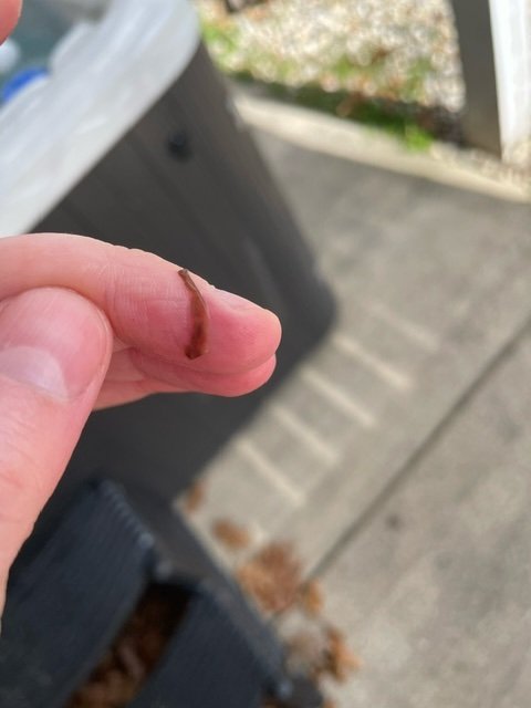

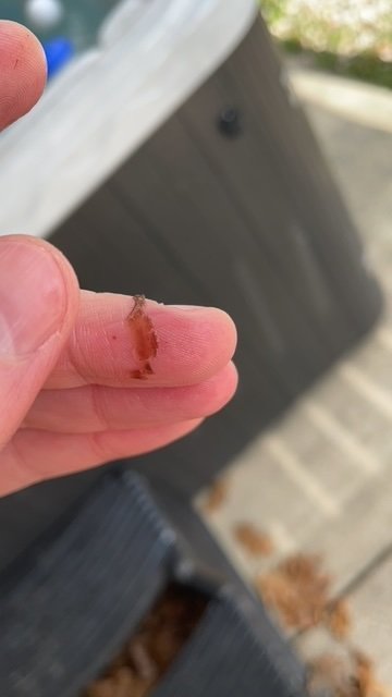

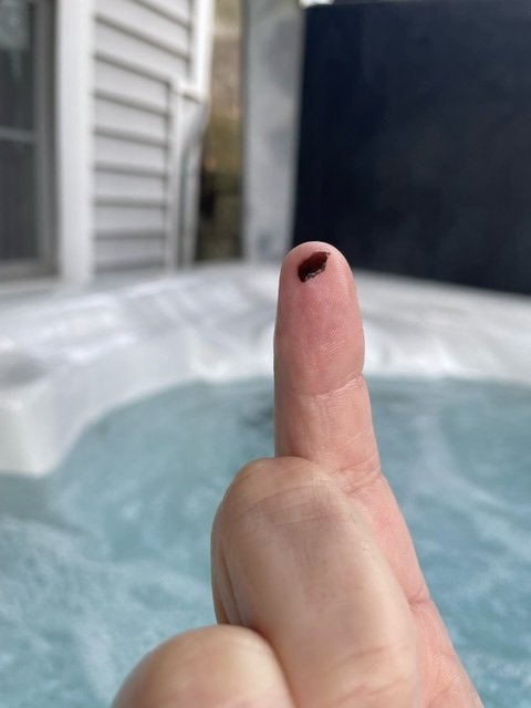

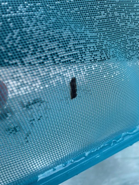

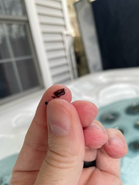

- just soaked in the spa with my daughter and there was a few flakes of varying sizes. Light brown to dark brown/black. They actually do NOT disappear when rubbed between my fingers (as I previously incorrectly described) like the previous white mold, but do shred/ball up. They seem "tougher" than the white mold biofilm I had previously. Sometimes so tough it almost seems tar-like after I rolled between my fingers, but not always.
- for completionism and accuracy of information I checked the FC and CC using my Taylor kit and the strip is indeed accurate with 5-10 ppm free chlorine (closer to 5 than 10) and zero CC. Also checked the CYA and it is between zero and 50, closer to the zero than the 30 to 50 mark.
- Also checked my phosphates for giggles and its between 50-125 so I will be using the "weekly dose" tonight when the filters kick on, but not high enough to be of real concern from my understanding (in the past my values were well into the 100s or even over 1k when I had issues).

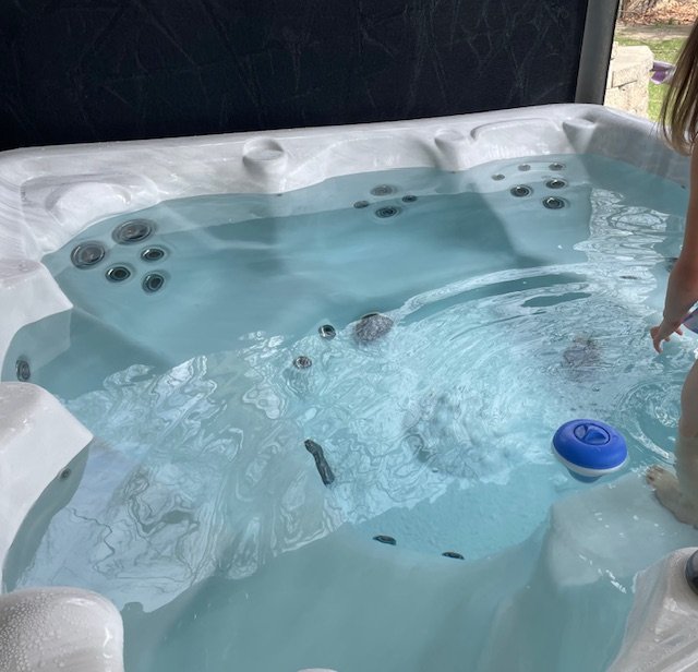

- I have attached pictures of some of the "biofilm" I'm finding today and one picture of the water to show how wonderful it looks. I also noticed that I think I see more AFTER the jets shut off and the pressure backs off and I get some bubbles from air in the line being purged. Not sure if this observation makes a difference or even if it's accurate. The other day when I made my original post, there were hundreds of these flakes ranging from very tiny to as large as you see in these pictures (sometimes a littler larger) and this was AFTER having zero (or minimal) flakes since the purge/refill.

Trichlor is way too acidic to use in a hot tub!  HOt tubs have a very small water volume compared to a pool and it is very easy for chemical parameters to change quickly! Most spa manufacturers will void the warranty if you use trichlor.
Also, trichlor adds 6 ppm CYA for every 10 ppm  FC added while dichlor adds 9 ppm CYA for ever 10 ppm FC added. Overstabilization will happen quickly. A spa should not be over 30 ppm CYA! I have a suspicion about what these flakes might be.

I suspect the black flakes are from degredation of o rings or seals because of low pH from trichlor use. IF the skimmer is near an intake very low pH water could go directly into the plumbing while the pH in the tub reads much higher.
