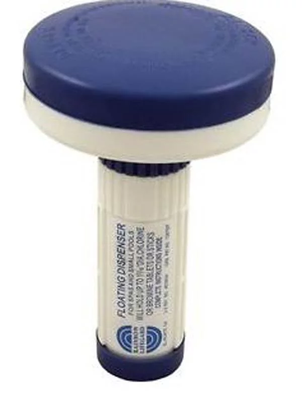

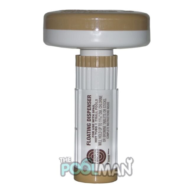

waterbear Posted September 8 Report Share Posted September 8 Don't worry, it's all good. You've gotten over a pretty steep learning curve very quickly. You now know that you can't test pH or TA when sanitizer is high and if your sanitizer reads low or nonexistent there is a chance your DPD test has bleached out and is reading low so dilute your sample with distilled water 1:1 and retest, multiply test results by 2 to get reading. (OR just get the Taylor stand alone FSD-DPD test kit. Much easier to use, no color matching. You are looking for it to go from pink to colorless as you add drops and count the drops. It will also handle a much higher sanitizer range than the DPD test and give you accurate results with NO dilutions. Once the bromine drops don't put the floater back until we get the pH, TA, and CH in line. If you could post a pic of your bromine floater it would help, Some are totally useless as far as adjustments go. I recommend the Pentair 335 floater that holds 1" bromine tablets . It looks like this and is VERY adjustable. It's often sold unter the Rainbow brand, which is one of Pentair's brands. Quote Link to comment Share on other sites More sharing options...

TraceyM Posted September 9 Author Report Share Posted September 9 Added the Borax and aerated. PH now 7.6 Yellow water is now clear too! Tested Bromine again after leaving open and aerating for some time and Bromine is down to 2. Is that normal for it to drop that much? (The Bromine floater we have looks just like the ones you posted) Quote Link to comment Share on other sites More sharing options...
