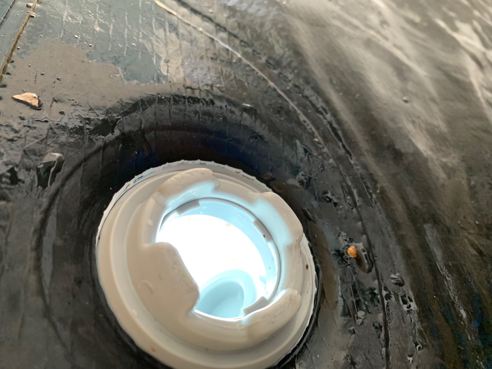

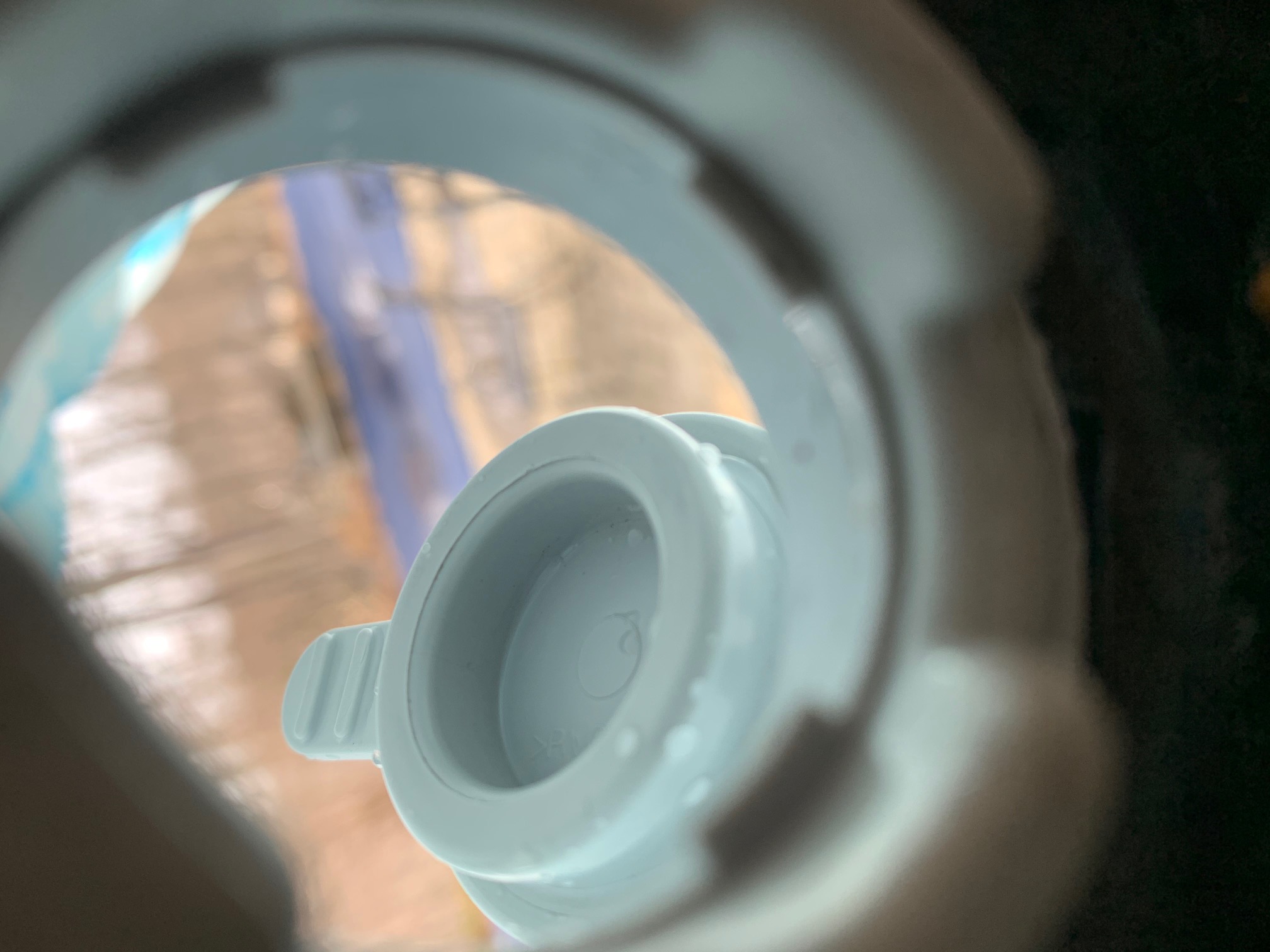

Ryanator Posted December 17, 2021 Report Share Posted December 17, 2021 On 3/23/2021 at 4:41 PM, rrsp75 said: Here's the pictures. I tried a o-ring gasket and may have "stretched" the inside of the valve as now it wont' even stay shut. Not sure it matters because it was leaking even when shut before. this is the drain valve at the bottom of the hot top. saluspa miami On 11/14/2020 at 6:11 AM, Joshtheangry said: So for as long as I've owned these I've accepted they're rentals since best way doesn't honor warranty claims or stand behind their products. I've fixed several leaks in the egg, replaced all the o rings in the heater etc. I believe my leak is now coming from the crappy new design of the drain plug. It seems something is missing in the assembly as all I have is plawtic on plastic and it doesn't form any kind of seal. Anyone with the new drain(no pipe, just a hole in the bottom) help me with identifying what should be there and any ideas how to seal it? PVC primer/cement kit. Less than $7. Place something hard and flat under the plug as the primer will be messy. Follow directions. Test with a partial fill to filters. Check for leaks. Quote Link to comment Share on other sites More sharing options...
