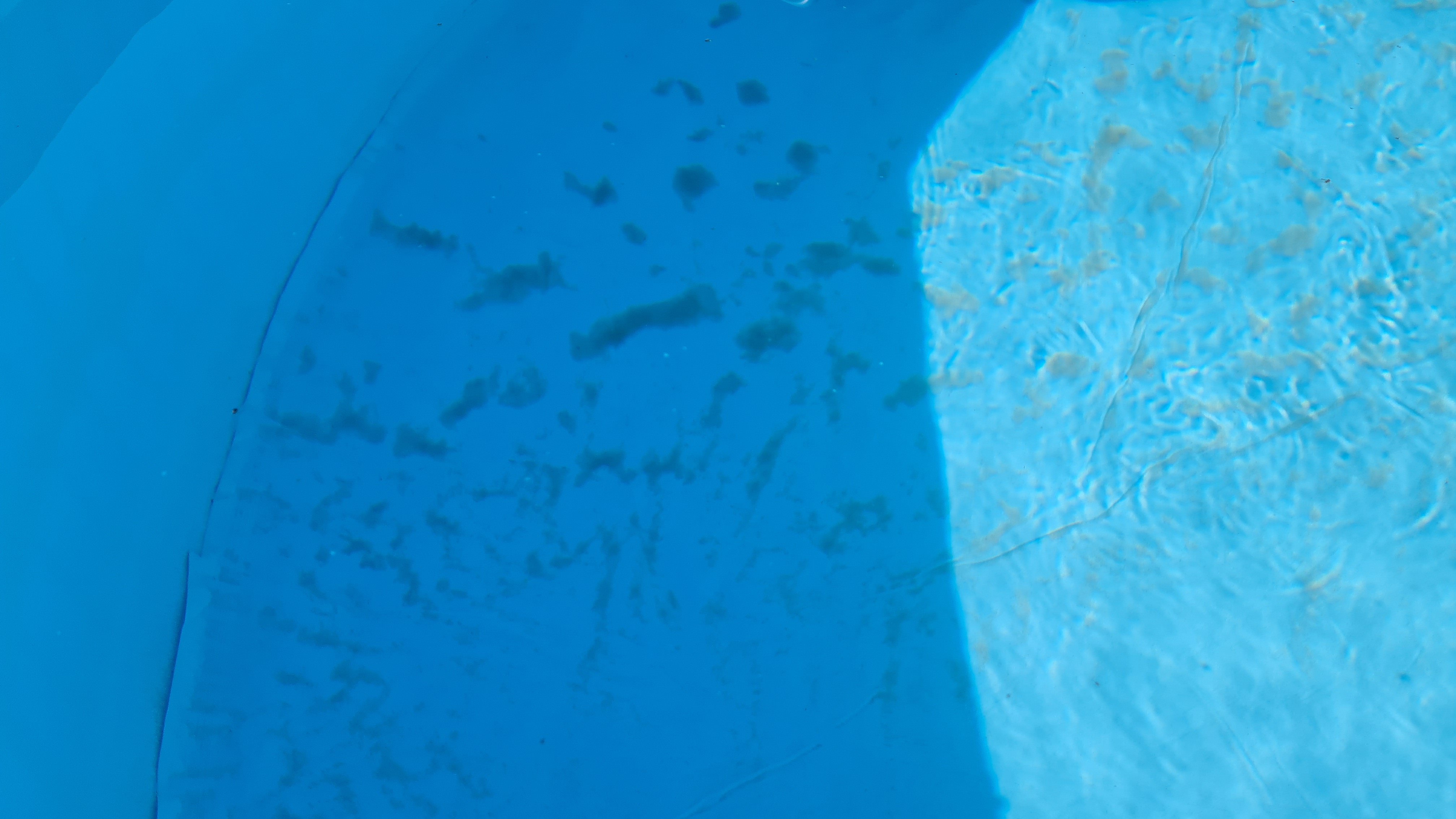

All my chemicals are excellent, water is clear and sparkling. I used a water clarifier and since then I have a brown dusty residue on the bottom of the pool that vacuums up but returns with hours. If I leave the cartridge filter off it remain clear of the residue but once the filter starts the problem returns to the pool base. What could it be and what is the solution? I have noted on the site that other pool owners have the same problem without a fix.

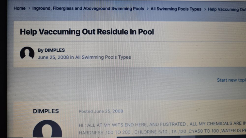

Thanks Waterbear for you your interest. The link for the problem others have had was "Help Vaccuming Out Residule in Pool" with that spelling. Above ground vinyl pool 12000 litres. Using Chlorine Hy-Clor Liquid chlorine. City water. Free chlorine 2.48, Total chlorine 2.48, PH 7.6,  Cyanuric acid 64, Total alkalinity 110, Total alkalinity Adjusted 89, Total Hardness 102, Magnesium hardness 0, Calcium hardness 102, Phosphates 0, Total copper 0.2, LSI-0.51.

My suspicion, based on your FC and CYA,  is that you have a mustard algae outbreak since it reappears after vacuuming it. Mustard Algae can appear as brown. Filters will not filter out suspended algae and I suspect it was their before you used the clarifer, making the water cloudy, which is why you probably used the clarifer in the first place. Am I correct? Clarifers will cause suspended particles to clump together.
Mustard algae requires VERY HIGH FC to kill and this is not possible in a vinyl pool. Second best option is to get a 60% polyquat algaecide (poly [oxyethylene (dimethyliminio) ethylene (dimethyliminio) ethylene dichloride] ). Iwould not recommend a quaternium or copper based algaecide, you want 60% polyquat.
The cure is to lower your CYA to 30 ppm and not let it go above 50 ppm. The only way to lower CYA is to replace water, in your case around 50%. This is best done by a series of partial water changers since lowering more than a foot at a time in a vinyl pool could cause problems with the liner. Also, once the CYA is in range DO NOT USE ANY stabilized chlorine (trichor or dichlor) since they will continue to add CYA. Trichlor will add 6 ppm CYA for every 10 ppm FC added and dichlor will add 9 ppm CYA for every 10 ppm FC added. Use only liquid chlorine (sodium hypochlorite) or Cal Hypo but be aware that cal hypo will add 7 ppm calcium harndess for every 10 ppm FC added.

The thread you are linking too describs mustard algae and confirmed that the CYA was high. Your photo looks like mustard algae but it is hard to say. Could also be pollen but it ususally floats on the surface and does vacuum out. A useful rule of thumb is that if it doesn't vacuum out and passes through the filter there is a good chance it's algae. My question is how did your CYA get so high?
