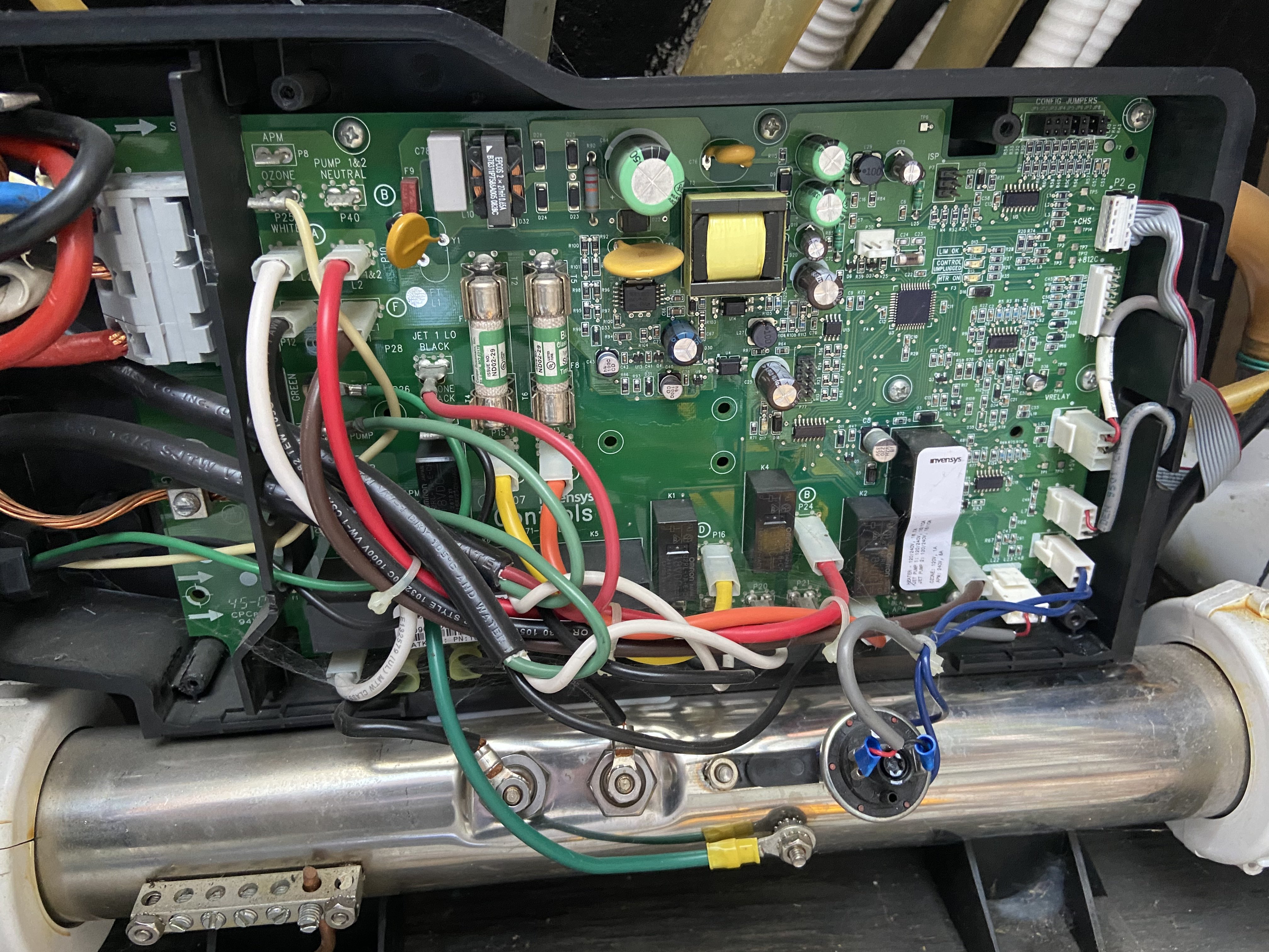

LeafNation Posted March 25 Author Report Share Posted March 25 Not really specific, he said there was something going on between the top side control and board. For troubleshooting, he connected a temp probe to the REG THERM input on the board and reset the breaker. After searching the web, I am inclined to do a few sensor tests of my own, fuses, etc. Perhaps pick up a new temp and high limit probe to start with. Quote Link to comment Share on other sites More sharing options...

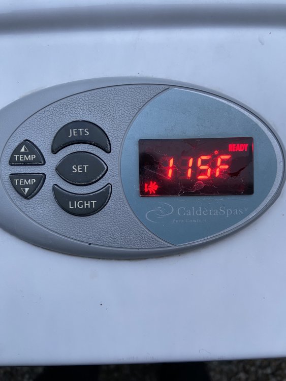

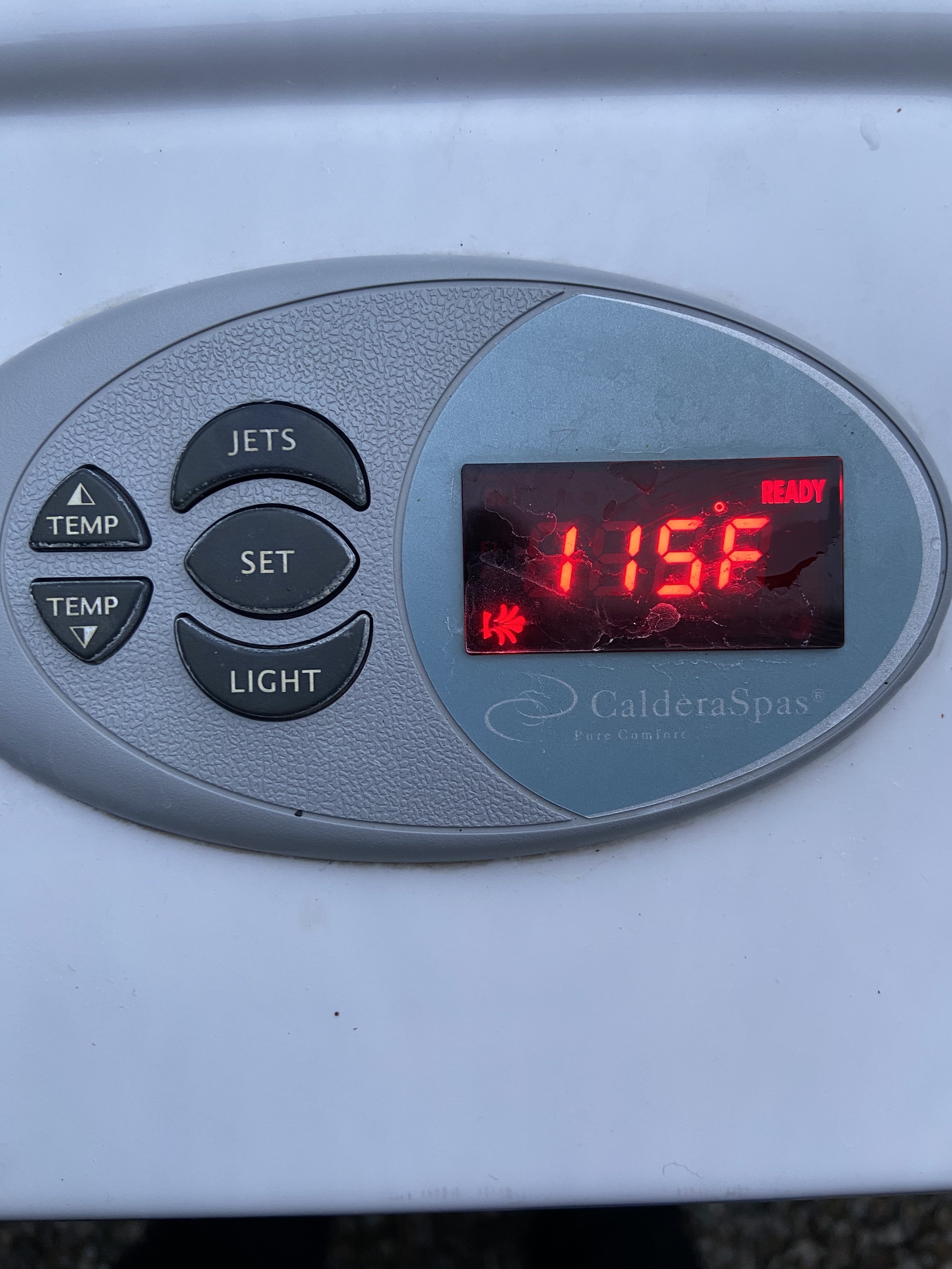

CanadianSpaTech Posted March 26 Report Share Posted March 26 Post a photo of the topside. Watkins used an outside MFG for their topsides for a few years around 2009/10 and replacement topsides are not available and to fix a bad topside you have to retrofit in a new system. Quote Link to comment Share on other sites More sharing options...
LeafNation Posted March 26 Author Report Share Posted March 26 See attached pics of both the topside and control board. thanks for your help! Quote Link to comment Share on other sites More sharing options...
CanadianSpaTech Posted March 26 Report Share Posted March 26 13 hours ago, LeafNation said: he connected a temp probe to the REG THERM input on the board and reset the breaker. and the topside still read 115 degrees? Was the water actually 115 degrees? 13 hours ago, LeafNation said: Perhaps pick up a new temp and high limit probe to start with. sounds like he already tried a new temp probe. The 4 dashes error is a high limit trip. See page 27... https://www.pioneerfamilypools.ca/wp-content/uploads/resources/hottub-info/4howto/Hot-Tub-Troubleshooting-Guide.pdf RE: topside... Are you still able to increase/decrease the temp using the topside buttons? Can you still on/off pumps? Lights? The topsides from this era that I have seen go bad requiring a complete retrofit usually the display shows 2 lines of 4 dashes and nothing works. If at some point you do have to replace the pack and topside I would go with a new Balboa system over a Watkins/Caldera unit. Where are you located? 1 Quote Link to comment Share on other sites More sharing options...
LeafNation Posted March 26 Author Report Share Posted March 26 44 minutes ago, CanadianSpaTech said: 15 hours ago, LeafNation said: he connected a temp probe to the REG THERM input on the board and reset the breaker. and the topside still read 115 degrees? Was the water actually 115 degrees Yes it still reads 115, water was never that not. 45 minutes ago, CanadianSpaTech said: RE: topside... Are you still able to increase/decrease the temp using the topside buttons? Can you still on/off pumps? Lights? Yes, all of those functions still work. When I reset the breaker, the LED reads 100 and a few seconds later it jumps to 115. The tech put a probe in the REG THERM input but did not touch the LIMIT THERM input. If it's a high limit trip, does it make sense to replace the high limit probe or a fuse on the board? thanks for sharing the manual and I am in the Ottawa area. Quote Link to comment Share on other sites More sharing options...
