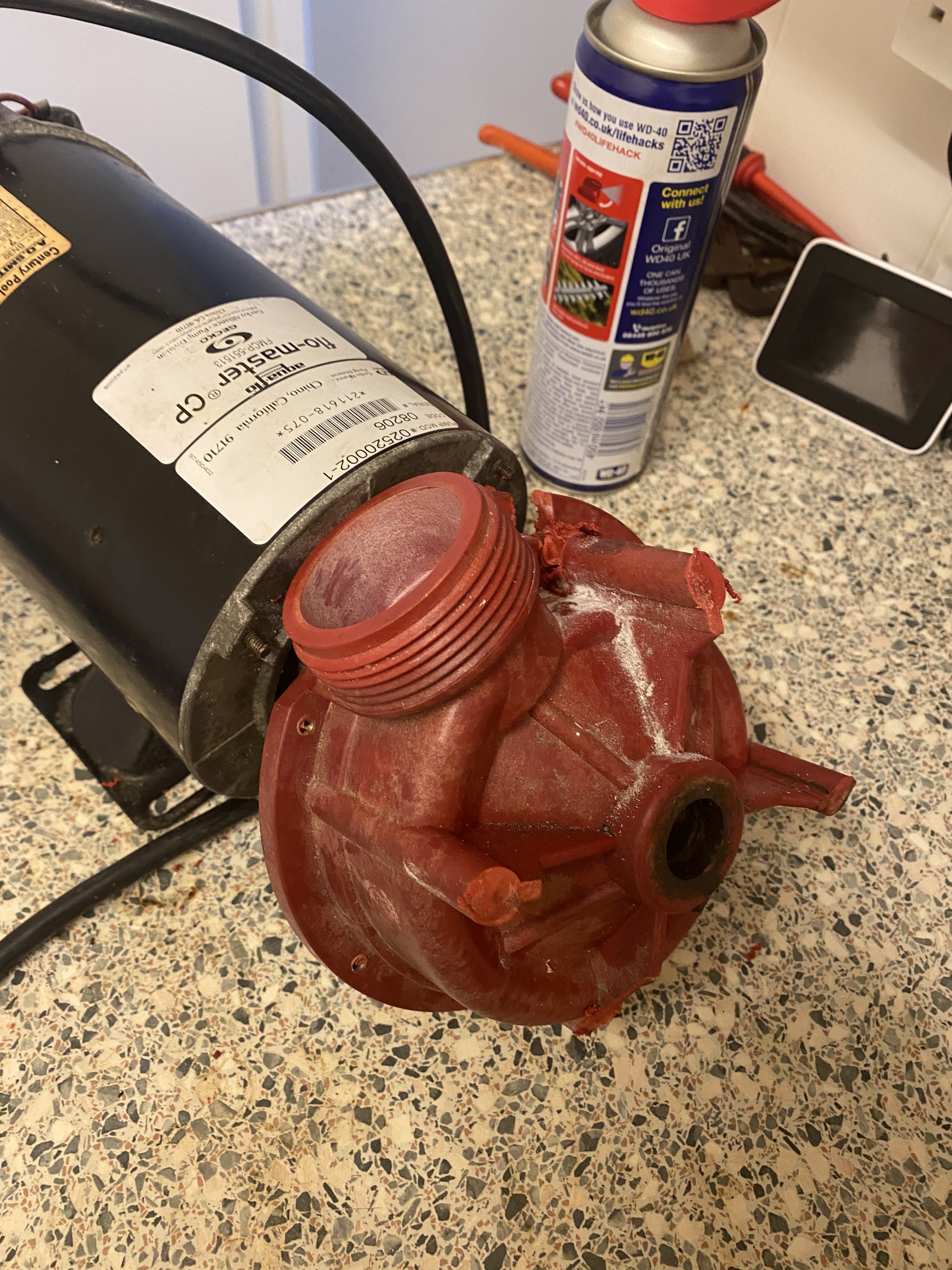

Alan james newman Posted December 6, 2020 Report Share Posted December 6, 2020 I’ve bought a dream master eclipse spa but will only heat to 36 degrees, outside temp is 6 degrees,is there any thing to improve this?? Quote Link to comment Share on other sites More sharing options...
RDspaguy Posted December 6, 2020 Report Share Posted December 6, 2020 Did you mean "dream maker"? I can't find anything on "dream master". I am not familiar with the brand in either case. What voltage and amp rating is the breaker? Is it new? Was it wired by the dealer? Can you post a pic of the controls (topside and circuit board) and wiring diagram? Quote Link to comment Share on other sites More sharing options...
Alan james newman Posted December 6, 2020 Author Report Share Posted December 6, 2020 Sorry yes dream maker,I connected to the spa as I’m electrician so hopefully nothing wrong ther IMG_0973.MOV e Quote Link to comment Share on other sites More sharing options...
CanadianSpaTech Posted December 6, 2020 Report Share Posted December 6, 2020 2 hours ago, Alan james newman said: will only heat to 36 degrees Pull your filters until the issue is fixed. Take them out of the equation... New, old or just cleaned take them out and see if it heats up better. I guessing it's a 110VAC spa and there is no heater in the spa and uses pump friction to heat the water? They can really have a hard time keeping up in the colder weather if it is. 1 Quote Link to comment Share on other sites More sharing options...
RDspaguy Posted December 6, 2020 Report Share Posted December 6, 2020 Well, your second image is unavailable. I was asking because many spas have jumper pins that effect how the spa works depending on available voltage and amps. It sounds like @CanadianSpaTechis familiar with these. 1 Quote Link to comment Share on other sites More sharing options...
Alan james newman Posted December 6, 2020 Author Report Share Posted December 6, 2020 Yes it uses a heat stick on the discharge side of the pump,I’ll try without filter, thanks Quote Link to comment Share on other sites More sharing options...
