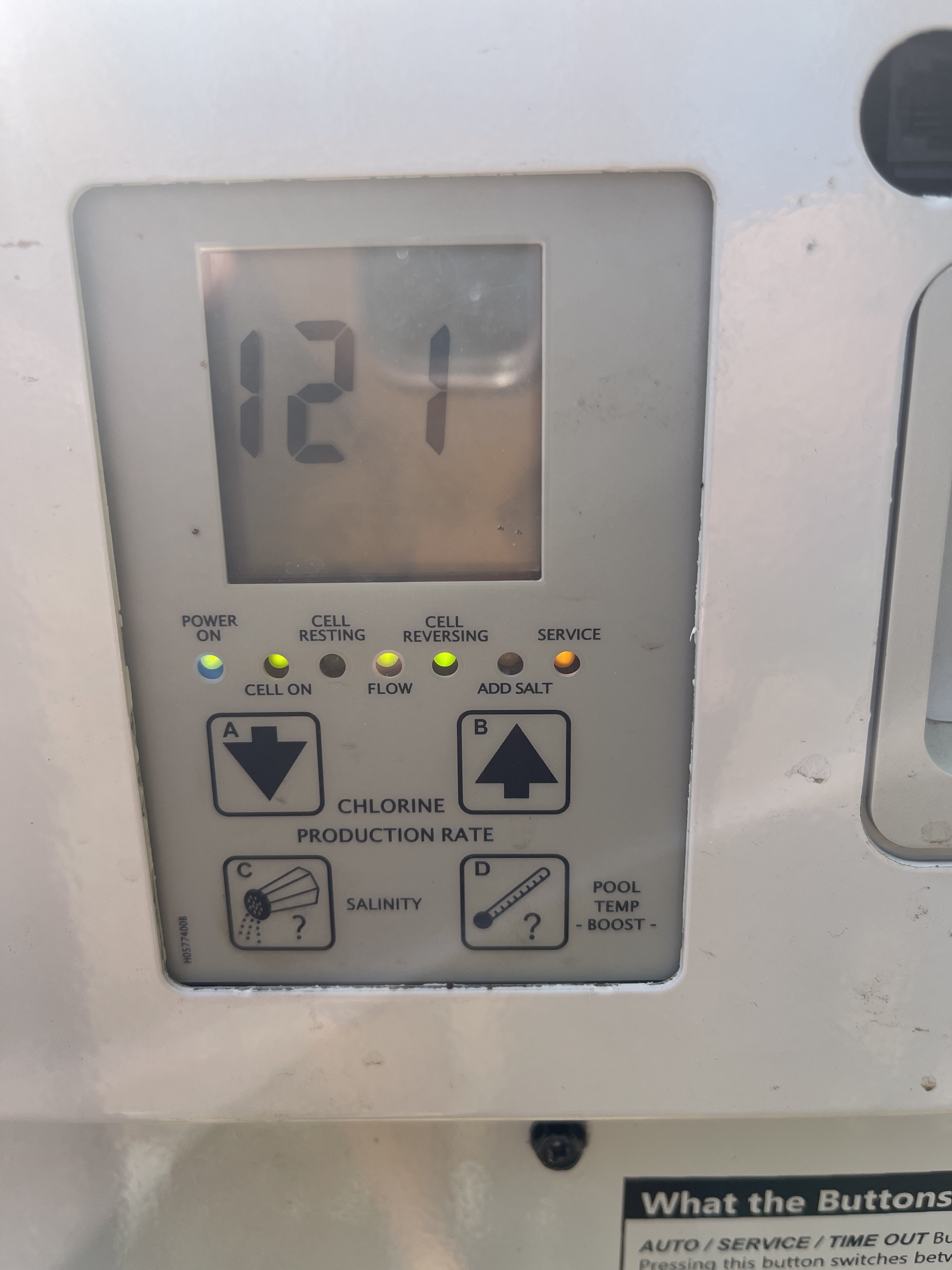

Weird things happening with my Jandy PLC1400 salt generator, that is almost 2 yrs old.  Sometimes my aqualink shows “general fault” other times it shows that it’s working well.  On my pool panel I’ve seen intermittent error code 121 as well.   This afternoon it showed that there was no AquaPure found at all on my web page for Aqualink.    Then it just reappeared.  Not sure if this is related or not, but my salt level on AquaPure readout shows 2900, when I test it with a Taylor K-1766 Sodium Chloride salt Test it matches exactly with the AquaPure.  When I take samples to two separate pool stores, they say my salt levels are down around 2000/2200 range.  I’ve had to choose to trust the Taylor Salt Test and my AquaPure.  My chlorine output is set at 70% and I have about 1.0 Chlorine when performing a Taylor drop which matches with the pool stores.  I last shocked the pool 3 days ago.   Two days ago I cleaned the salt cell with mix of 25% muriatic acid/75% water- there were no bubbles - before cleaning it looked almost spotless except for some tiny calcium build up in a corner.   Any ideas what might be going on here?  Thank you.
This is low current in the reverse direction, it can mean cell failure, a dirty cell, or low salt.

Correction; before leaving for the pool store, I checked the AquaPure once more and general fault 121 coming up again.  Ugh!!!
thinking I should try adding more salt to rule out low salt as culprit?
