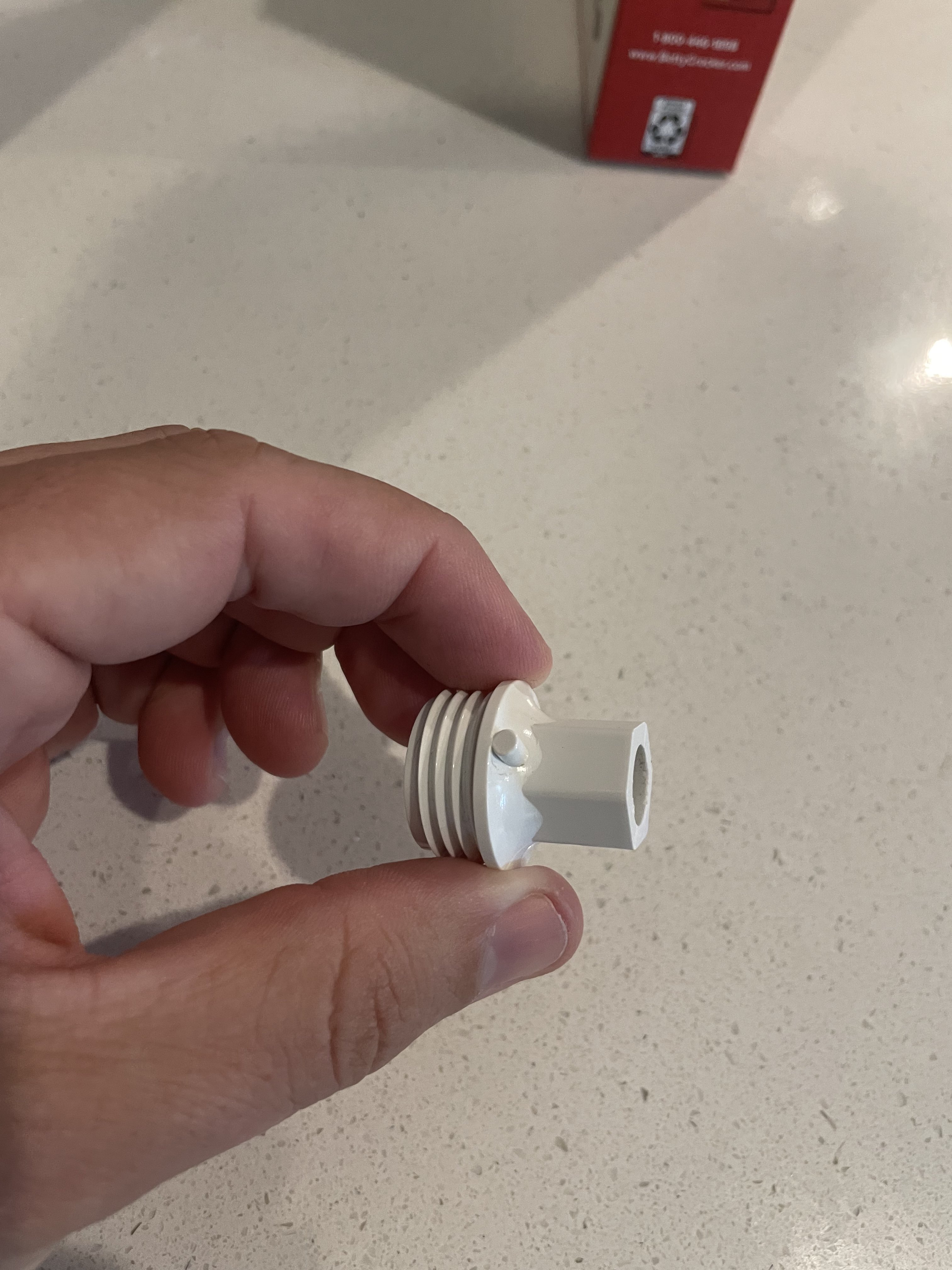

BlkFlagK9 Posted February 25 Report Share Posted February 25 Hello all, I know this is the portable section for spas, but I have an in ground attached to the pool. A few days ago I found a small plastic piece on the floor of my spa. Since then the jets, all but one, have been blowing low pressure. Can anyone tell me if this piece is the culprit? I appreciate any help, we just had the pool/spa built in November 2022. Quote Link to comment Share on other sites More sharing options...
Cusser Posted February 25 Report Share Posted February 25 To me: looks like a plug that just unscrewed. Look for open threaded "hole" that it fits, likely in the spa walls itself or you'd have water gushing out externally??? Quote Link to comment Share on other sites More sharing options...
Jay G Posted February 27 Report Share Posted February 27 That's a jet nozzle. Screw it back into the jet with the high flow. It probably worked itself out or wasn't ever screwed in tight to begin with. Not a big deal. Quote Link to comment Share on other sites More sharing options...
