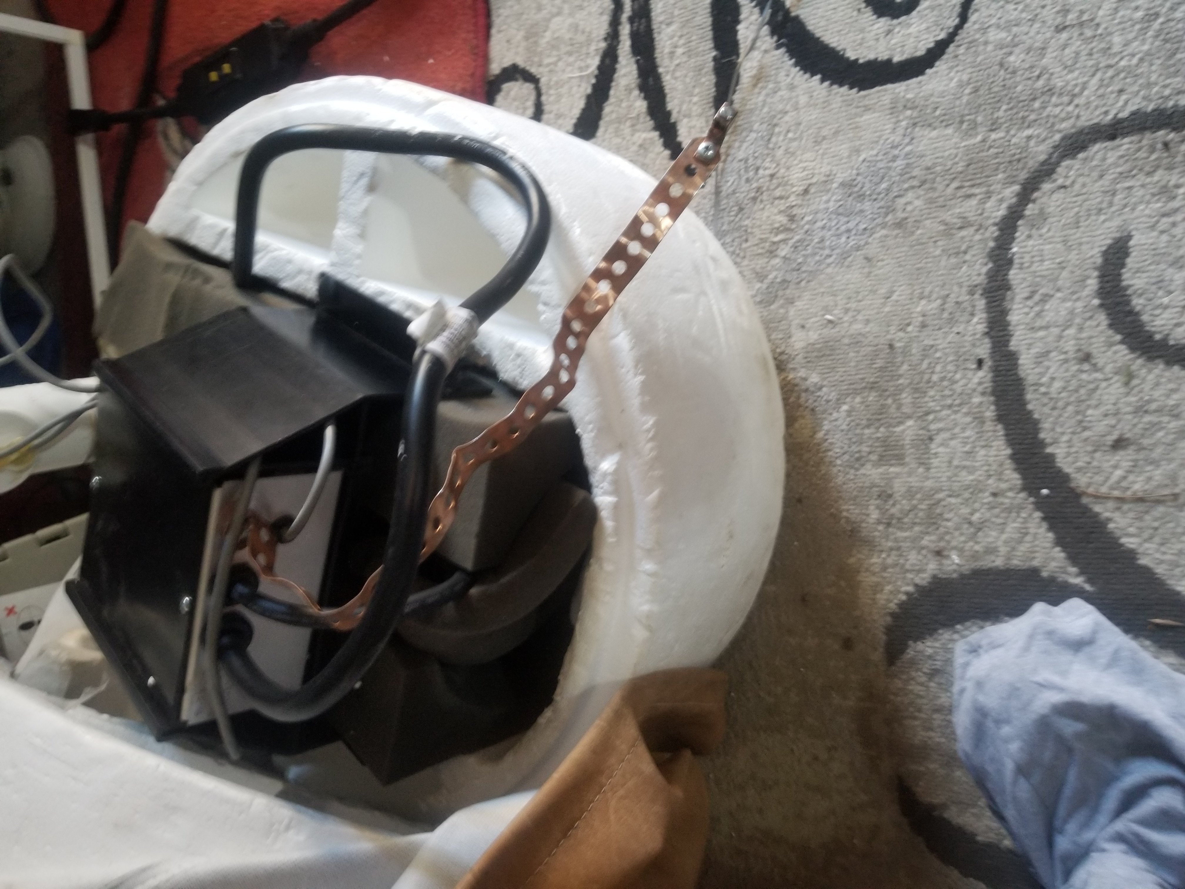

TammyMae5280 Posted July 9, 2022 Report Share Posted July 9, 2022 Can anyone tell me what I need to do with the copper metal strip? I dont even know if any of this is put back together correctly. Help!!! Quote Link to comment Share on other sites More sharing options...
Yuri Posted July 11, 2022 Report Share Posted July 11, 2022 On 7/9/2022 at 7:51 PM, TammyMae5280 said: Can anyone tell me what I need to do with the copper metal strip? I dont even know if any of this is put back together correctly. Help!!! Looks like someone added a ground strap to the controller aluminum case? Not original equipment (obviously). Not sure why - pehaps they were using an ungrounded AC outlet and wanted to add a ground wire? Quote Link to comment Share on other sites More sharing options...

Mike 133 Posted August 2, 2022 Report Share Posted August 2, 2022 On 7/9/2022 at 4:51 PM, TammyMae5280 said: Can anyone tell me what I need to do with the copper metal strip? I dont even know if any of this is put back together correctly. Mine is the same way and has run for years without being run to anything. Quote Link to comment Share on other sites More sharing options...
