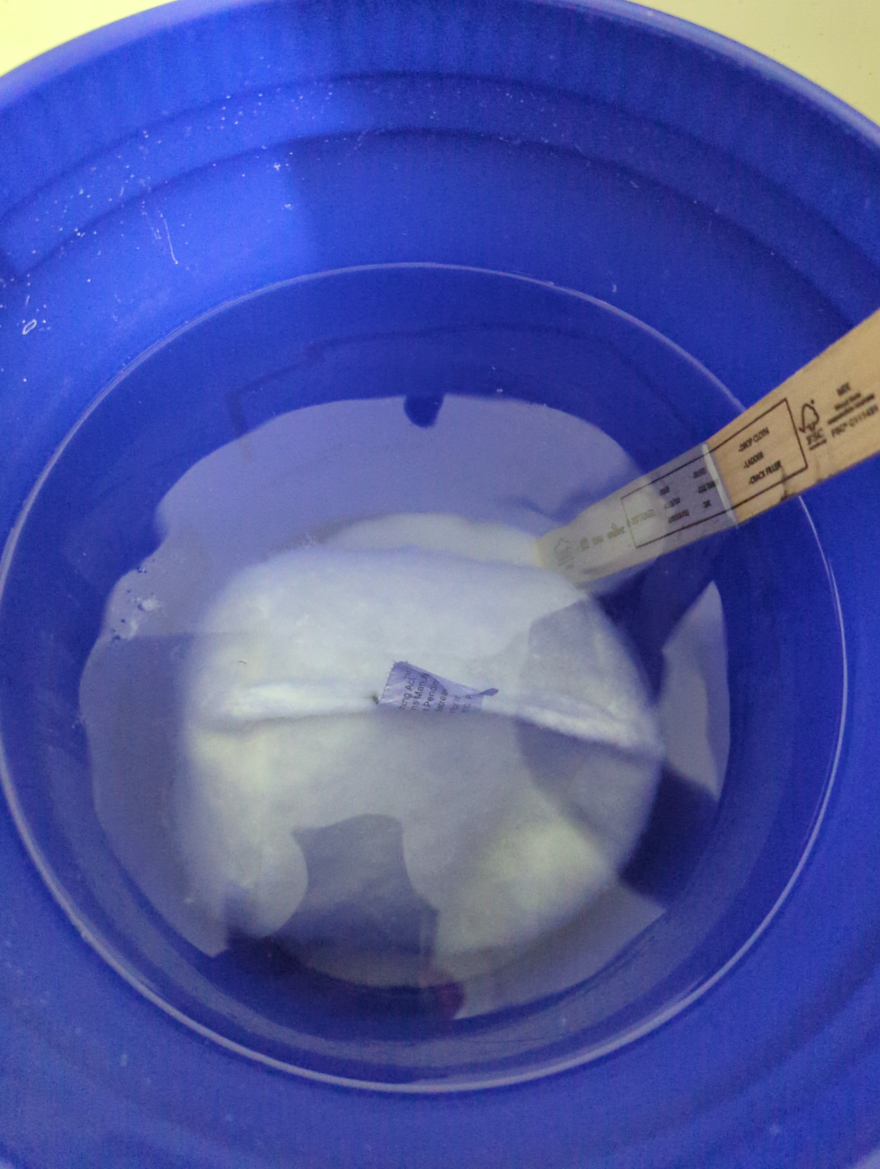

moishe 0 Posted July 29, 2012 Author Report Share Posted July 29, 2012 Zeolith A is so cheap since it's so widely used as a water softener in washing machine detergents. If I understand correctly, for this application it inclucedes natrium ions which are exchanged for the calcium ions, so it seems to be set up to work just like a resin with the main difference being that resins are usually regenerated for multiple use and this stuff is usually used only once. So I've obtained some from a source for diy modular detergent components and I'm almost ready with my filtering setup, so I'll be able to report in a couple of days. Quote Link to post Share on other sites

moishe 0 Posted July 17, 2013 Author Report Share Posted July 17, 2013 Ok, zeolite was an interesting idea, but it's not practical for this application. It comes almost in powder form and the sieves that are available at acceptable prices are just not fine enough to contain it. Bottom line: You can't filter water though zeolith without bringing at least some of the zeolith into the water and therefore the pool. Thankfully the stuff sticks together and deposits at the water line, so I was able to get it out within a week or so and didn't have to change the water. In its normal use in washing detergents this is irrelevant as it is drained together with the water it softens. Quote Link to post Share on other sites
