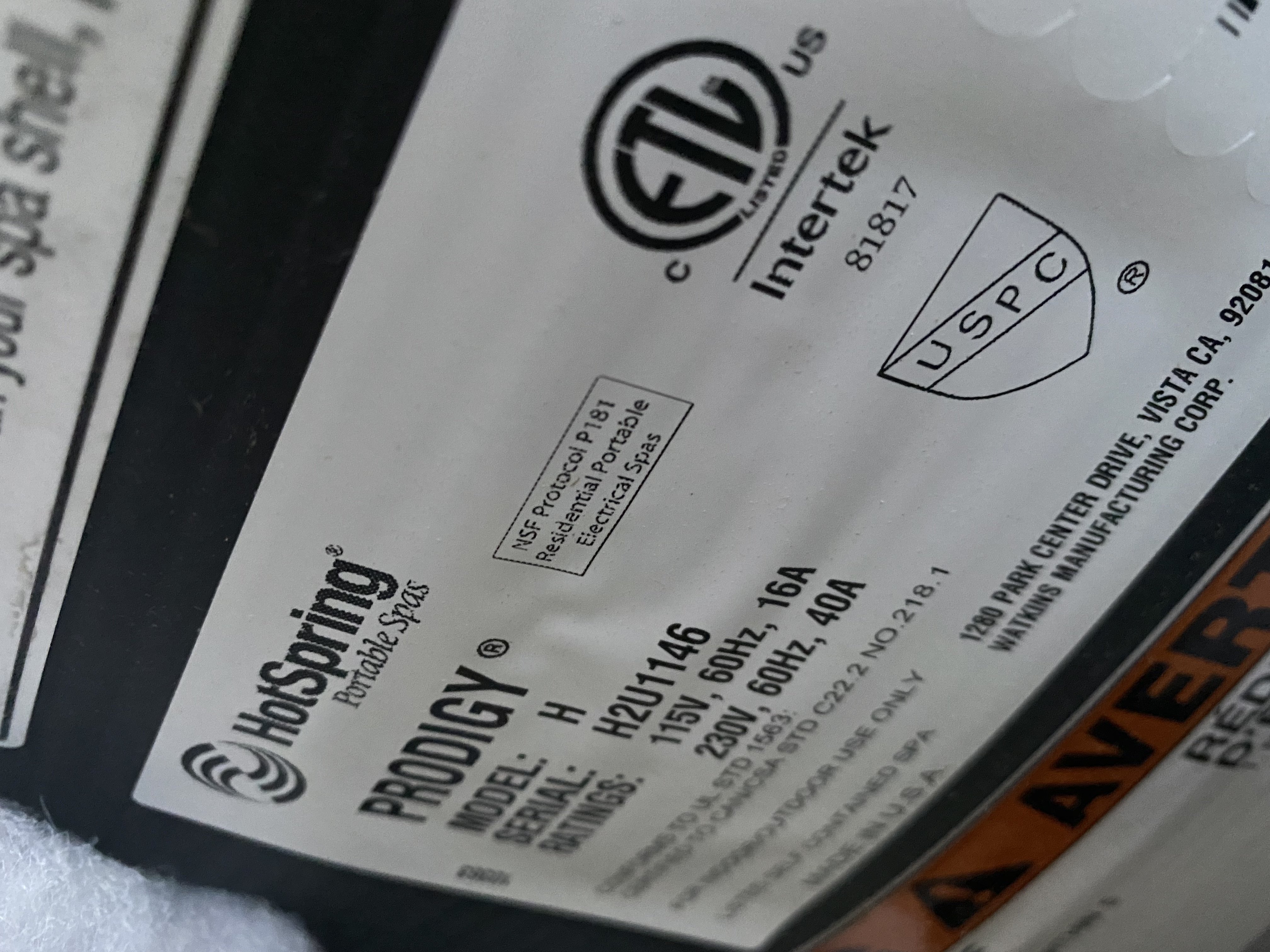

  1. We have a 2016 (I think) Hotsprings Prodigy I turned the breakers off to do the normal water change, drained the tub, put new filters in and filled it back up. When I hit the breakers again to turn it back on the hot tub had absolutely no power. No breakers popped and there is power coming from the house to the hot tub. We tried replacing the heater control board and checked the fuse which was fine and the hot tub will still not power on. Any ideas???
