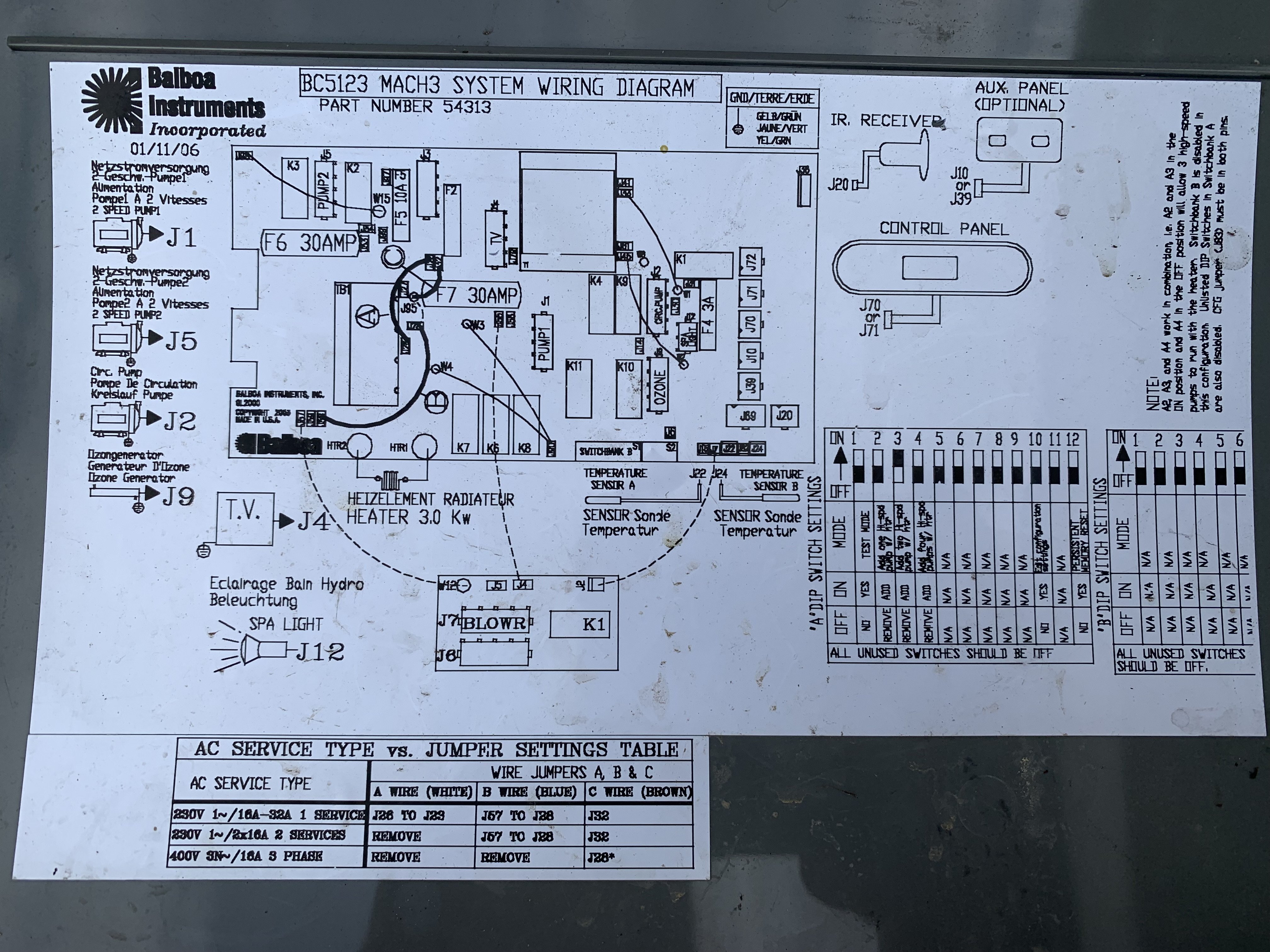

I have replaced pump 2 in my beachcomber hot tub (Balboa control pack). It is a functioning two speed pump, yet it won’t switch on in low speed.
I have swapped pump 1 and 2 over and both work at both speeds where pump 1 plugs in, but neither work at low speed where pump 2 plugs in. I can hear the relay click when pressing the control panel once but the pump does not come on, pressing it for a second time switches it on at high speed. I’ve also changed the circuit board in case it was anything there (had a working spare) but the issue remains.
Any ideas how to sort this?
