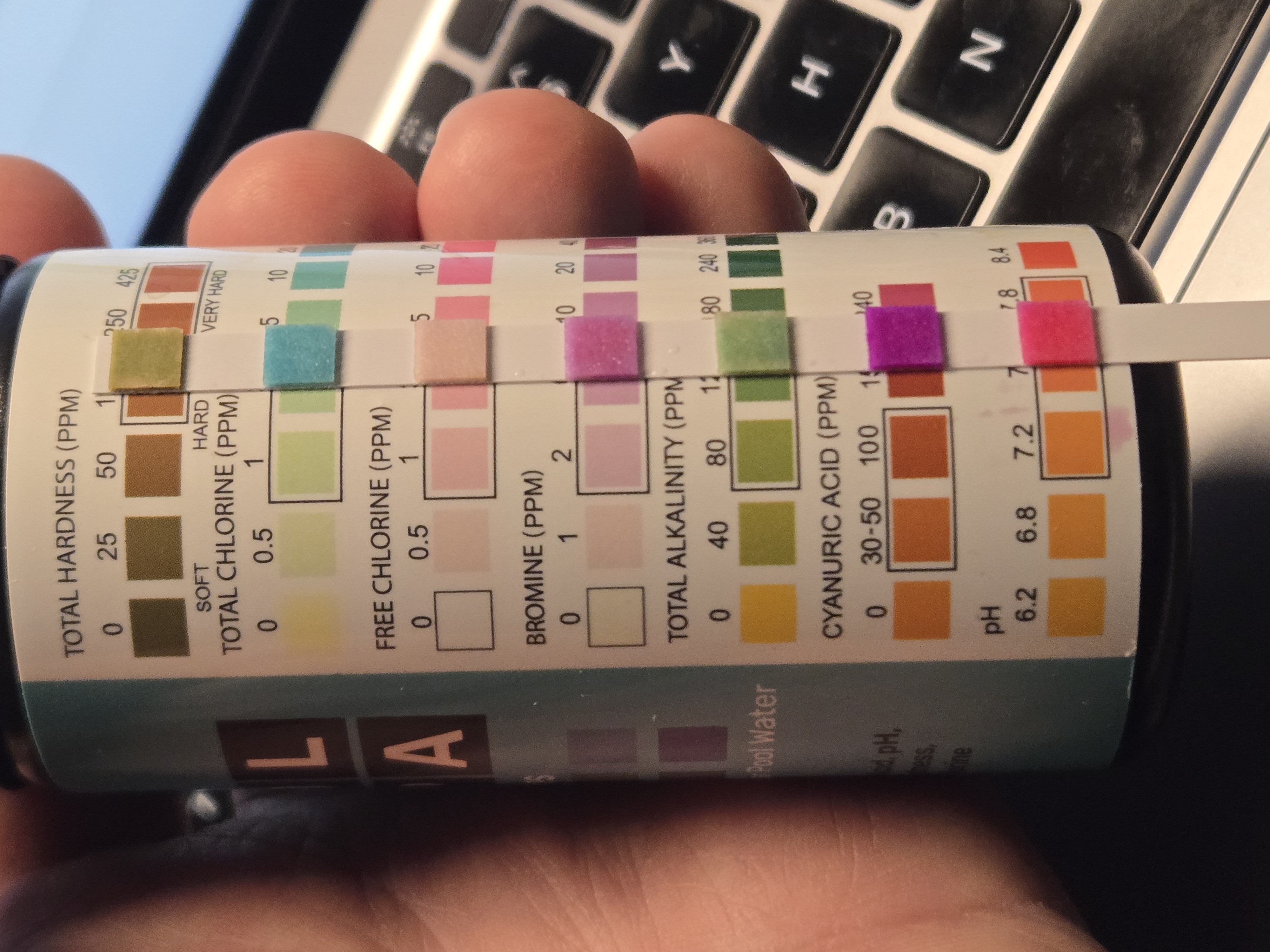

So the problem is for the last couple of weeks the TA and pH were super high.  I've read a couple posts on here and realized I need to bring the pH down with Muriatic Acid which I bought last night at hardware store.  PoolCalculator.com told me to add .6oz of acid, (which i did VERY carefully, started with a clear solo cup which i filled half way with spa water first then while on the zero'd out scale added .6oz, then poured that, very carefully, into a 5 gallon bucket which was half full of spa water, then and only then did i add to center of spa, being careful not to splash.
I have done this about 6 times now in the past 24 hours, with the last two I used about 2 oz of acid, since it wasn't really changing things.
Each time I ad Muriatic acid, I wait about 5 minutes then run the spa for about 15 minutes.  Then I recheck with JNW test strips, (off amazon), within about an hour
Here are my numbers now;
Total Chlorine 20 (high)
Free Chlorine 4
Bromine 40 (high)
TA 90
Cyanuric Acid 240+ (color is off the chart)
PH 8.6++. (color is off the chart)
I just ran these numbers above on poolcalculator.com on my laptop for the first time, (all previous times I use my phone), and it says to drain and replace 79% of the water under the Cyanuric acid section.

First, strips are useless for water balancing. they do not have either the precision to balance water. For example TA should be balance withing a +/- 10 ppm range and the best strips are capable of are +/- 40 ppm. Also, while strips are precise (they will give the same results when doing repeated tests on the same sample) they are not accurate (that the test result obtained is a accurate measurement of the actual value of the water parameter being tested. I would strongly recommend investing in a Taylor Technologies  K-2006 test kit which uses the FAS-DPD test method for chlorine and also tests pH with acid and base demand to calculate how much acid or alkali is needed for a specific pH change in YOUR water at the time of the test, which no calculator can do. It also tests cyanuric acid, TA, and calcium hardness. Strips only test total hardness (calcium and magnesium hardness) which is useless for water balancing.  Do not get the K-2005 which uses DPD testing and suffers from bleachout, as the FC test in your strip bleached out. Your FC is MUCH higher than 4 ppm. The Total chlorine and the bromine tests on your strip do not use DPD testing and give a more accurate representation of your chlorine level. I will explain a bit further on.

Your FC is 4 and by the color of the color block this is a DPD test. DPD bleaches out at high chlorine levels and I would guess your FC is in the neighborhood of 20 ppm since your TC is reading 20 and your bromine is 40. Bromine readings are double the total  chlorine reading (actually 2.25 higher but most test kits just double the scale)  The Total chlorine test and the Bromine test are using a different reagent that does not bleach out but can only give a Total chlorine or Total Bromine reading. With chlorine spas we are interested in FC (good chlorine) and we test total chlorine to see if there is any combined (bad) chlorine, CC, that does not sanitize but causes eye irritation and gives off a strong "chlorine" smell. If the CC is .5 ppm or higher the spa need to be shocked to destroy the CC. With bromine we test total bromine because, unlike chlorine, combined bromine IS an effective sanitizer. The chemistry of bromine is different than the chemistry of chlorine. Also, you either have chlorine or bromine, not both, so in your case ignore the bromine scale on your test strip. If you were using bromine you would ignore the FC, TC, and CYA scales on the strip (CYA does not stabilize bromine and is not used in bromine tubs).

The FC test on your strips bleached out and gave a false low reading but the TC and Bromine tests told the truth. Your sanitizer level was much too high to try and test pH. The FAS-DPD test in the K-2006 does not suffer from bleachout like DPD testing does.
By adding all the acid you added you ran the risk of causing permanent damage to your spa. It is a good thing you drained the spa and refilled it.
As far as your CYA and TA reading go, once again the high chlorine level probably had an impact on their accuracy but the CYA test on strips is not known to very precice, it's more of an 'in the ballpark' reading but for a spa you want to keep the CYA in the 20 to 30 ppm range. I suggest you read about the Dichlor/bleach method for chlorine which uses dichlor to get the CYA into target range and then you switch to sodium hypochlorite (liquid pool chlorine/shock or chlorine laundry bleach--same thing except for the strength) to chlorinate after every soak and to shock with when CC is .5 to 1 ppm or greater. It is often hard to achieve a CC of 0 ppm in a spa because of the bather to water ratio. If you have persistent CC greater than 1 ppm there are other measures you can take to lower it.
