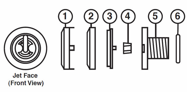

Has anybody had experience replacing this type of jet in an early 2000's Jacuzzi/Sundance? I was just going to try gluing on the locking tab but it looks like the base part (#5) actually unscrews from the body of the tub (?) or the pipe leading up to it. Am I in for the fight of my life if I try to undo it or is it possible? Thanks.

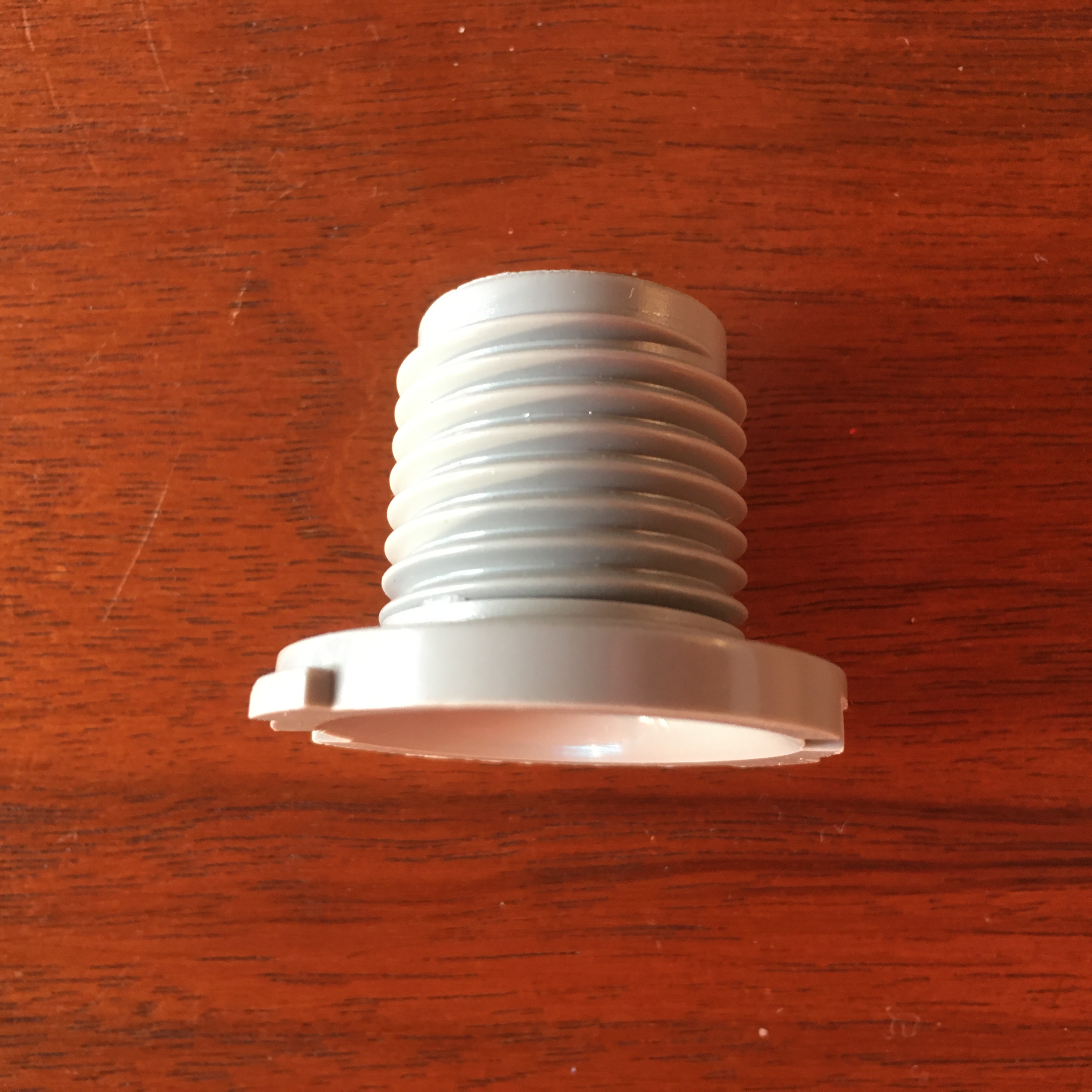

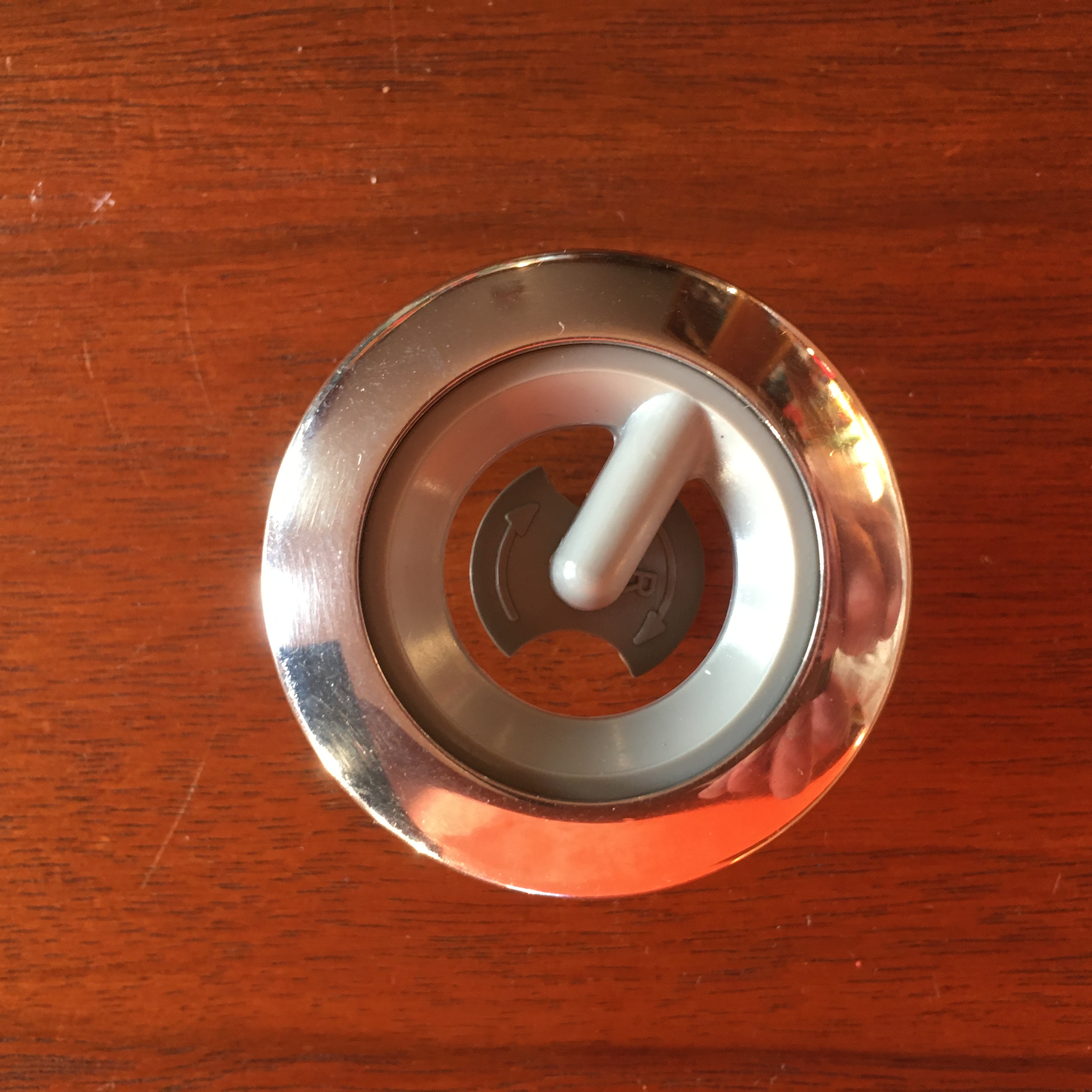

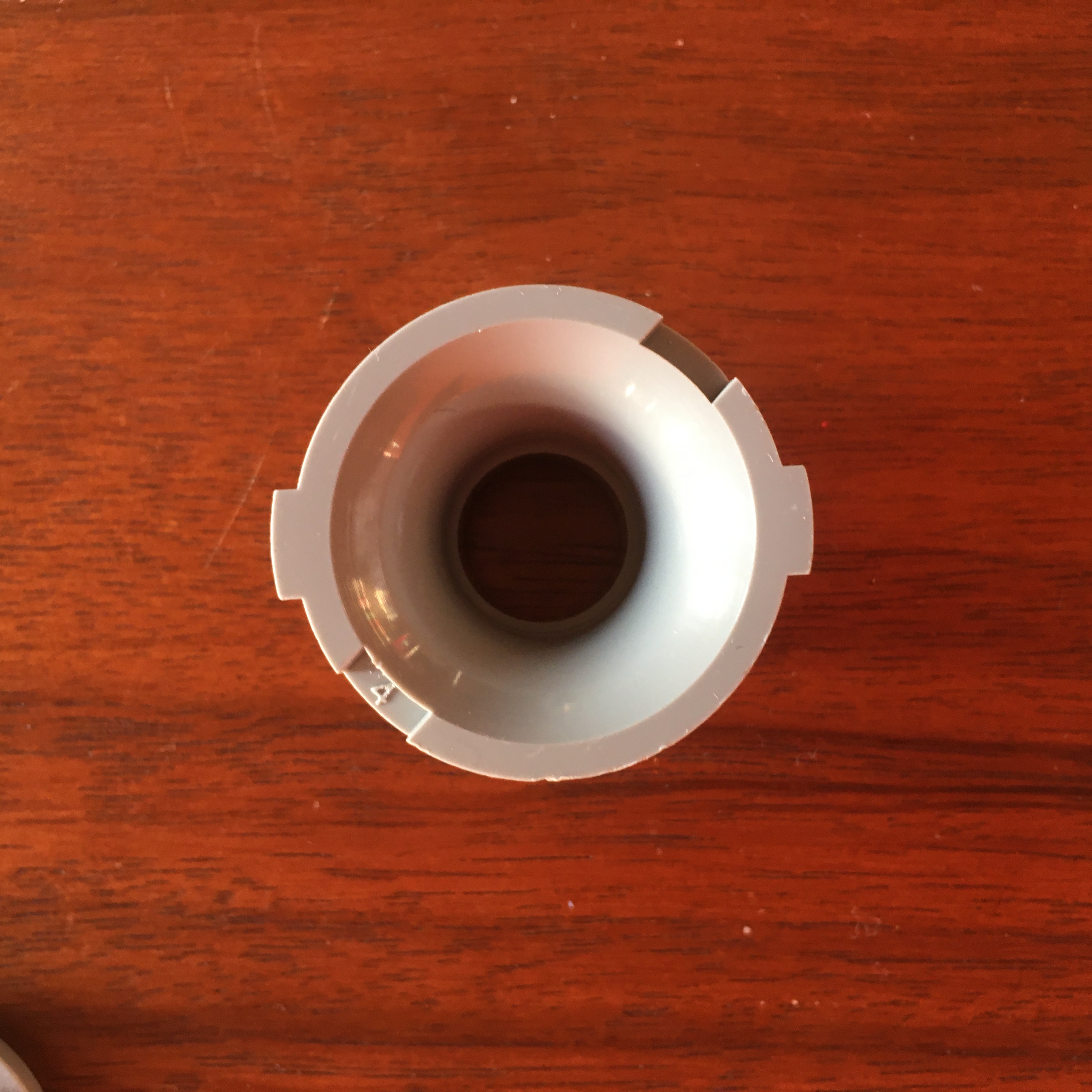

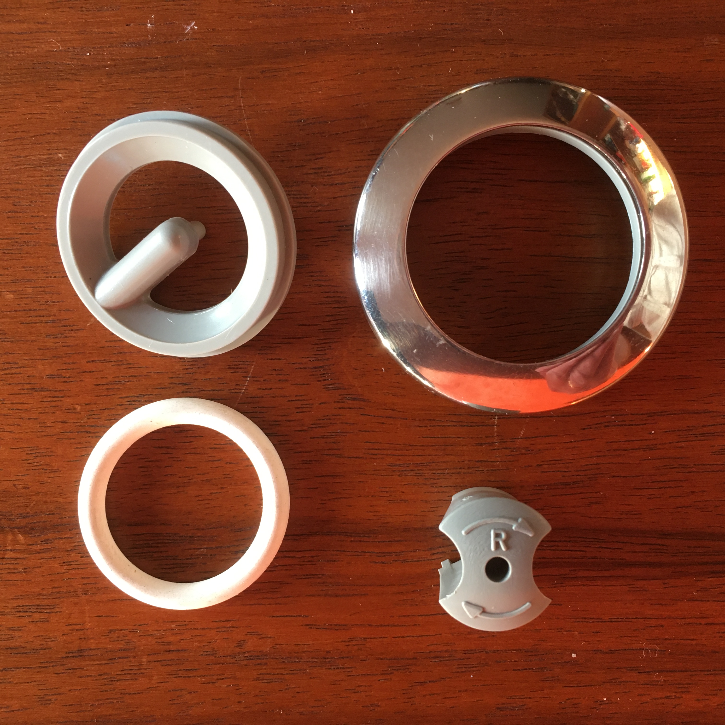

This jet unscrewed with very little effort using a somewhat heavy duty needle nose pliers.  Here is a picture of the hole in the tub after the jet was removed and the jet as removed.  As you can see there is some silicone on the threads so I will add some to the new jet when I install it.
