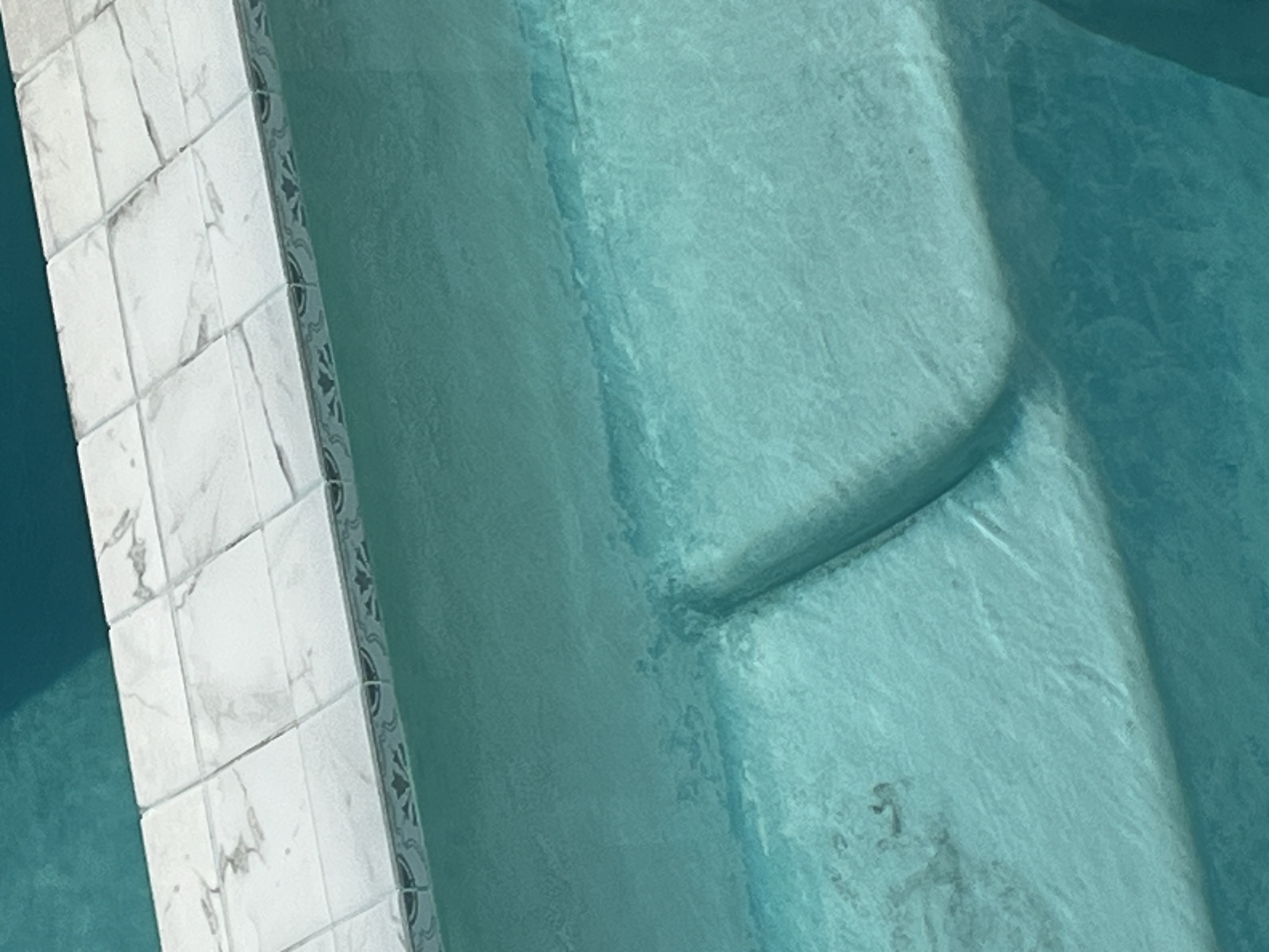

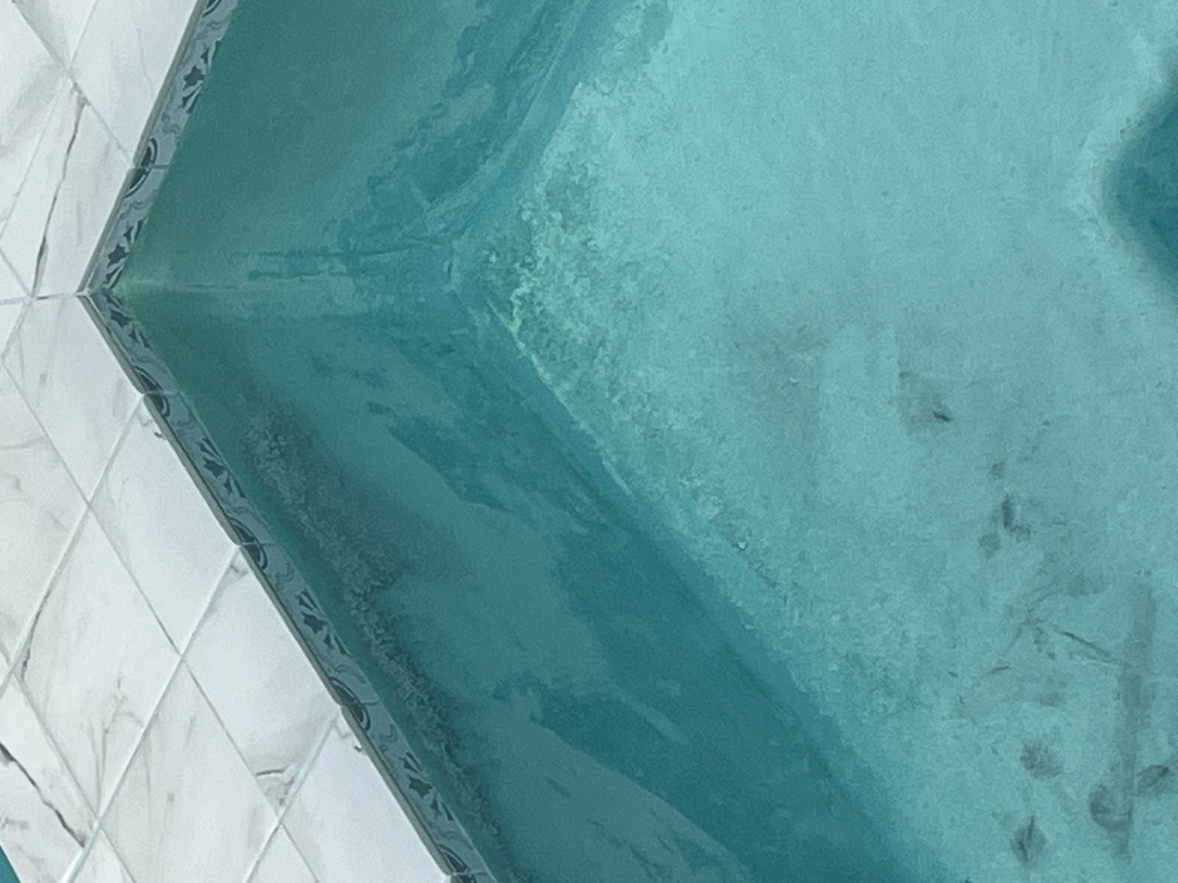

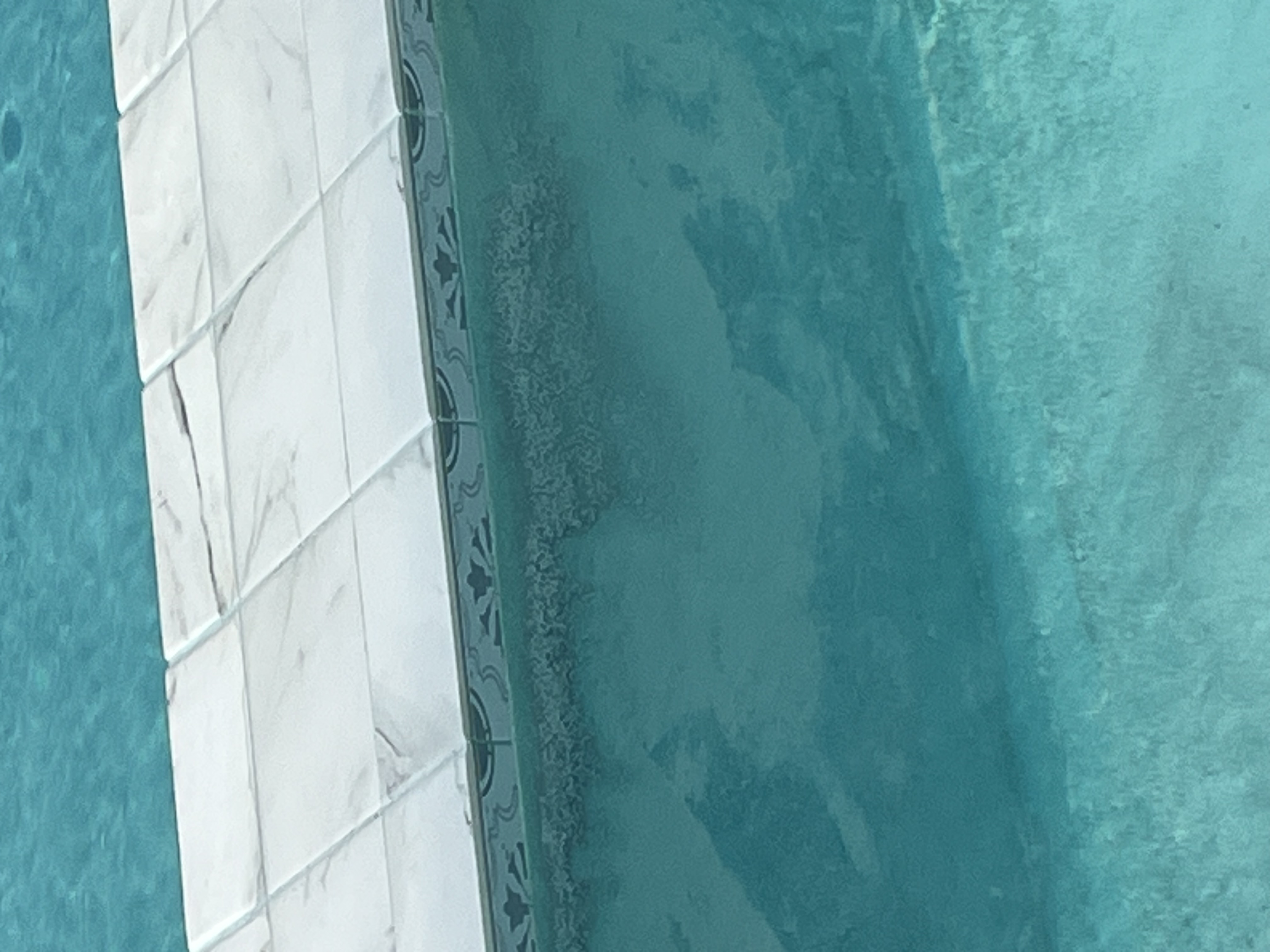

Hi everyone! Hoping to be pointed in the right direction. 1 year old pool/spa with Intellichor Saltwater Generator. Can’t keep the PH below 8.0. Even pool person is totally lost. They don’t put liquid chlorine only acid(it was my understanding since the generator produces the chlorine not to add extra liquid on top). Chlorine PPM reads at 3500-3750. This is causing absolute havoc on my plaster especially in the spa. Anyone seen this before?

Thanks for the response Waterbear! Oh wow lol. Yes you’re right that’s the salt level not chlorine. Here’s the readings my pool person gave today. Granted I have no clue what method they use to obtain the readings:

This is a year old pool so the plaster is not fully cured and it looks like there are calcium deposits on the finish. A new pool requires a LOT of acid until the plaster is fully cured and this can take up to two years. The calcium hardness test is important because if you fill water is very hard this will promote scaling.

Good test results are the basis of proper water balancing and based on what you have said and the pictures you posted you have water balance issues.
