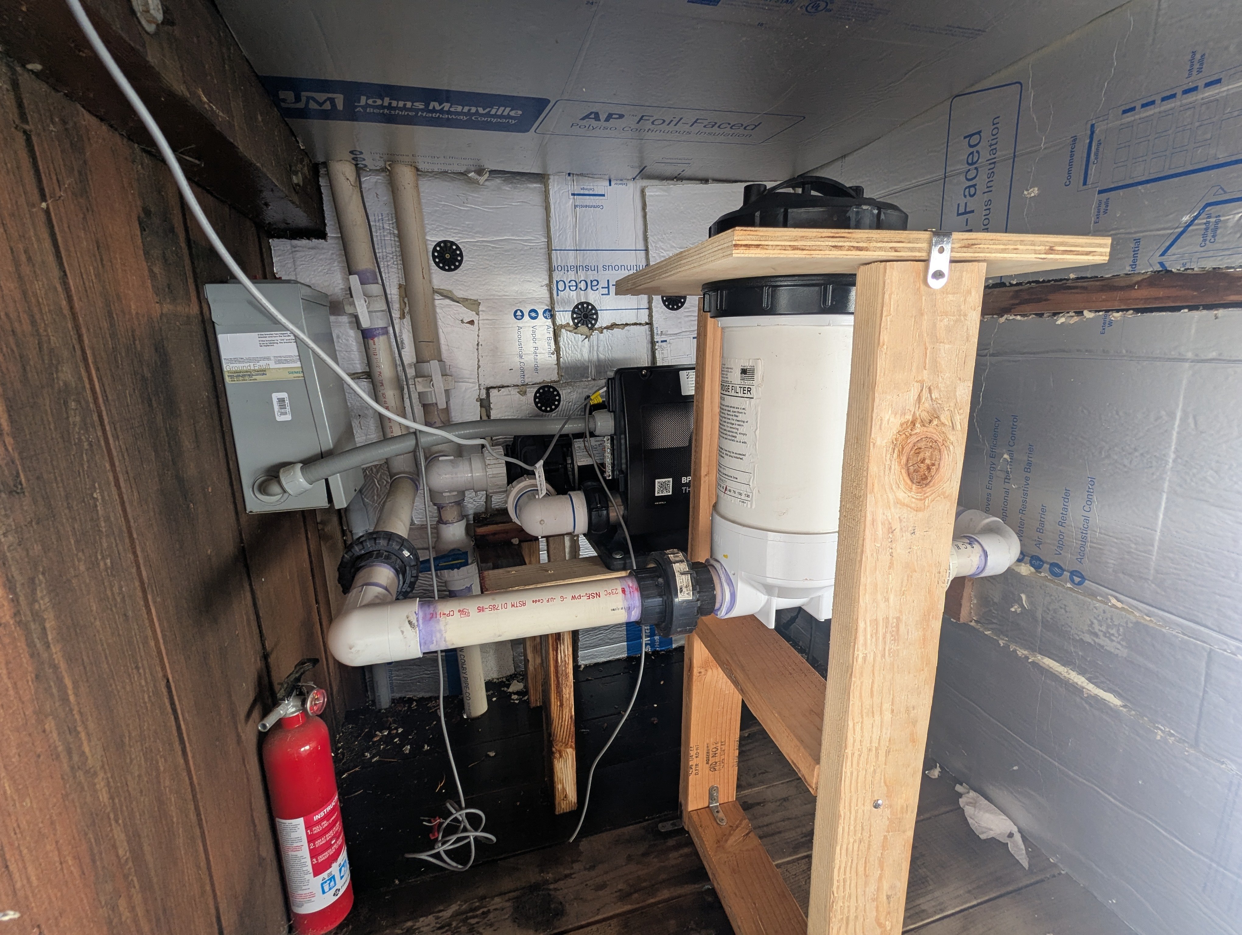

Here is the setup:
  • 250 gallon hot tub, external plumbing under the tub
  • 240V Balboa BP7 with 5.5Kw 240V heater
  • One 120V Pump - Two speeds (Sta-Rite)
  • External filter housing
  • Wifi Module I installed
Here are the diagnostic steps I have tried:
  • blower jets (4) are all open
  • Cracked open the bleeder valves on pump wet end, and filter housing, to vent air.
  • Cracked open the unions before and after the heater, to vent air
  • Removed filter from filter housing
  • Ensured Gate valves are open
  • Restarted whole system (power off/on)
  • Refilled hot tub again (I am now on the second fill)

Looking at your plumbing where it enters the face of the pump you have a Tee and a down pipe with a closed ball valve I can only assume is to drain the spa?
So for the water to enter the pump it comes down the pipe hits the ball valve and goes back up and into the side of the Tee then into the pump face and pushed through the heater tube and the rest of the system back into the spa.
Is there turbulence/cavitation occurring at the Tee junction adding air and/or reducing flow on low speed?
Might have used a WYE fitting here but a direct 90/45 would be preferred.
Research "liquid flow Through a Tee fitting". Perhaps you can find someone fluent in fluid dynamics.
IMO everything else should be/looks correct... even the 30" lift
Is this the cause of your issue... no idea I'm just spit balling but as a last resort should be considered if all else fails.
@Spa Board Doctor thoughts on this?

The "T" at the intake looks okay to me (providing no air leaks, as per CST).  Like my Canadian friend, I think it's a flow issue.  Use test mode to see it.
