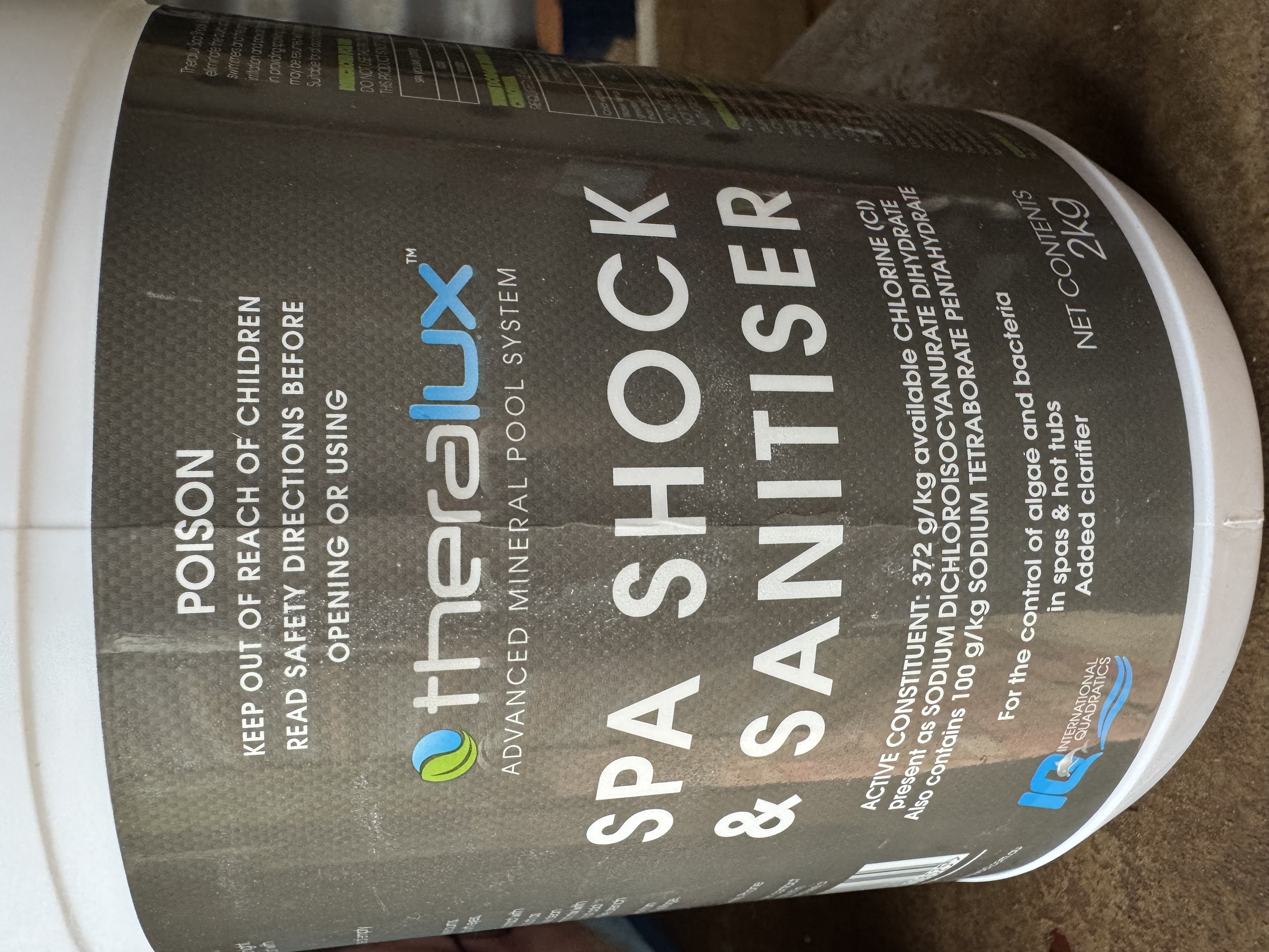

waterbear Posted February 14 Report Posted February 14 Borax is a good additive but it seems to be used as a filler in this product since borax is cheaperctgsn dichlor. Quote
