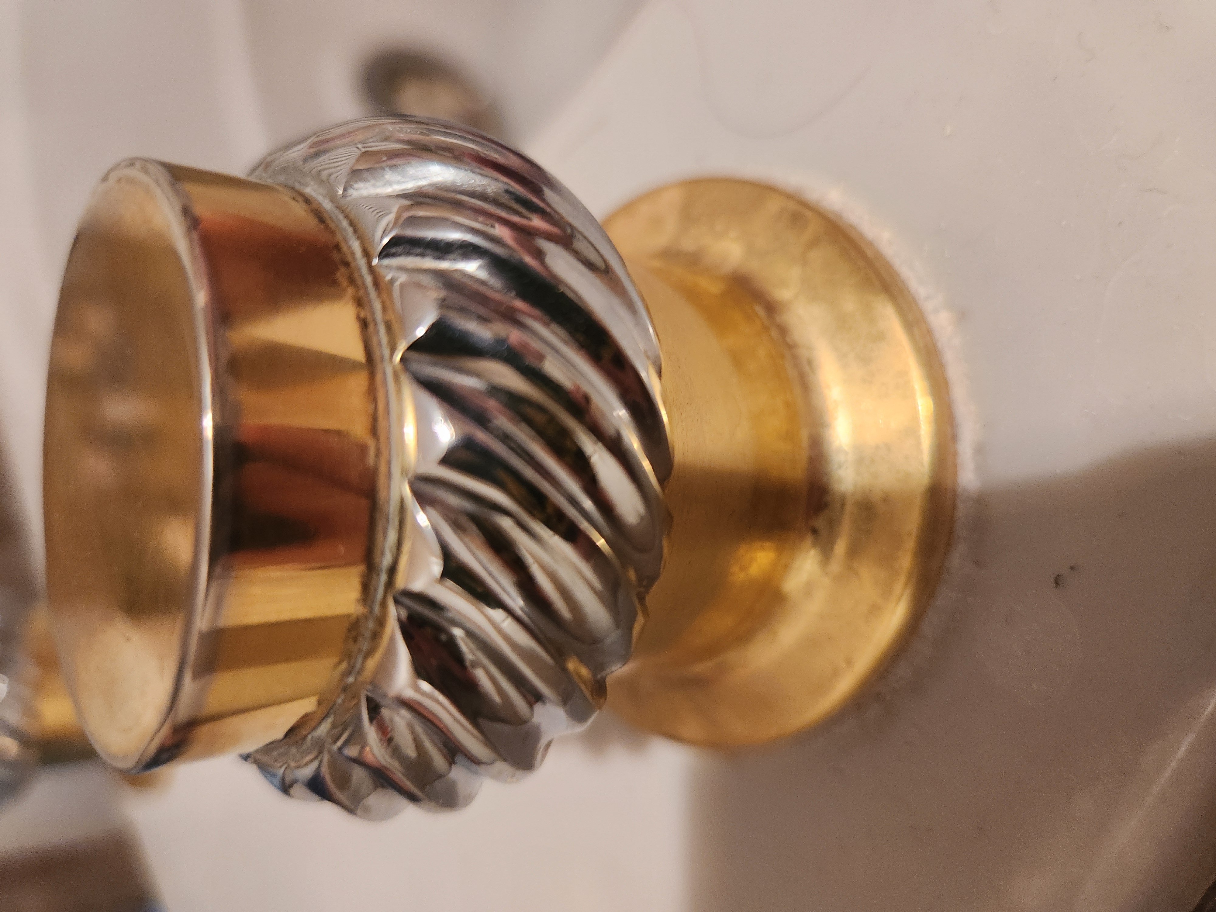

Looks like one of those handles with a hidden screw. Try prying off the center cap (if there is one) with a small flathead screwdriver there’s usually a screw underneath holding it in place. If there’s no cap, check the base or underside for a tiny set screw like an Allen wrench or small screwdriver should do the trick. If it’s just stuck, it might be threaded, so try twisting it off counterclockwise. A little WD-40 around the base can help if it won’t budge. Once you get it off, you’ll probably need to replace the cartridge or washer to stop the leak.
