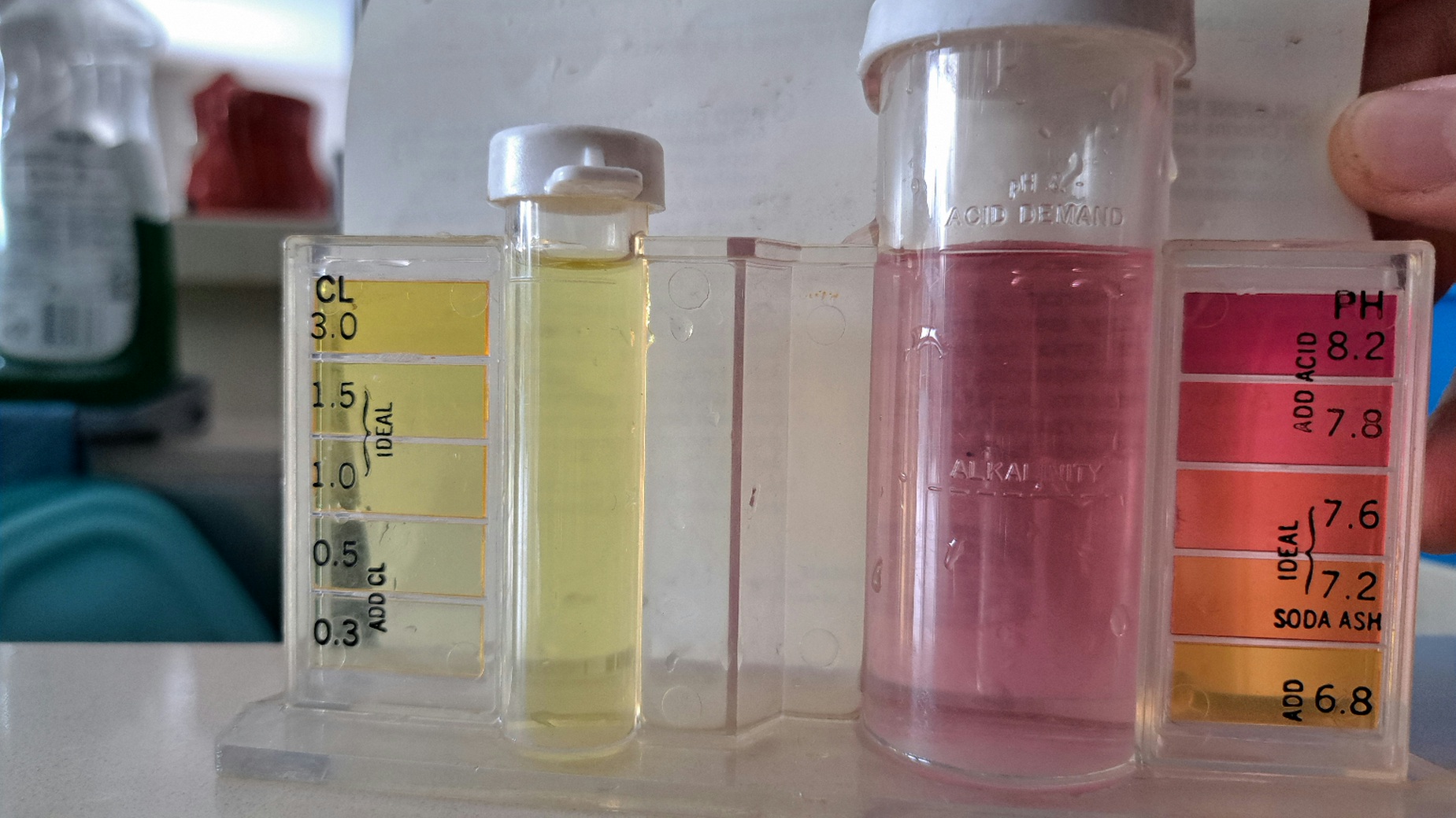

I added another 0.5oz of sodium bromide and then 6oz of bleach last night because the OTO test was a very faint yellow (around 0.3 on the scale in attached photo). After a little while I tested again and was getting 3 (brighter yellow).  I also have a bromine floater with tablets in the hot tub but it didnt seem to be doing much to raise the sanitizer levels.
I tested again just now and it looks like it's dropped to 1.
pH has gone up to 7.8 so I'll add some miuratic acid. I guess keep adding bleach?

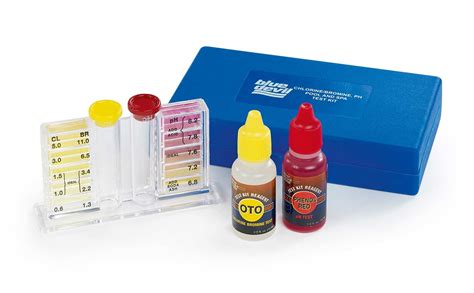

Your test kit only has a chlorine scale. Multiply the reading by 2.25 to get total bromine.  How are you testing TA? I would recommend getting a Taylor K-2006 for both your pool and spa even though it's pricy in Canada. For bromine you would test FC and multiply the results by 2.25. This applies to OTO, DPD, syringaldazine, and FAS-DPD testing. You don't need to test a bromine system for CYA. OTO only tests  total chlorine or total bromine which is fine for a bromine system but for chlorine you really need to know both FC and CC.

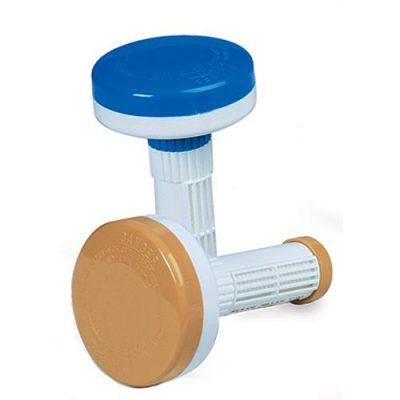

From what you have said you have never gotten the bromine to shock level (over 10 ppm and up to 20 ppm. Get it to shock level and let the bromine drop below 10 ppm before entering the spa. 10 ppm would be darker then the 5 ppm block on your tester. There are OTO kits that have a scale that goes to 5 ppm chlorine/10 ppm bromine such as the K-1000 from Taylor or the 3 way (chlorine/bromine/pH) test kit from Blue Devil. However, I still recommend getting the Taylor K-2006 FAS-DPD test kit which will test FC, CC, Total bromine, pH with both acid and base demand, TA, CH and CYA (for your chlorine pool). Also, if the floater is not maintaining the bromine open it up more. I recommend this Pentair 335 floater since it is very adjustable:
IF you still cannot hold bromine then you need to purge. You mentioned it is a new tub and manufacturers wet test them when they are made. This leaves some water in the lines which can allow biofilm to grow.

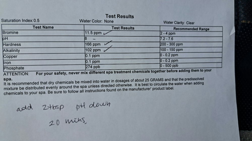

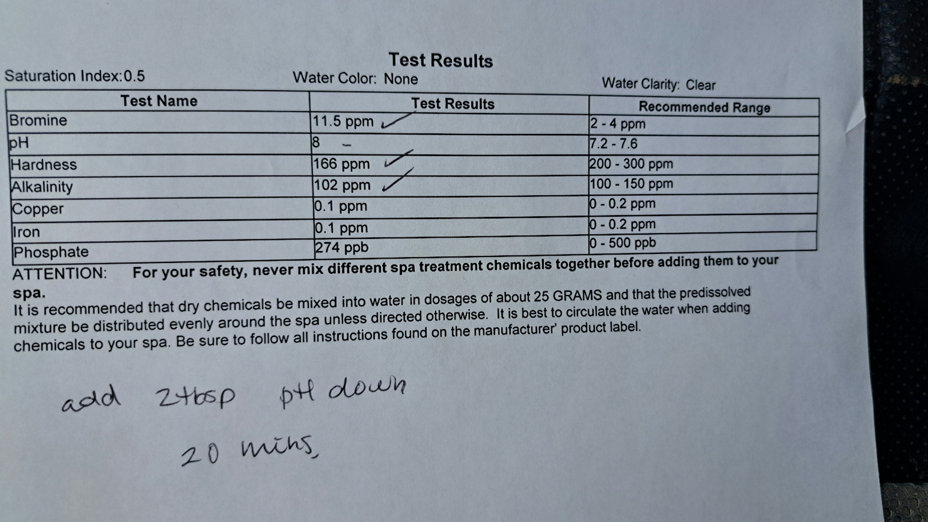

I have also taken samples to the pool shop. Based on both, my most recent results are:
Cl: 1.0ppm
pH: 7.8
Alk: 90ppm
Hardness: 171ppm
Is the best way to get the bromine to shock level (10ppm) is adding more bleach?

Thanks for all the help. I added another 10oz of 4% bleach. Here's the latest result.
