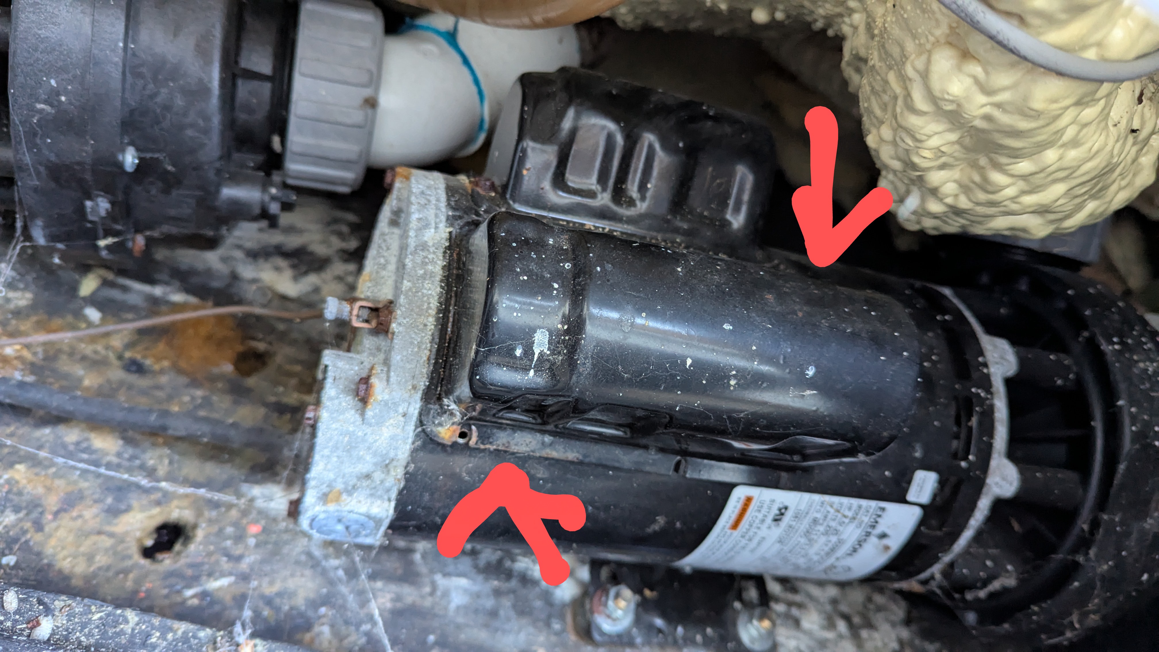

Not sure if I doing what I am suppose to. I removed couple screws (see attached picture) but couldn't remove this cover. It's stuck, and I'm afraid to apply too much force. Is this dust cover?
Additional note is couple times it didn't start right away even on high speed, but then it did. On low speed it didn't.
No Just below the copper wire at left in the middle of the motor there should be a plastic dust cap and the motor shaft is behind it. The 2 black humps are the start capacitor ad the run capacitor. Be careful with the caps as they hold a charge.
