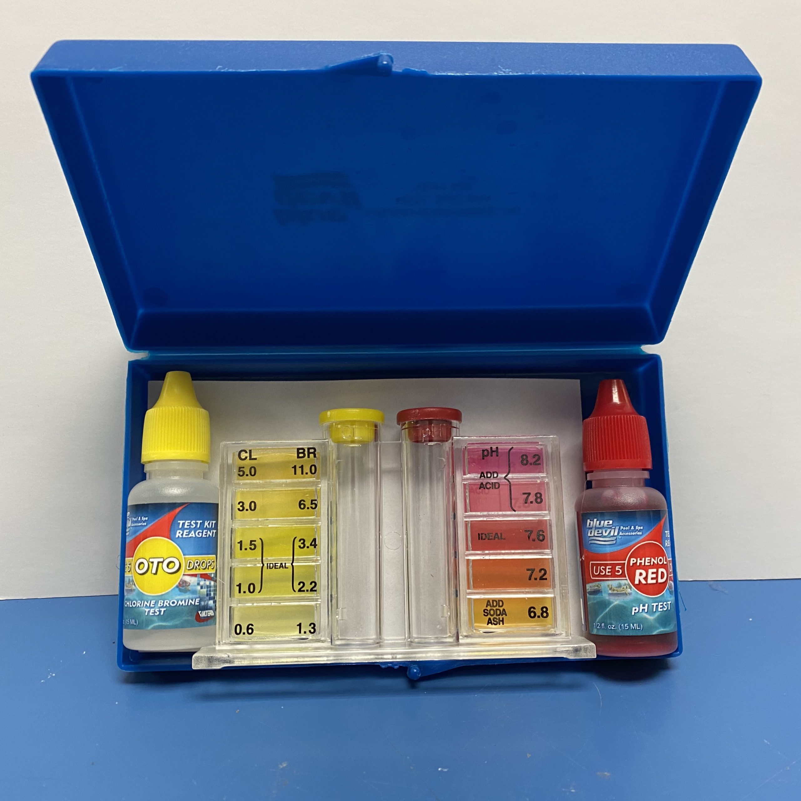

waterbear Posted January 14 Report Posted January 14 How are the they testing your water? Are they using strips in a reader, a disc that is read in a machine, or some other method. Once again, what is your your sanitizer reading and are you using chlotine or bromine since this is an indoor pool. I have a suspicion that your sanitizer is high (even if it is testing low due to bleachout of the DPD reagents which occurs at high sanitizer levels, which cause false high pH readings because of a chemical interaction between the pH indicator and the high level of sanitizer and can also cause low TA readings because of bleach out of the indicator reagent used for the that test. I need to know what sanitizer you are using and either your total bromine or your free chlorine and combined chlorine readings and need you to do one more thing to eliminate this possibility. Get an inexpensive 2 way (sanitizer/pH) liquid drop based test kit that uses OTO reagent to test chlorine and bromine. They are available at most big box stores like Hone Depot, Walmart, Lowes, Ace Hardware, and many pool stores and online retailers for a few dollars. You will know it is an OTO based kit because the comparator will have yellow color blocks for the chlorine/bromine test and not red color blocks which DPD testing uses. OTO does not bleach out like DPD but only tests total chlorine and not Free chlorine, which is what we want to know which is why DPD is widely used. Test your sanitizer and tell me what color it turns (stays clear, light yellow, deep yellow ,orange, brown). Once we confirm or dispel this possibility we can move on to the next step in getting your pool rebalanced Quote

waterbear Posted January 19 Report Posted January 19 I thought you said you were using chlorine and not bromine. The same test is used for both bot if you have a bromine pool the reading would be approx. twice the chlorine reading. You have either one or the other. Which is it? If you have a chlorine pool disregard the bromine reading. If you have a bromine pool and the test does not have a bromine readout or scale then multiply the FC reading by 2.25 to get bromine. I made a typo in my previous response which I have corrected. This is what I get for answering posts at 4 am First we need to determine if you chlorine is really high (and I suspect it is because the strips show a very dark color for sanitizer and the LaMotte DPD test starts bleaching out below 10 ppm and the fact that the TA is low after adding all the baking soda also indicated bleachout -- FWIW alkalinity up is just baking soda (sodium bicarbonate AKA sodium hydrogen carbonate) and is much cheaper at the grocer than the pool store). Checking if the sanitzer is high enough to cause bleachout is best done with an OTO test kit (2 way tester for chlorine/bromine and pH that has yellow blocks on the santizer test comparator). If it is high we can take it from there. These test kits are inexpensive and readily available but of limited use. Determining if high sanitizer is bleaching out a DPD test or testing bromine are their best uses. Since they only test total chlorine they are not that useful for chorine pools other then determining if your chlorine is very high. This is an example of what I am talking about: Quote
Ashleigh Posted January 20 Author Report Posted January 20 So I cannot find an OTO test in Australia, they are all just the dpd tablets. Can I just assume it is high? And what to do next? Quote
waterbear Posted January 20 Report Posted January 20 4 hours ago, Ashleigh said: So I cannot find an OTO test in Australia, they are all just the dpd tablets. A quick Google seach found these: https://mrpoolman.com.au/products/water-technix-5-in-1-test-kit-pool-spa-chlorine-bromine-ph-alkalinity-acid https://www.poolset.com.au/pool-set-5in1-test-kit.html https://www.bestpoolsupplies.com.au/product/737/Pool-Water-Test-Kit-6-in-1 https://www.ebay.com.au/itm/405382704929 https://www.ebay.com.au/itm/166946602847?_trkparms=amclksrc%3DITM%26aid%3D1110006%26algo%3DHOMESPLICE.SIM%26ao%3D1%26asc%3D279336%26meid%3D5ffa198a171e49caa9a907d0a3c14e69%26pid%3D101875%26rk%3D4%26rkt%3D4%26sd%3D405382704929%26itm%3D166946602847%26pmt%3D1%26noa%3D0%26pg%3D2332490%26algv%3DSimVIDwebV3WithCPCExpansionEmbeddingSearchQuerySemanticBroadMatchSingularityRecall%26brand%3DUnbranded&_trksid=p2332490.c101875.m1851&itmprp=cksum%3A1669466028475ffa198a171e49caa9a907d0a3c14e69|enc%3AAQAJAAABQNthdh9o32sOfKme0krmx3yc5y0DRWWwwpiraCEsA5rOcanQjqu91drTeDElZLF31uaWQXaQ2pNTl5IMyA1OfooQwqEcJUvtG9LvKPKHgcRzphx12iPvBSva61o%2BMhuWL%2F159NOALpZmmVOgiYanH32fPmC7YiVdgsCP07bsQSJyiPtc9eCLBuuuxUJog3mK9sbxHLPaKnctlrdOenYog524XAWayHbuM3kvSBWavUsmGTezfmrveGABYxRAXBPLifi00Z9IO7tsocoBrnFqFuK5vUdwdox%2FSErstVN4wNfxIY7HHEK8IMc6L6pJ9XMvDuj5G%2FsbYmTxFfvHpgNzoSU%2B%2F7w1DeNhosUXN48hONI8b641tNgffdx92ypDRz9PZixckG3zE5gdvEbrZHoLyw2VzTlr6hegOL8%2B2ciJ1thI|ampid%3APL_CLK|clp%3A2332490&itmmeta=01JJ11QZ6SERJMKKVB57Z6ADAH The first three are based on the Taylor 1000 serires kits (They look like rebranded Taylor kits) but even the cheapest one from eBay will do the job. You just want the OTO reagent and comparator and we will not be using the color blocks. If the color is yellow your chlorine is not high, if deep yellow it is high and can possibly cause partial bleachout and inaccurate pH readings. If the color is orange to brown your chlorine is way too high and bleaching out your DPD and TA and causing totally incorrect false high pH readings. As an alternative to the OTO test you can test with DPD but dilute your sample with distilled water. Start with a 50/50 mix of pool water and distilled water and test chlorine and multiply the results by 2. If it still is testing low then dilute 1 part pool water with 4 parts distilled water and multiply your results by 5. These procedures are a pain but can tell you if your DPD test is bleaching out if you don't have an OTO test. If you just want to assume that your chlorine is high or if either OTO or diluting DPD shows it's high then turn of the SWCG. If the pool is covered uncover it, circulate continuously and you can either add a chlorine reducer (sodium thiosulfate) or hydrogen peroxide (used an oxidizer in biguinide sanitizer systems but I don't know if they are used in Australia. In the USA they are under such brands as Soft Swim, Revacil, and Baquacil.) Monitor pH as you use the chlorine remover and if my suspicion is correct you will see it drop on it's own. It's not really dropping, you are getting accurate pH readings without the chemical interference from the high sanitizer, You should also see the TA increase because the indicator is not bleaching out. . Quote
