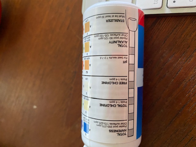

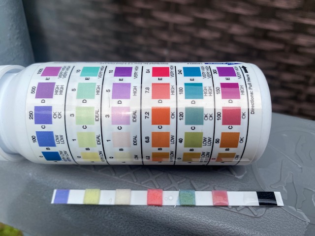

robhawaii Posted October 5, 2024 Author Report Posted October 5, 2024 Thank you for this very detailed explanation and recommendation's. If I follow this I might be able to solve my recurring algae issues. Actually, I'm on Hawaii island in Upper Puna on the East side at 1200 ft elevation. Our home is in a dense forrest/jungle in lava zone 3. Between May-December daytime temp is 78-80 and nights 68-70. January-April is low 70s in the day and 59-63 at night. The pool is warm enough to enjoy (78-81) between May-December if it is sunny and covered overnight. Our average annual rainfall is 140 inches and tends to be acidic. I'm including a photo of the test strip from this morning after vacuuming the floc yesterday afternoon. I read Tot Chlor = 1, FC=0,PH= 7.8, Tot Alk=120, CYA=100. However, I normally have low PH and low Tot Alk and add baking soda to raise. CYA and FC also tends to be low. I will admit that I tend to focus on correcting Tot Chlor and PH and overlook the FC and CYA, my bad. I appreciate the education on this. My usual low FC and low CYA is likely causing the algae as you stated! BTW - Our water is rainwater catchment in a 10K gallon galvanized tank with food grade liner. Water is filtered to 5 microns and run through a UV sterilizer before it enters our home. Since rain is on the acidic side we have a reverse osmosis that also adds minerals and balances PH for our drinking water. Just wanted to add this info since I mentioned that we have 140 inches annual rainfall and it's acidic. Thanks again! Quote
waterbear Posted October 6, 2024 Report Posted October 6, 2024 Strips are basically useless. While they are precise (repeated tests on the same sample give the same results, they are not really accurate for many of the tests (giving results that indicate the actual water parameter levels of the sample). also the precision of strips is often too wide to give any meaningful info to balance water. Case in point, TA scale is +/- 40 ppm or worse and the pH scale has big jumps of .6. TA should be adjusted to 50 to 70 ppm for best pH stability and pH needs to be monitored more closely. There is a big difference of pH of 7.2 and 7.8 in terms of water balance and with a vinyl pool a pH of below 6.8 to 7.0 will damage your liner. They CYA test in strips is another one that is basically useless. My suggestion is to invest in a Taylor Technologies K-2006 (FAS-DPD testing method for chlorine) kit and stop using strips. It is worth every penny. https://www.taylortechnologies.com/en/page/231/k-2006-complete-kit-with-fas-dpd Also, read these: https://www.poolspaforum.com/forum/index.php?/topic/52523-some-truths-about-ph-and-ta/ https://www.poolspaforum.com/forum/index.php?/topic/28846-lowering-total-alkalinity-howto/ https://www.poolspaforum.com/forum/index.php?/topic/58991-false-high-ph-readings-when-shocking-some-truths/ https://www.poolspaforum.com/forum/index.php?/topic/53108-some-truths-on-bleach-dosing/ You might want to consider switching to liquid chlorine or laundry bleach (sodium hypochlorite) for chlorination once your CYA reaches 50 ppm with the trichlor and stop the trichlor. Cal hypo (calcium hypochlorite) is also an option for chlorination since your fill water is so soft. Just remember to predissolve it in a bucket of water before adding so you don't bleach your liner. It is very slow dissolving and if added directly to the water will sink and sit on the liner and cause bleach spots. Maintain your FC at 4 to 6 ppm and if your CC never rises above .5 ppm you do not need to shock. Use bleach or cal hypo to shock if/when needed Quote
