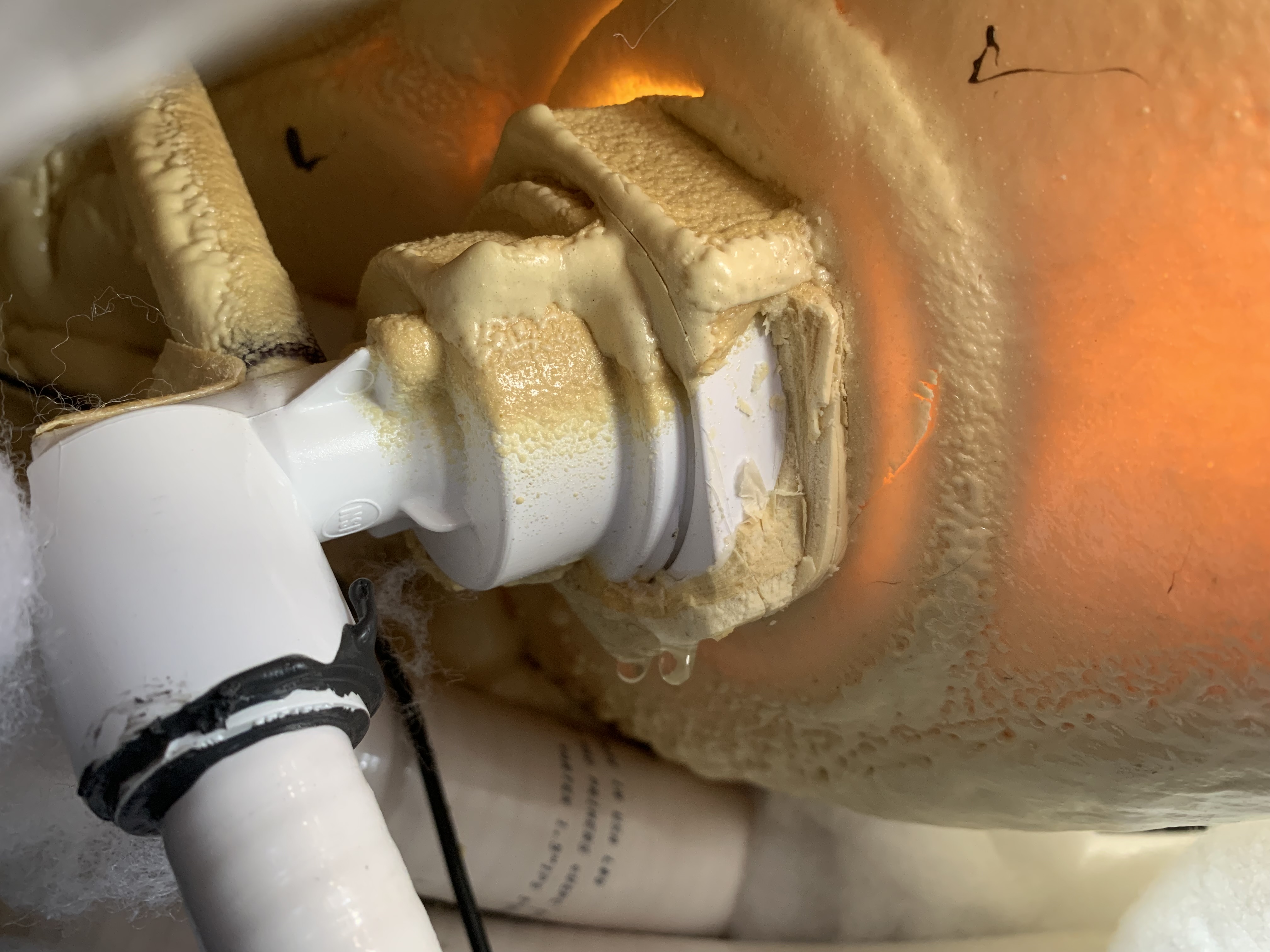

RGrove Posted September 28, 2024 Report Posted September 28, 2024 Filled the spa a few days ago after having emptied it at the beginning of summer and noticed I have a leak at one of the jets. See photo below: I have been able to remove the jet housing, which had somehow developed a crack. A replacement is reasonably priced at $15, but labor costs and mileage for a service call bring the total cost of repair by the folks I bought the spa from to $800+. So naturally I would rather replace it myself, which for the most part seems straightforward. Where I am unsure how to proceed is with removing the hoses from the back of the old housing and reattaching them to the new housing. It appears that they are glued in with a special adhesive (the black stuff in the photo). Does anyone know what this adhesive is and the proper way to detach hoses from the current housing? I would prefer not to cut them if it is possible. My concern is that there may not be enough slack on at least one of the two to allow easily reattaching it to the new housing. Any thoughts on how to proceed with the repair as well as why this thing might have cracked would be greatly appreciated. Randy Quote
RGrove Posted September 29, 2024 Author Report Posted September 29, 2024 After doing some internet research, it appears that many people use standard PVC, couplings, primer and glue to repair leaks that involve the flexible hose used in spas. Unless someone knows that this is not good practice, I feel pretty confident that I can make the necessary repairs. Quote
RGrove Posted October 6, 2024 Author Report Posted October 6, 2024 (edited) I was able to repair the leak described above using Christy’s Pool and Spa cement. Unfortunately after refilling the spa I have discovered that this was not the only leak. I have been unable to find the exact location of the other leak, and fear that to do so I am going to have to gain access from the adjacent side. The problem is that there is no easily removable panel here, all the plastic planks are glued in place. Another difficulty is that I suspect all the piping and fittings are going to be buried in expanded foam. I would love to hear advice from anyone who has attempted similar repairs before I just dive off into this and create more problems. A specific question: Does anyone know if there are access panels in the bottom of the spa if I were to empty it and turn it on the side? Randy Edited October 6, 2024 by RGrove Added specific question Quote
