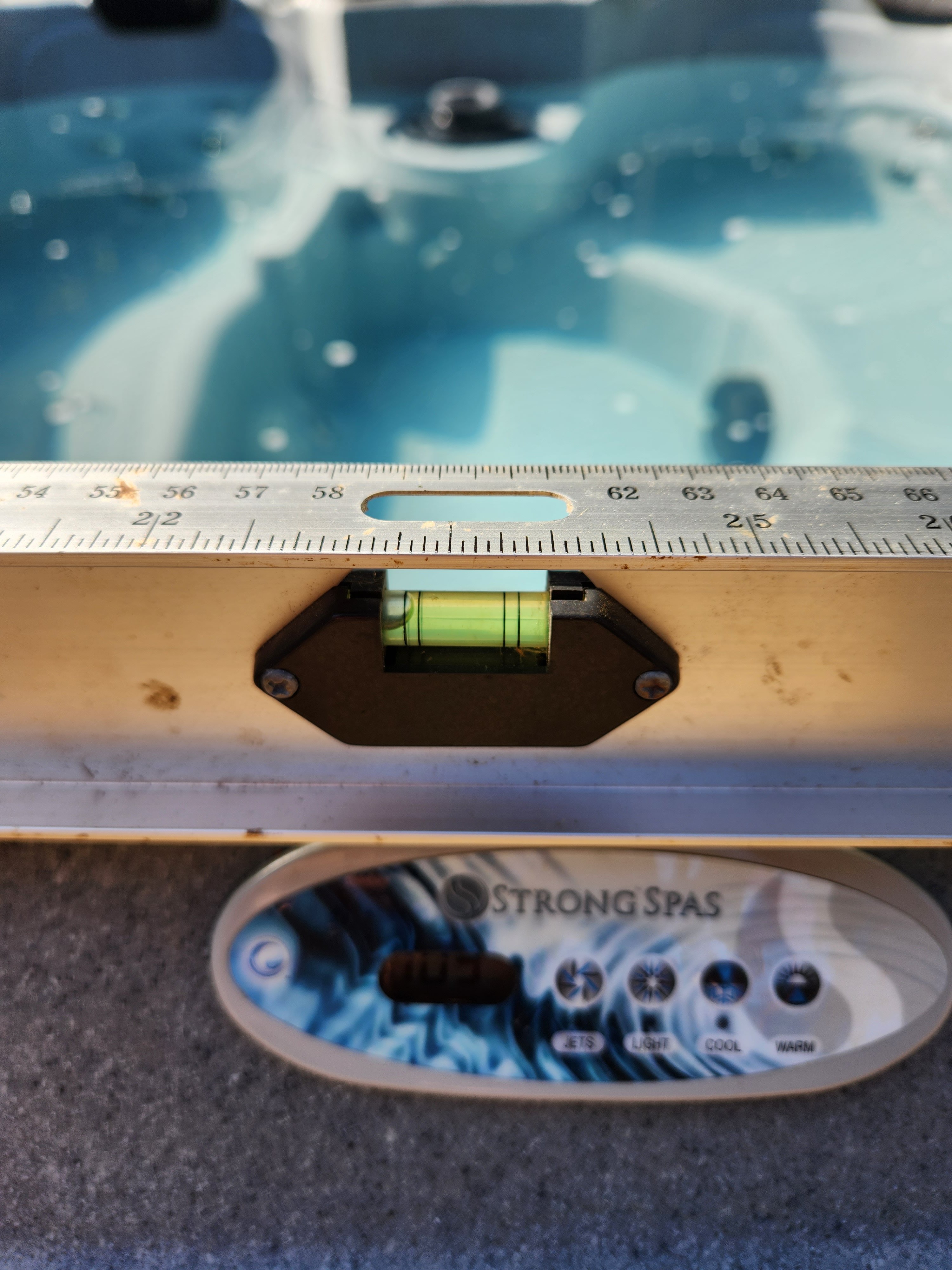

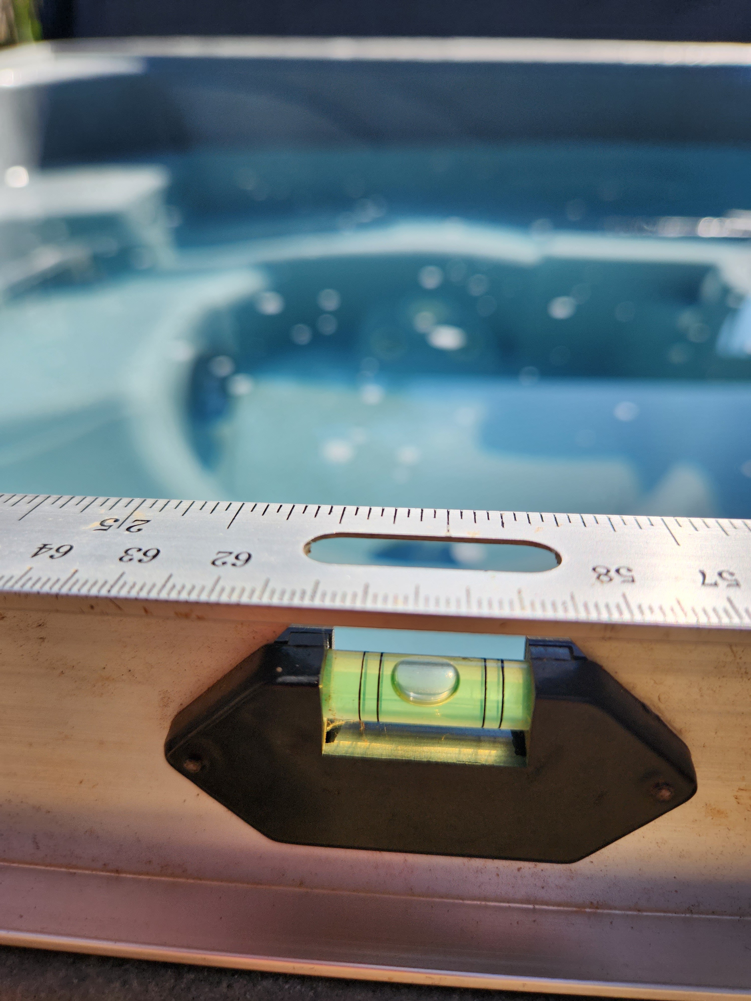

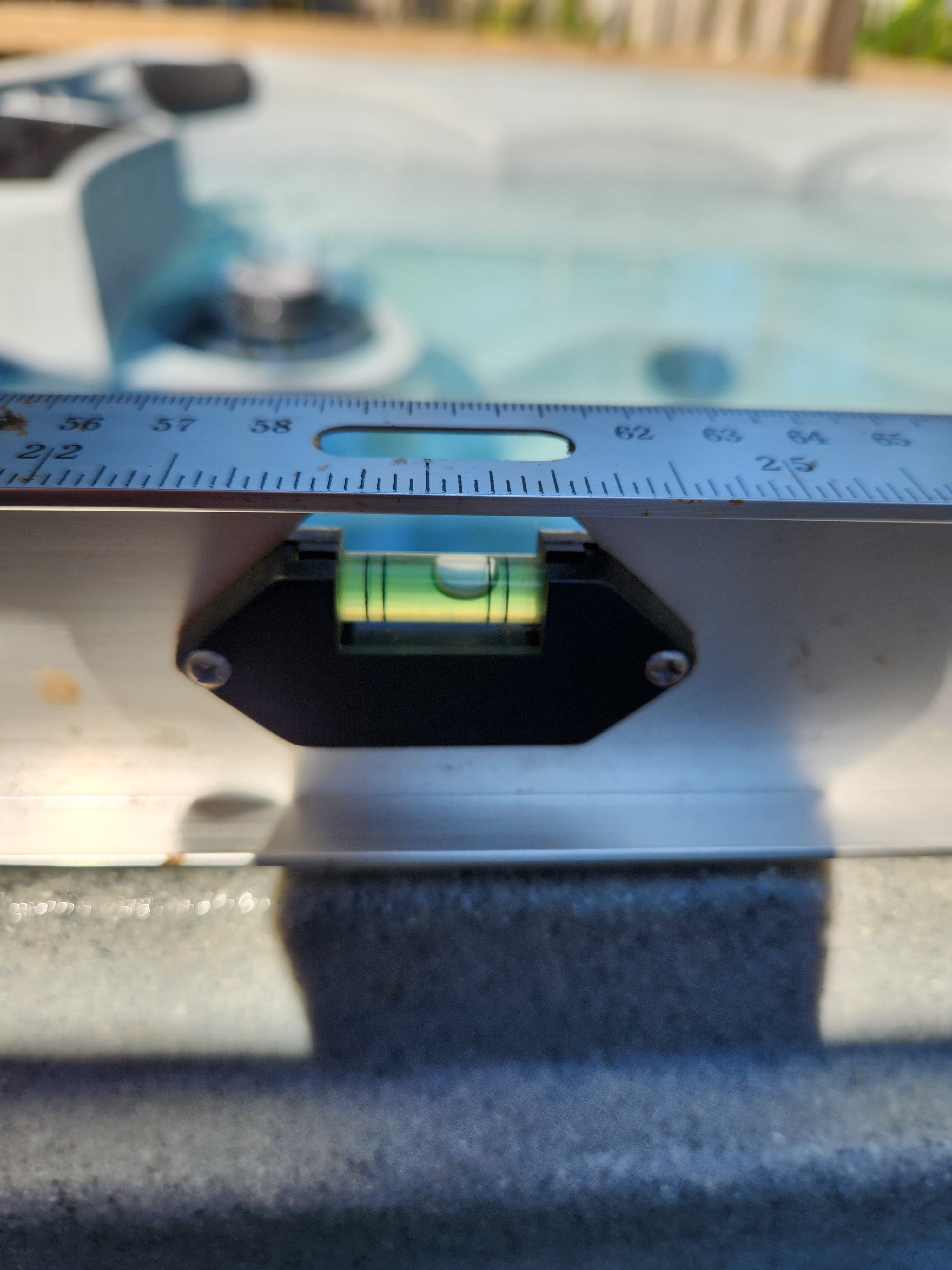

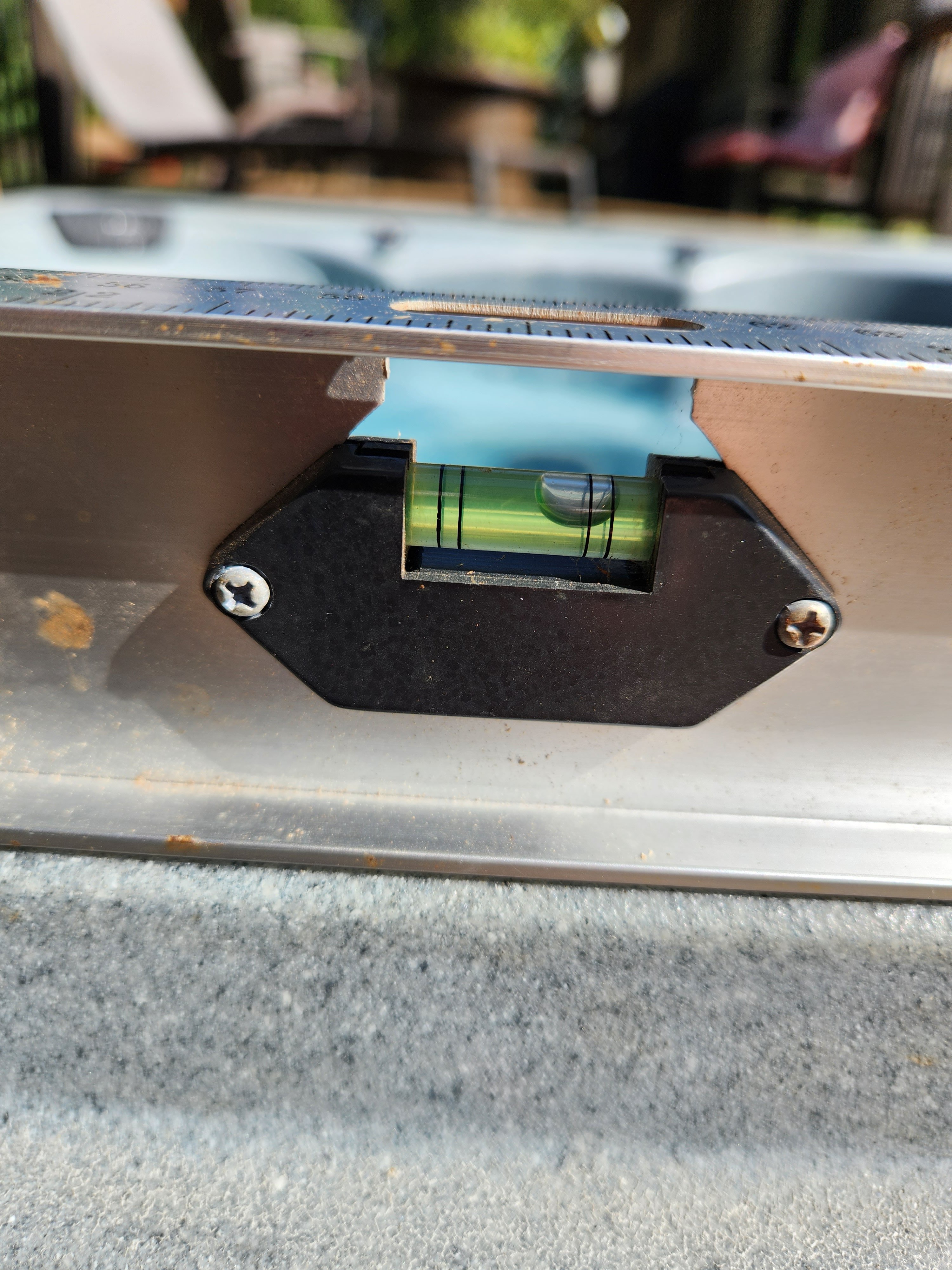

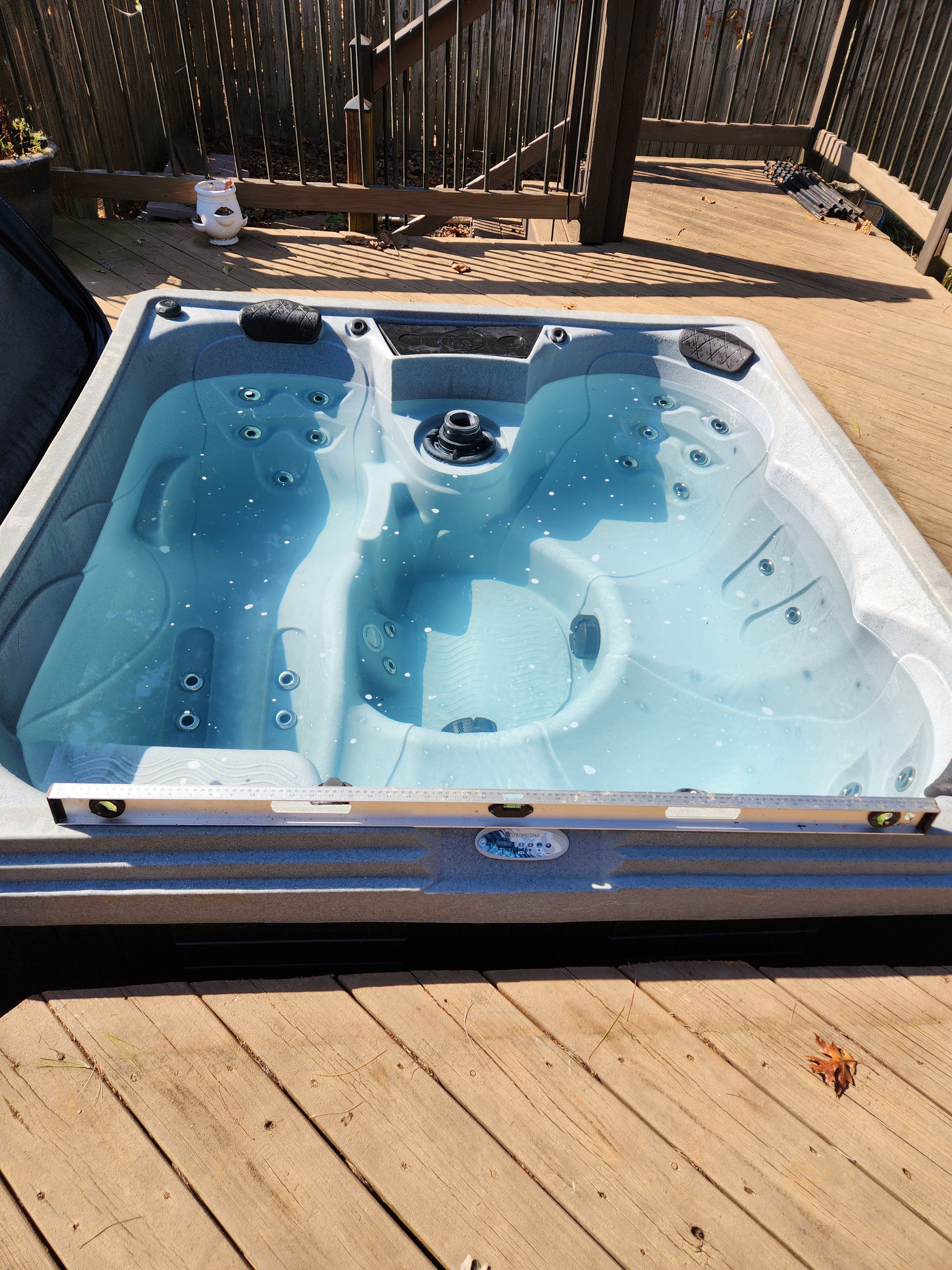

csdude55 Posted October 10 Author Report Share Posted October 10 Sorry for the late reply! I just now found the emails in my spam folder, I didn't know anyone had replied 😕 I'm including a pic from above, you can see the water level on the right versus left. I had another pic that showed it more clearly, but I keep getting an error while uploading it 😕 I'm also including 4 pics, showing the level on each side. The side with the control pad is the most out of level, and the opposite side is the next worst.  Quote Link to comment Share on other sites More sharing options...
creoleswift Posted October 11 Report Share Posted October 11 Honestly what I did to my buddies was I jacked it up put sand underneath it you can use filler sand or anything really and it looks like you're off by about a half a dude so I would use the half inch by 12 square pavers pavers in the most unlevel but in this case you need to make sure you have enough sand under the whole thing to keep it even all the way through so it's a job and half I highly doubt you can pull that Jacuzzi out easily to get under there to pour enough sand because if you raise one side the middle is going to be not touching ground it's honestly an annoyance in your case Case if it's not bogging down your pump or anything I wouldn't even touch it to be honest Quote Link to comment Share on other sites More sharing options...
CanadianSpaTech Posted October 11 Report Share Posted October 11 Level the spa on blocks and use roofing shingles feathered out from low to high making sure the base is supported evenly. Have used rigid foam board insulation as well that is available in different thicknesses again making sure the spa is supported evenly side to side and front to back. Usually shave the first board to fit as a wedge. Whatever you do make sure the foot well has proper support and as mentioned flat and even is key. Quote Link to comment Share on other sites More sharing options...
