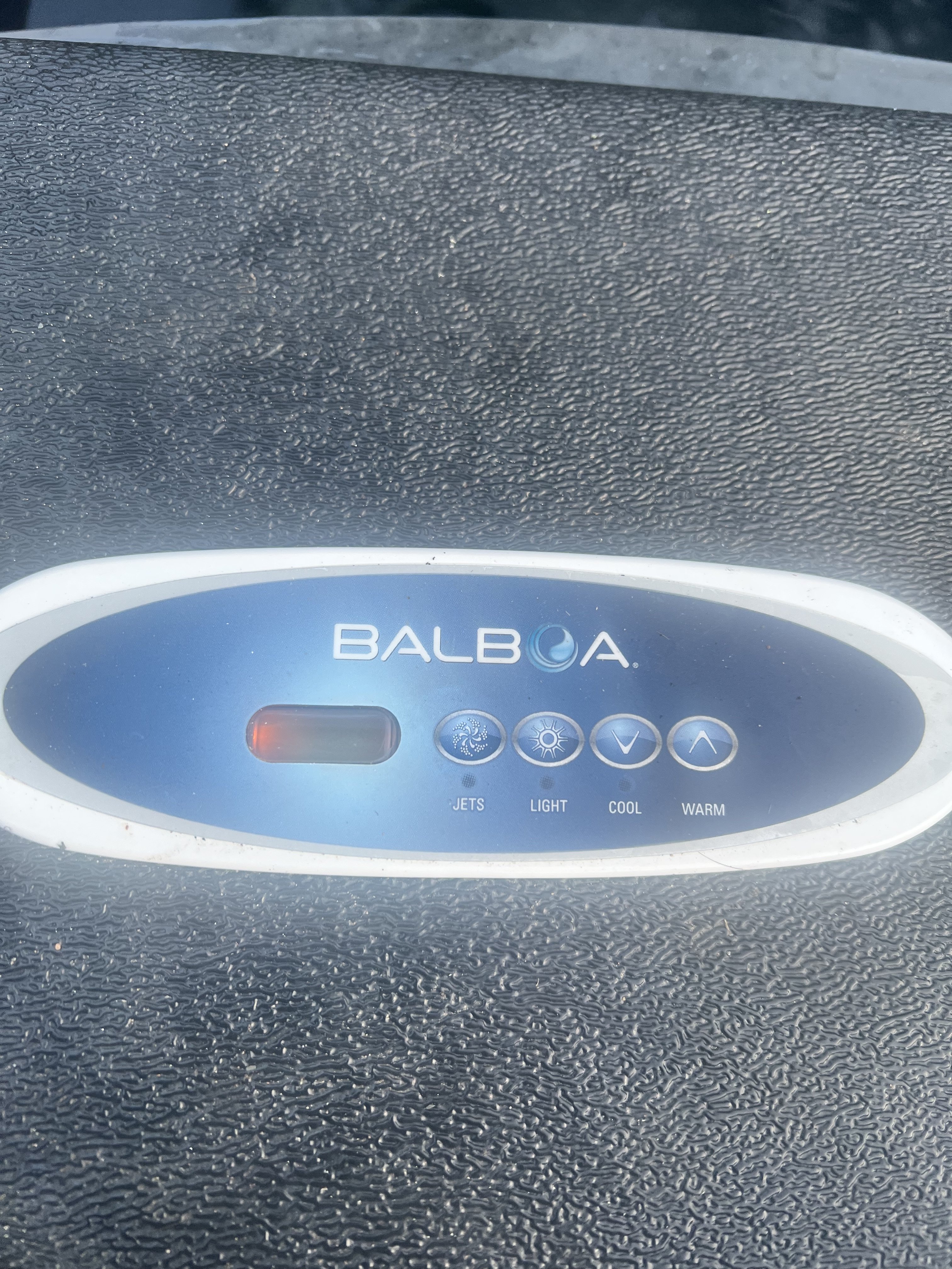

Niktink Posted June 5 Report Share Posted June 5 After a harsh winter i have turned back on my baboa hot tub. The screen is blank however still backlit. The tub did heat up, i used for a week but noticed a leak so turned off to fix the leak. Once done i turned back on. Screen was still blank but this time it hasnt heated up. Quote Link to comment Share on other sites More sharing options...
CanadianSpaTech Posted June 5 Report Share Posted June 5 High fail rate on those topsides Quote Link to comment Share on other sites More sharing options...
Niktink Posted June 5 Author Report Share Posted June 5 So would you say it is just a new panel needed Quote Link to comment Share on other sites More sharing options...
CanadianSpaTech Posted June 5 Report Share Posted June 5 Likely yes if you have no led numbers showing. Should still heat though. Pop the topside out and the part number is on the underside. Make sure to match the button configuration when ordering. Quote Link to comment Share on other sites More sharing options...
Niktink Posted June 5 Author Report Share Posted June 5 I assuming its stuck in sleep mode Quote Link to comment Share on other sites More sharing options...

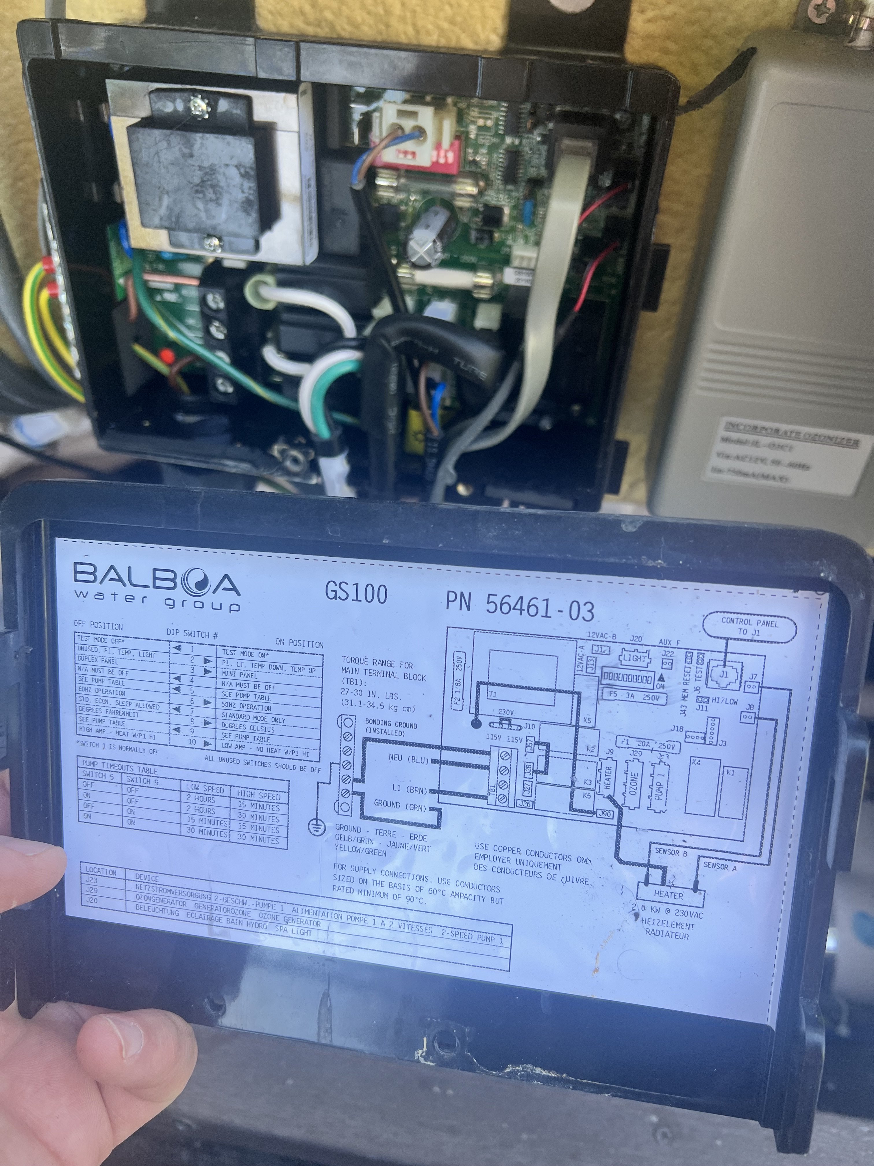

CanadianSpaTech Posted June 5 Report Share Posted June 5 In sleep it will only get to 80 degrees. There may be a setting on the circuit board to change the topside mode settings from SL/ECN/ST to just Standard mode. Then if the buttons still work you would be able to press the up button a bunch of times and see it you can get it up to 104 and then each down temp button press will equal 1 degree. Not perfect but might work for now. Post picks of circuit board and the schematic on the inside cover and we can see if there is a "dip" switch setting you can make to get it to ST mode only. Quote Link to comment Share on other sites More sharing options...
Niktink Posted June 5 Author Report Share Posted June 5 Quote Link to comment Share on other sites More sharing options...
Niktink Posted June 5 Author Report Share Posted June 5 So where would i find the switches. I can see i can put it in standard mode. Just dont know where to locate the switches. Thank you for your time btw Quote Link to comment Share on other sites More sharing options...
CanadianSpaTech Posted June 5 Report Share Posted June 5 Little red box just below where the light connects to the board. Turn power off to move switch A7 to up position. A1 is on left end A10 is on right end Quote Link to comment Share on other sites More sharing options...
