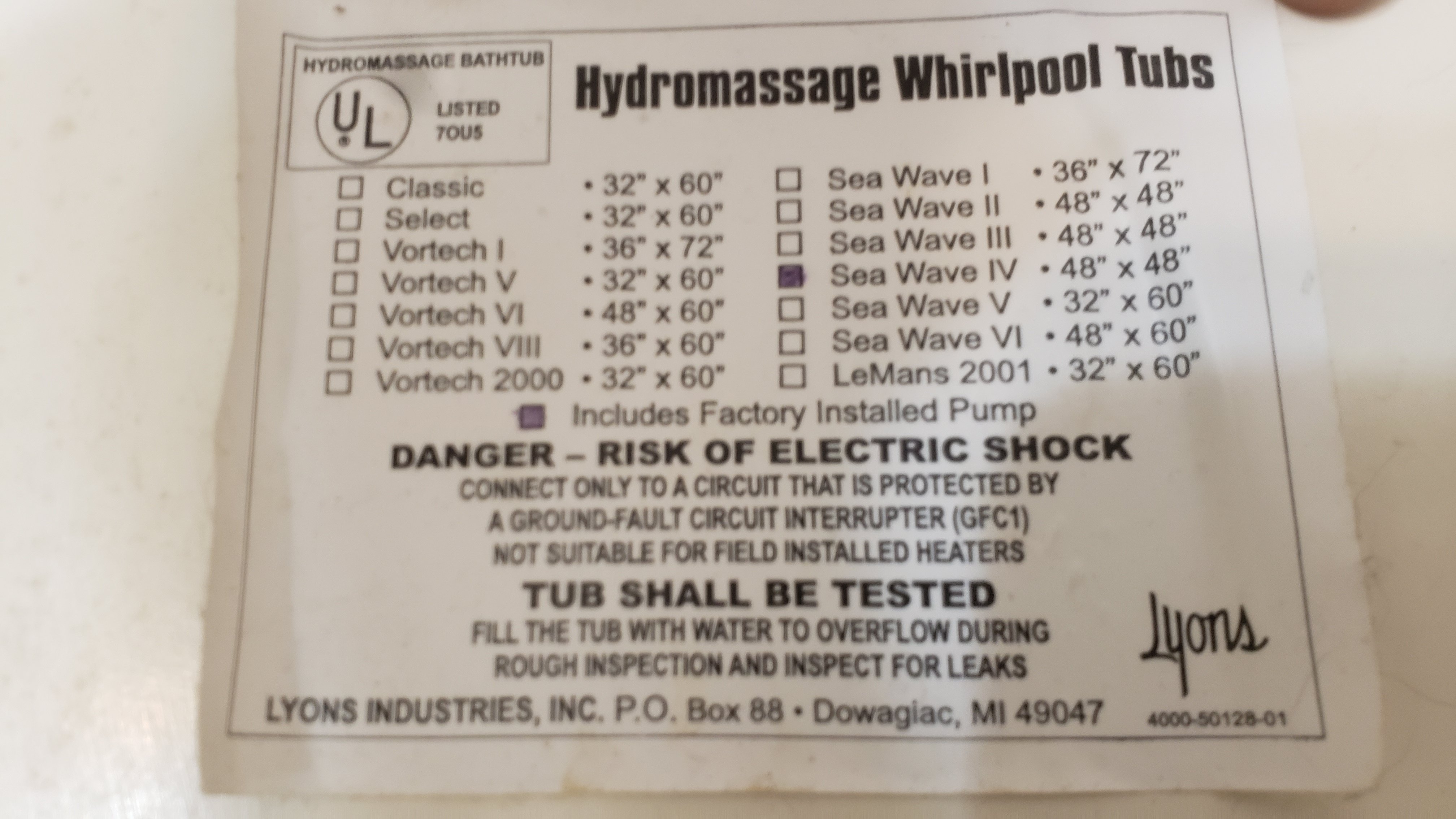

Somewhere around 2008 i purchased a Lyons brand 'SeaWave IV' corner whirlpool tub (LCWAU 4848) from Menards (home improvement store in USA) it has 4 jets, an Olympian 97111-420 pump, and added an inline heater.

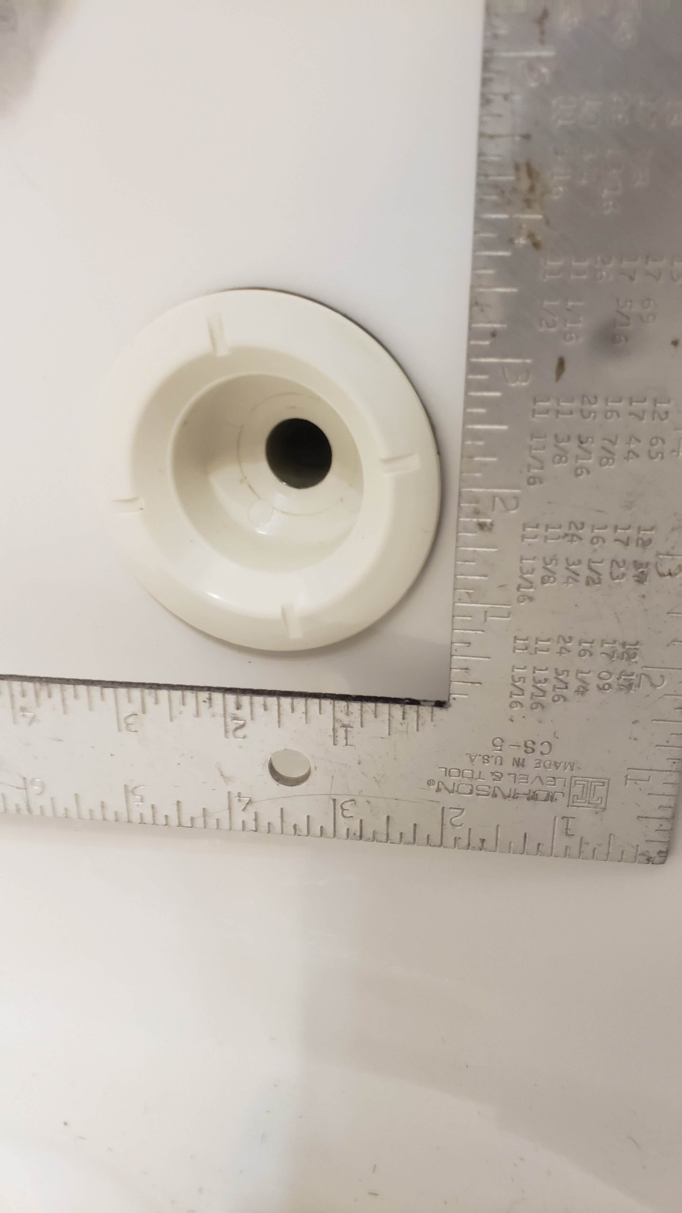

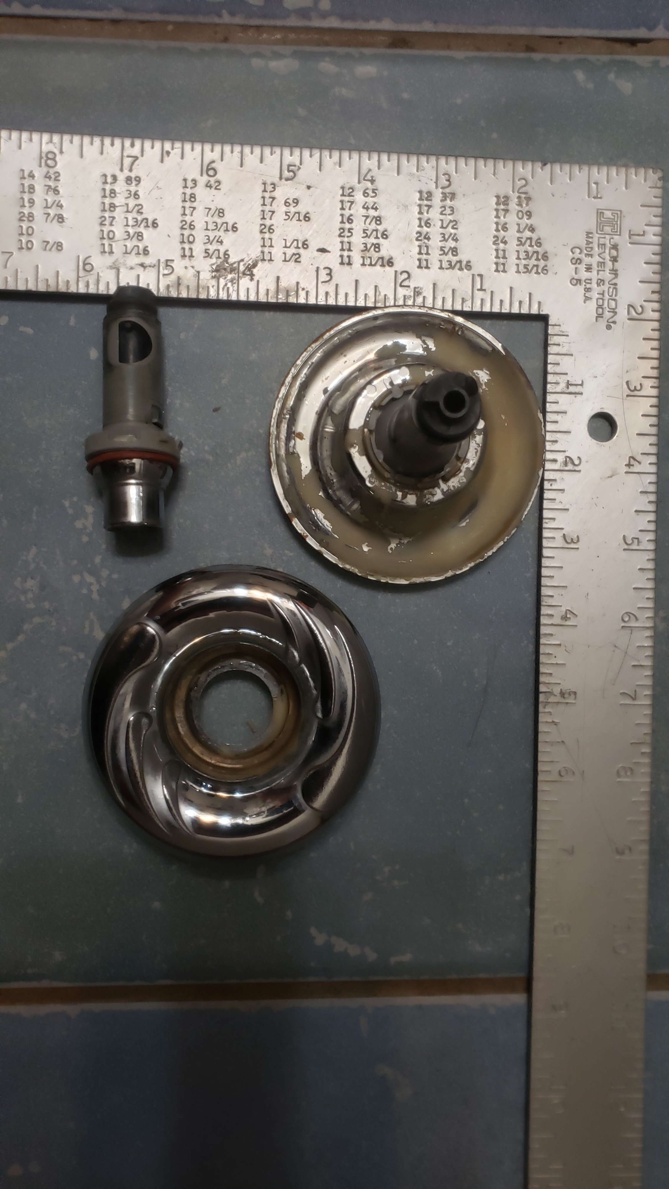

I contacted Lyons and have learned they stopped making whirlpools in 2019. They suggested i try https://waterwayparts.com/ for parts, but i'm not seeing anything that matches this.
[Img]https://imgur.com/JSfPkzQh.jpg[/img]
[Img]https://imgur.com/4tbF2ruh.jpg[/img]
3" jet face, 0.710" stem diameter, about 2.850" depth from end to jetface
The unlock ramp to remove the jet for cleaning is on the end of the diffuser stem
The lockring threaded onto the jet body has a partnumber 27396.
Any ideas what this might be? Or do i just need to talk to a local Spa store then have to spend some time under the tub with a holesaw?
