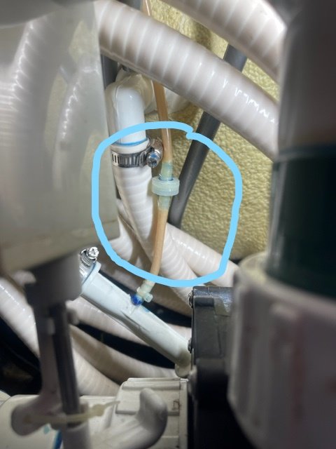

C4tm4n Posted May 21 Report Share Posted May 21 Hi all. Does anyone know what the highlighted part is and where I may buy a new one? It is on a Passion nSpa Corsica and is leaking. Cheers Steve Quote Link to comment Share on other sites More sharing options...
CanadianSpaTech Posted May 21 Report Share Posted May 21 It is a one way check valve to keep water from flowing past and getting into your ozone unit. Suggest you replace with 2 inline as extra protection. Make sure to install in the correct direction. If it is leaking you should get to replacement asap as the water will get into the ozone and cause a breaker trip and destroy the ozone unit. Quote Link to comment Share on other sites More sharing options...
CanadianSpaTech Posted May 21 Report Share Posted May 21 Looks like 1/4 hose but you need to verify before ordering https://www.trevi.com/en/pool-and-spa-accessories/replacement-parts-and-accessories/spas/ozone-check-valve-1-4inhb-3-8-inhb-at-1-2psi-10988 Quote Link to comment Share on other sites More sharing options...
C4tm4n Posted May 21 Author Report Share Posted May 21 2 hours ago, CanadianSpaTech said: It is a one way check valve to keep water from flowing past and getting into your ozone unit. Suggest you replace with 2 inline as extra protection. Make sure to install in the correct direction. If it is leaking you should get to replacement asap as the water will get into the ozone and cause a breaker trip and destroy the ozone unit. Thanks for the info. Just a few more questions . 1st is there an easy way to tell which way they go around, no arrows visible on it and 2nd, best type of glue to use when putting new ones on? Cheers Steve Quote Link to comment Share on other sites More sharing options...
CanadianSpaTech Posted May 21 Report Share Posted May 21 Flow goes from the top down. If you remove it from the bottom in the photo you should not be able to blow through it. There is no pressure to worry about. Zip tie would work or small gear clamp Quote Link to comment Share on other sites More sharing options...
