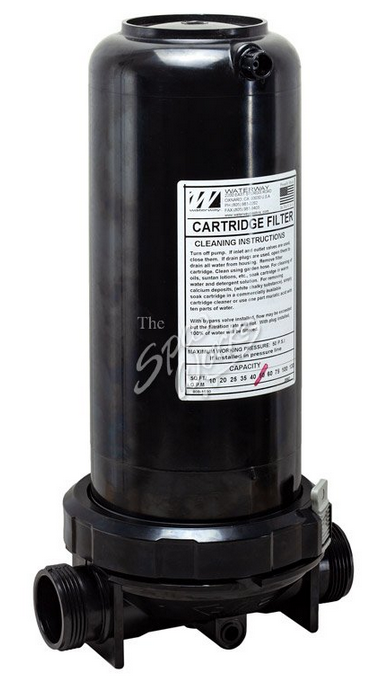

Wow - I've had my CalSpa since 1988, and I never have cleaned my spa filter more than 3 or 4 times a year.  The original design of the filter cartridge made it touch to remove the housing even after the giant plastic nut was loosened, and I'd typically have leaks even with new and lubed O-ring.  I even cut out some of the internal cover to provide additional clearance to remove the housing, see photo.  Maybe 1 dozen years ago my daughter and I installed PVC elbows to move the housing OUT of the spa cabinet so I could use an easier-to-seal filter unit, but I still would get leaks there and would need to re-seat its rubber gasket.  But it's still way easier than the original design.
