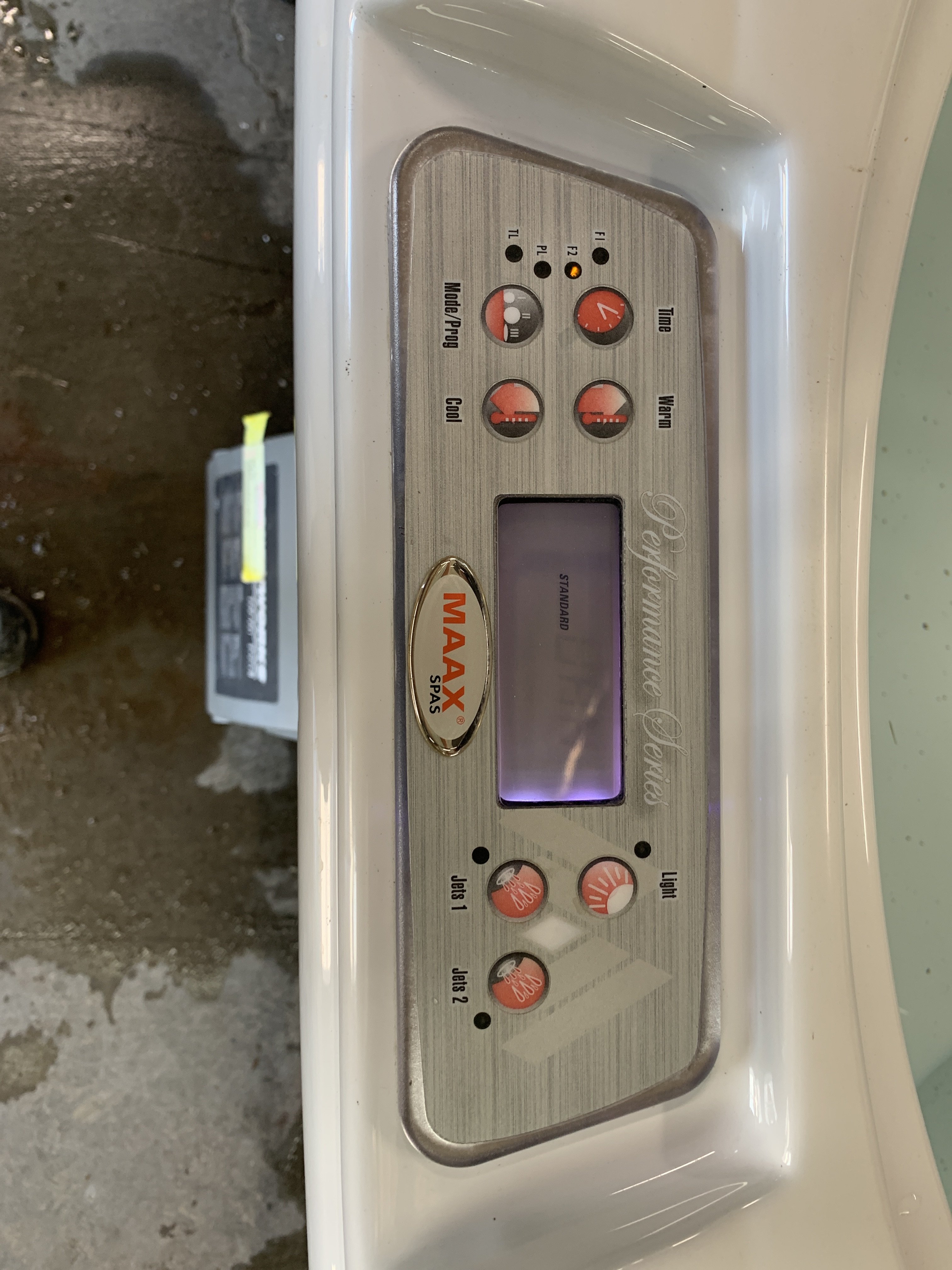

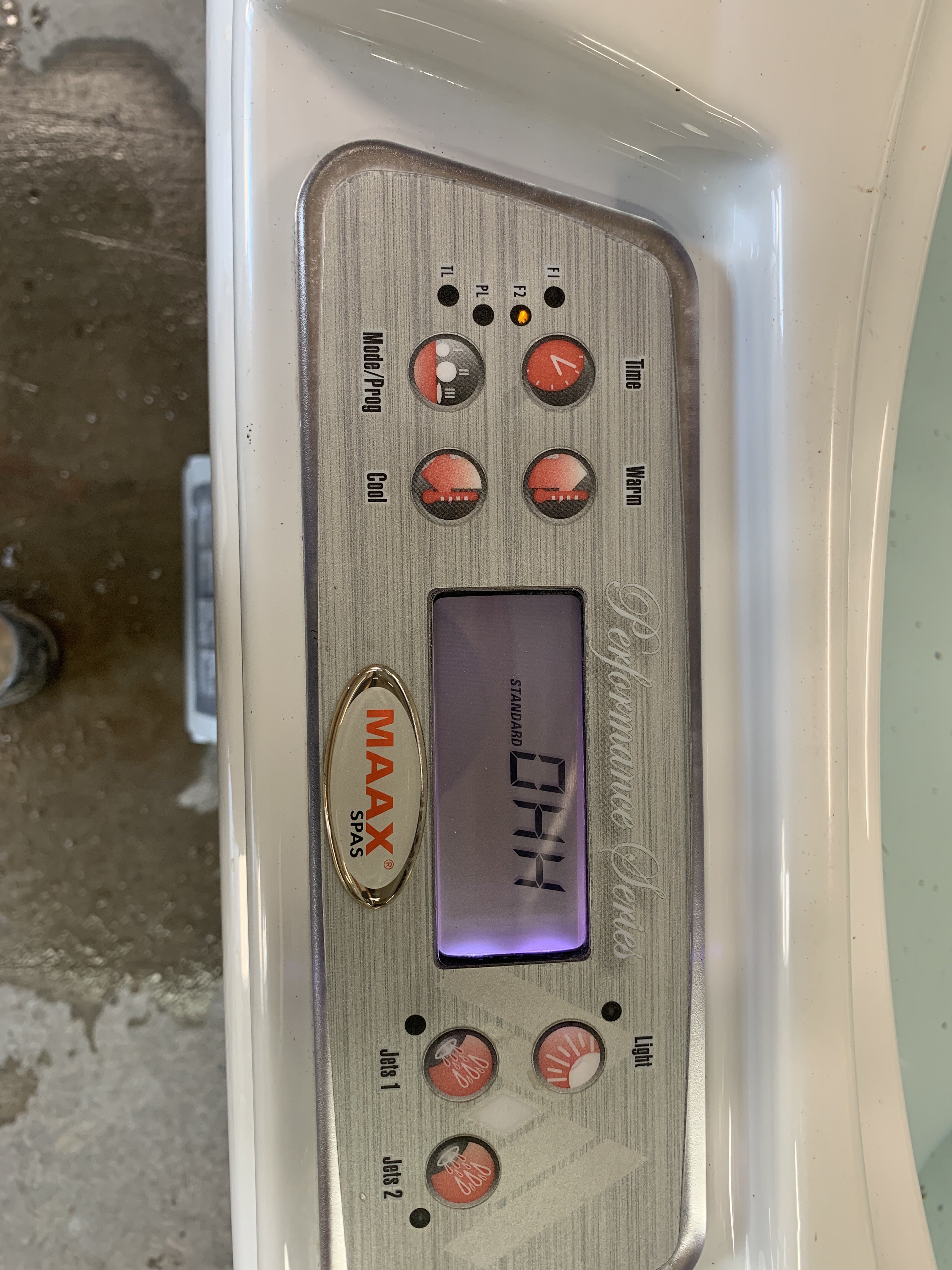

P-O Posted May 14 Report Share Posted May 14 Hello! My problem start with an HOt code. I read a similar topic here and I do a reset with my dip switch (switch A1 up) then my tub relay click 4 times and the code HOt disapear. Now I have putdown de dipswitch A1 to OFF and i have a OHH code flashing. My circulation pump runs 1 min then shot down. As i read here…i only need to wait for it and the spa will reset…i’ll wait but if you have suggestion i’ll take it! Thank you guys and sorry for my english! Quote Link to comment Share on other sites More sharing options...
P-O Posted May 14 Author Report Share Posted May 14 Quote Link to comment Share on other sites More sharing options...
CanadianSpaTech Posted May 14 Report Share Posted May 14 First remove filter and turn main power breaker off/on. Run without filter and see if error comes back. Quote Link to comment Share on other sites More sharing options...
P-O Posted May 15 Author Report Share Posted May 15 Thank you for your answer! I did it and the code is always there. 😕 Do you know if there is a trick for rebooting all the board? When I put the spa in test mode, i’m not able to do anything with the controle pad…all is locked. Thank you! Quote Link to comment Share on other sites More sharing options...

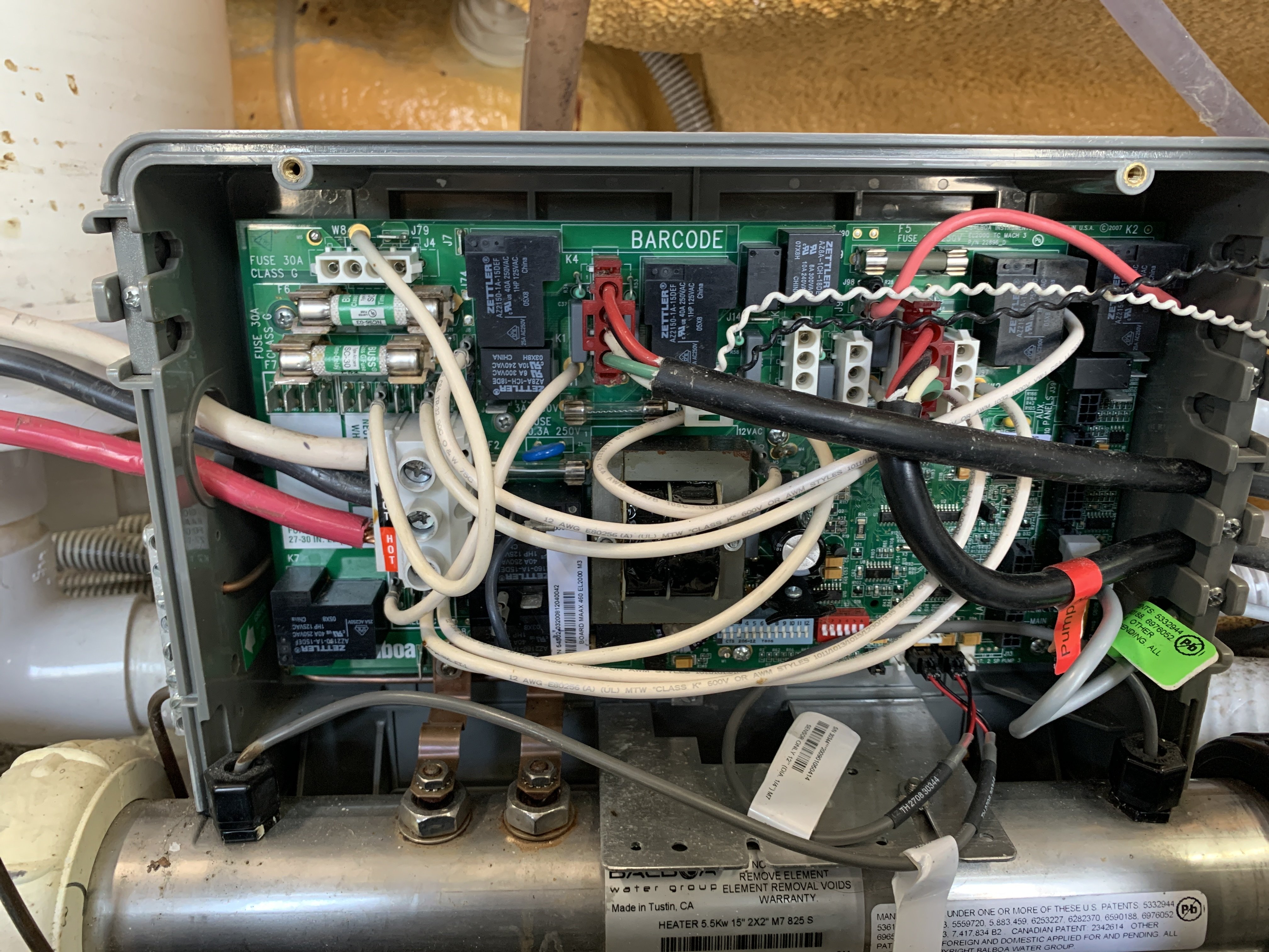

RDspaguy Posted May 15 Report Share Posted May 15 It's either a flow restriction or a sensor/heater issue. What is that brown spot on the left side sensor wire? Quote Link to comment Share on other sites More sharing options...

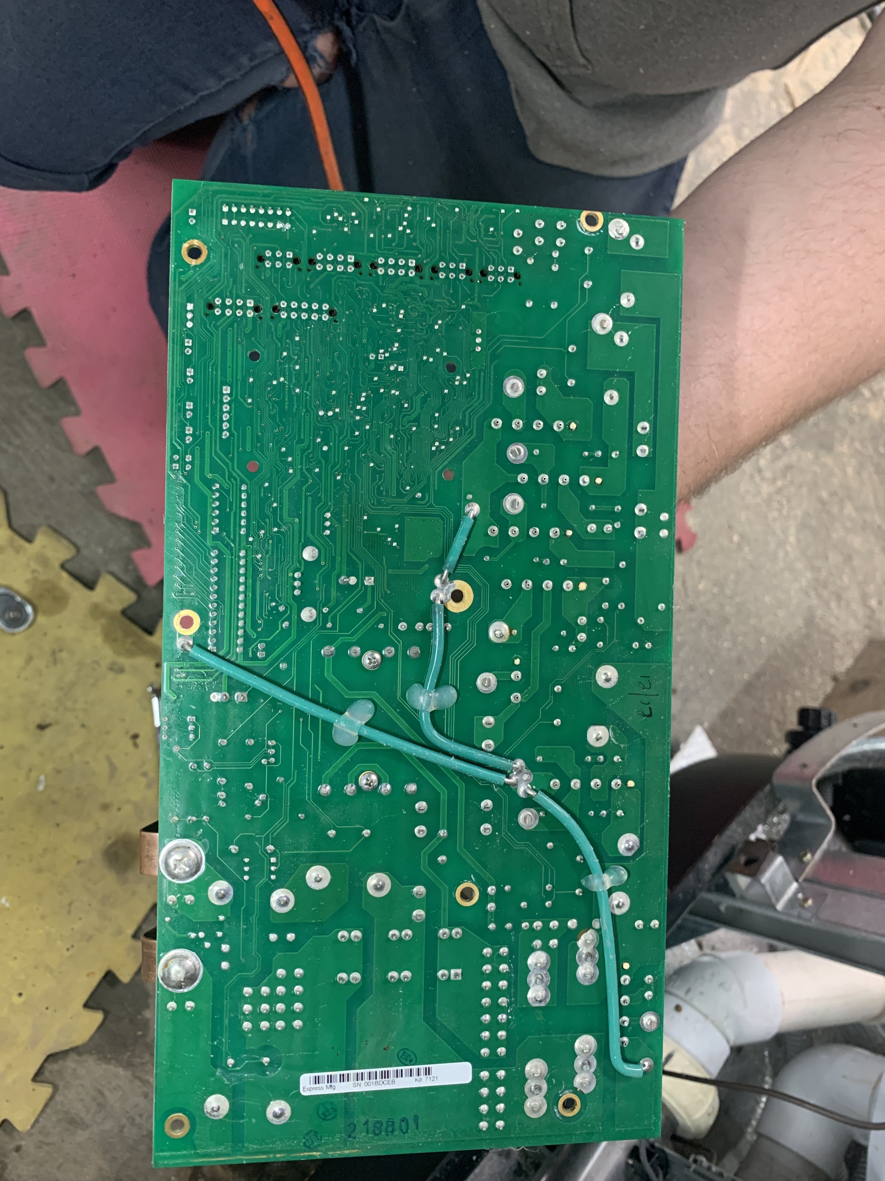

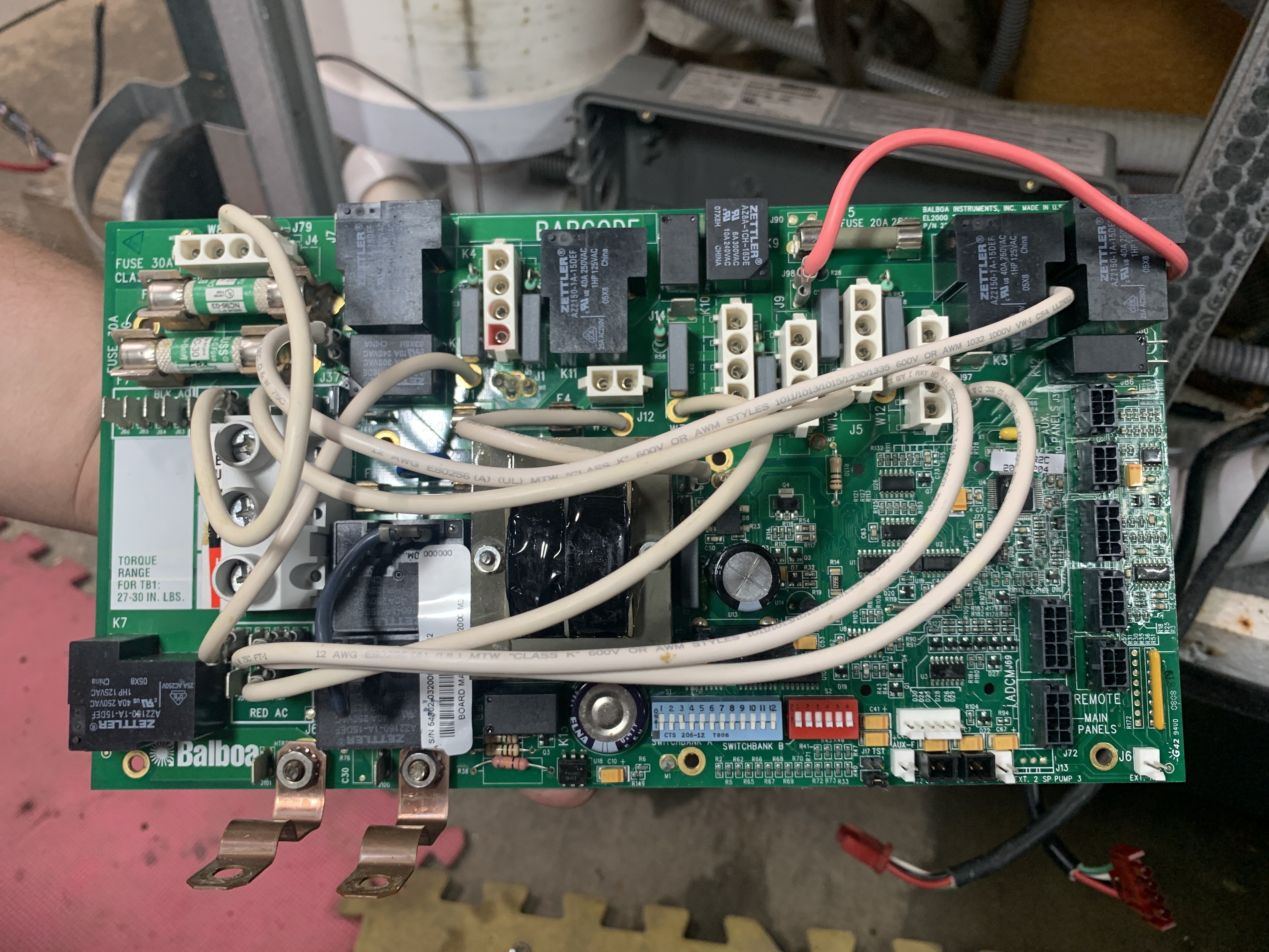

P-O Posted May 15 Author Report Share Posted May 15 I check my resistance of my sensor and all i good for both. So I take out all the board and I saw this…? What’s your bet? The spa always code OHH… Thanks guy! Quote Link to comment Share on other sites More sharing options...
P-O Posted May 16 Author Report Share Posted May 16 I check the heater relay with my finger on the surface and the relay is clicking…that sound like i need a new board…:/ Quote Link to comment Share on other sites More sharing options...
RDspaguy Posted May 17 Report Share Posted May 17 On 5/15/2023 at 5:49 PM, P-O said: good for both. What were the readings? Why remove the board? Did you secure the nut beneath the heater tab before loosening the nut on top? Be sure to do so on installation as it can twist the terminal post and crack the seal, leading to heater failure. On 5/14/2023 at 9:11 PM, RDspaguy said: It's either a flow restriction or a sensor/heater issue. If it's not a sensor... Do you have good flow from the heat return? Remove heater tube and look inside for scale/debris. One sensor is very close to the element, and a buildup connecting them can lead to a sensor error. Quote Link to comment Share on other sites More sharing options...

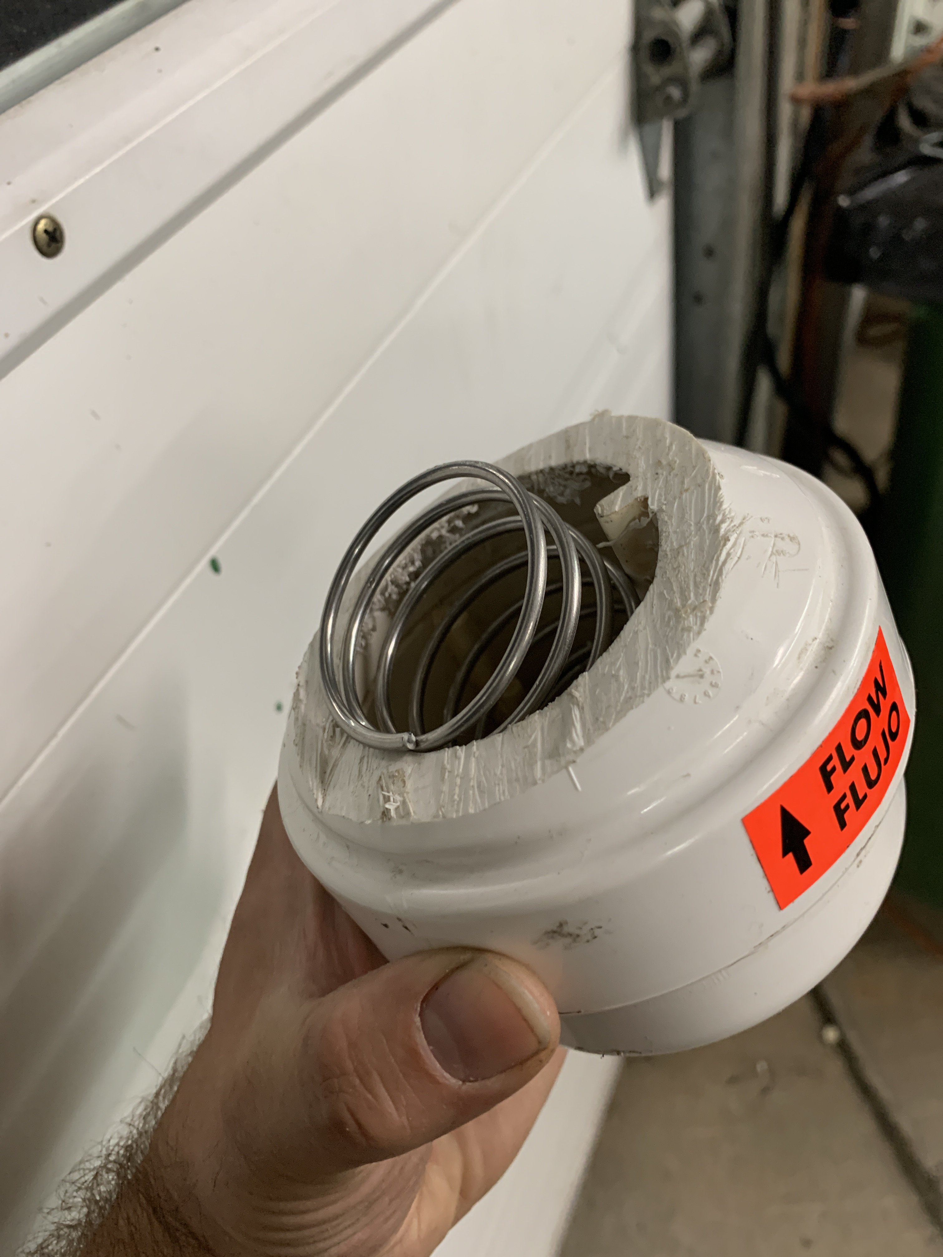

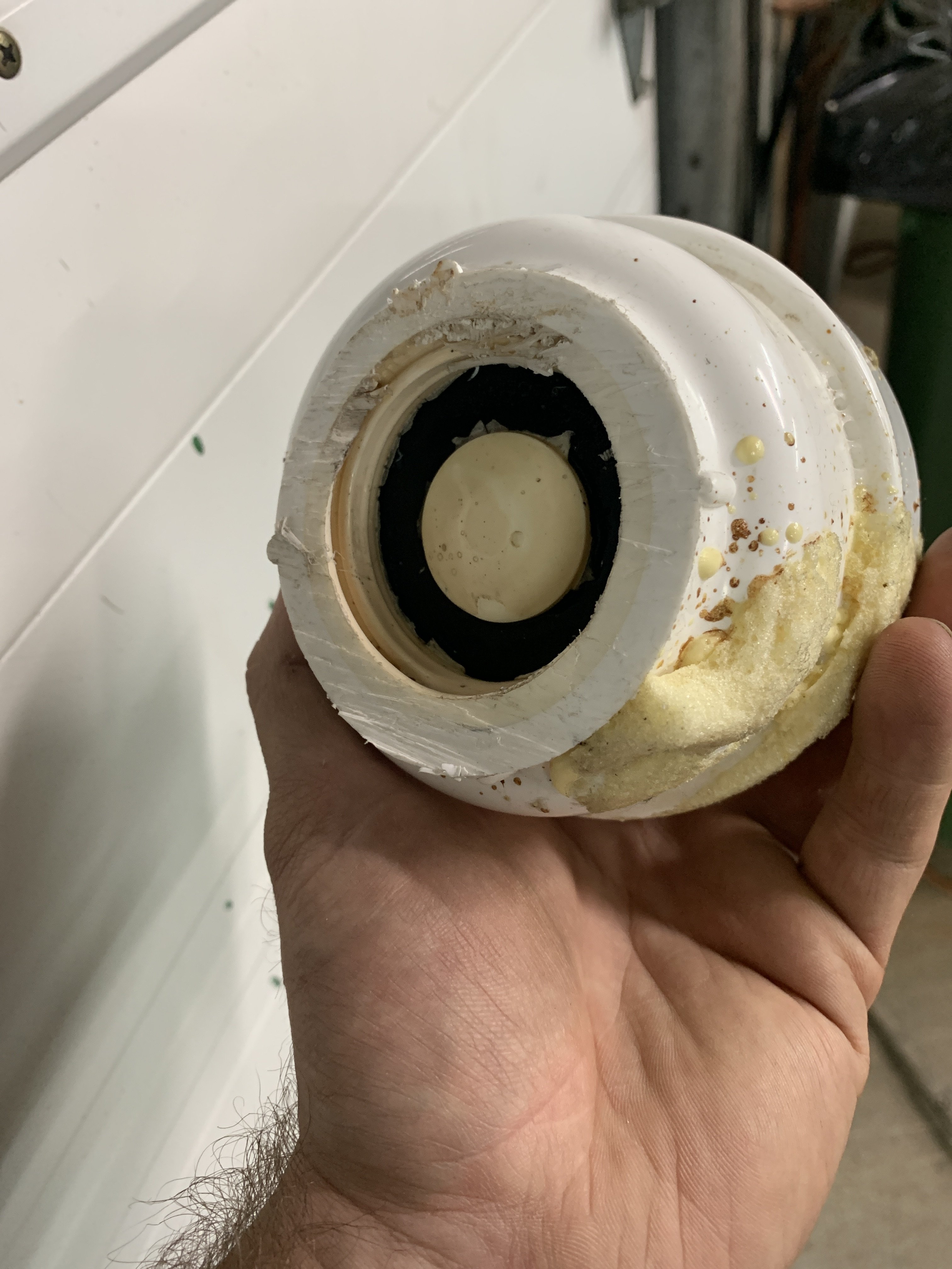

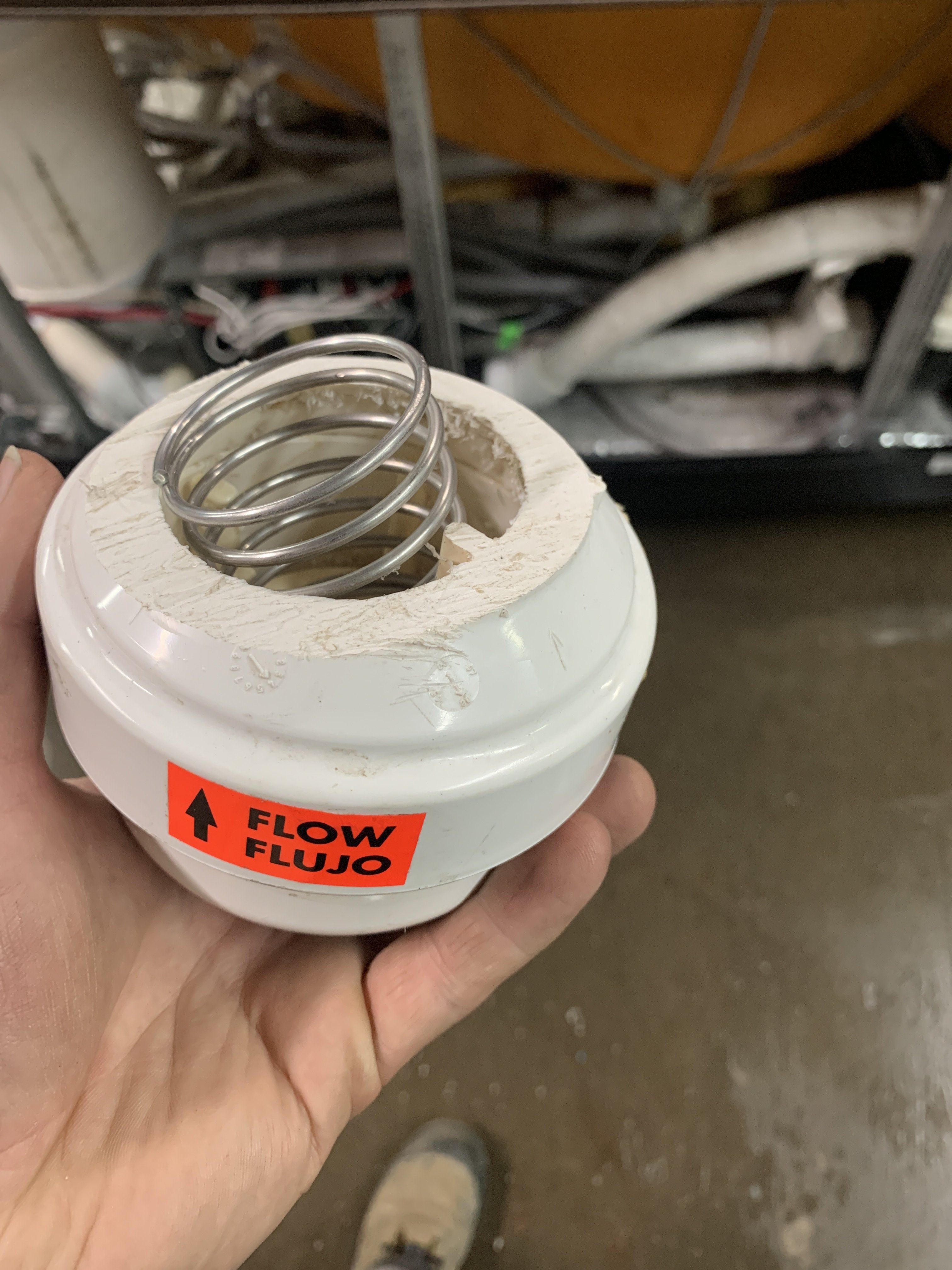

P-O 2 Posted May 25 Report Share Posted May 25 Hello! Thanks for your answer! So here i am….I called a new Pcboard…and 6 hours later the SAME CODE COME BACK 😪😪😪OHH…. So a lot of you talk about flow…i putt some air in the jets, and i by pass the flow ball (see picture)… and nothing to do…my spa is still locked in OHH…i’m deseperate…the board cost to me 750$!!!! Quote Link to comment Share on other sites More sharing options...
