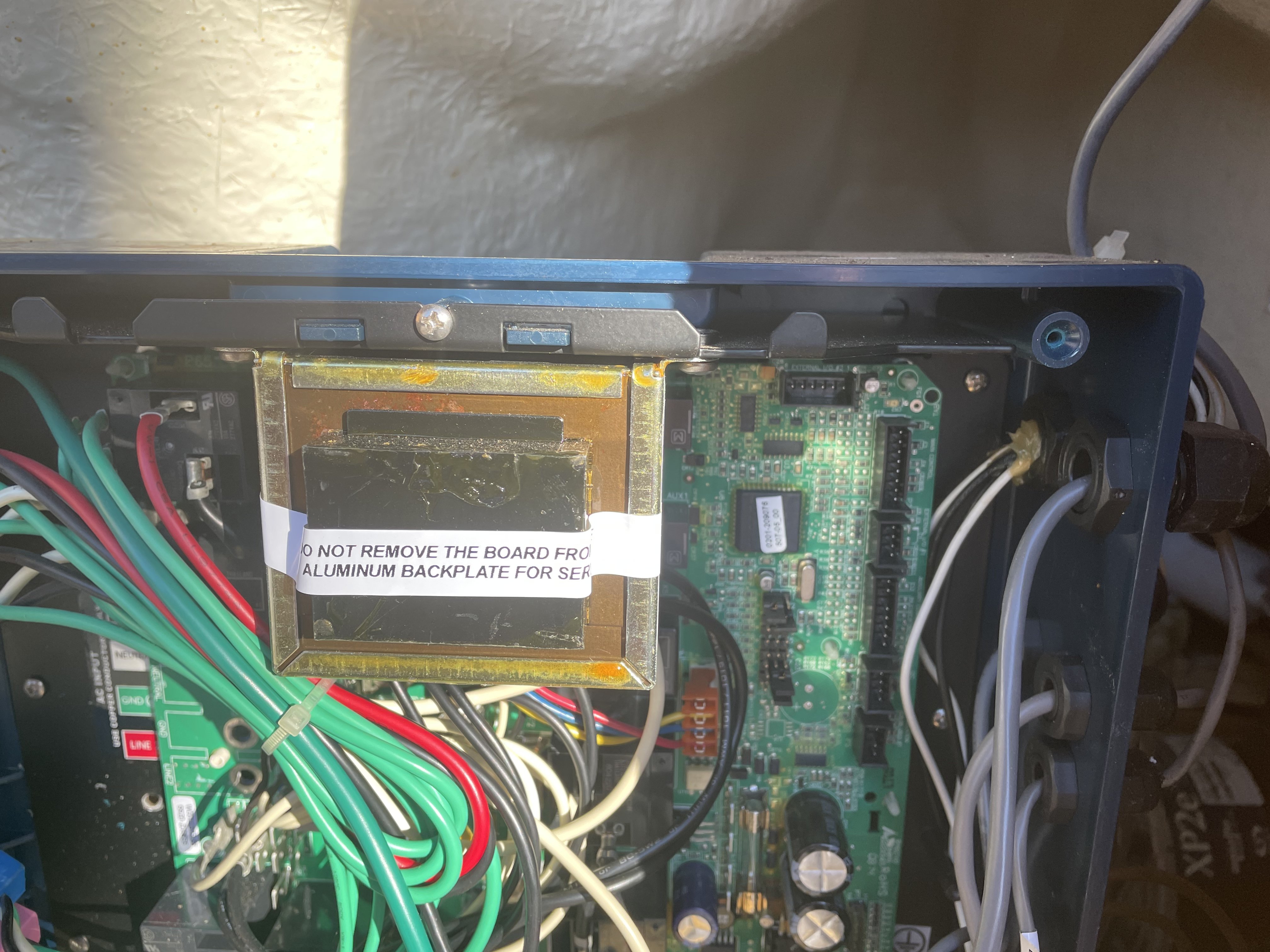

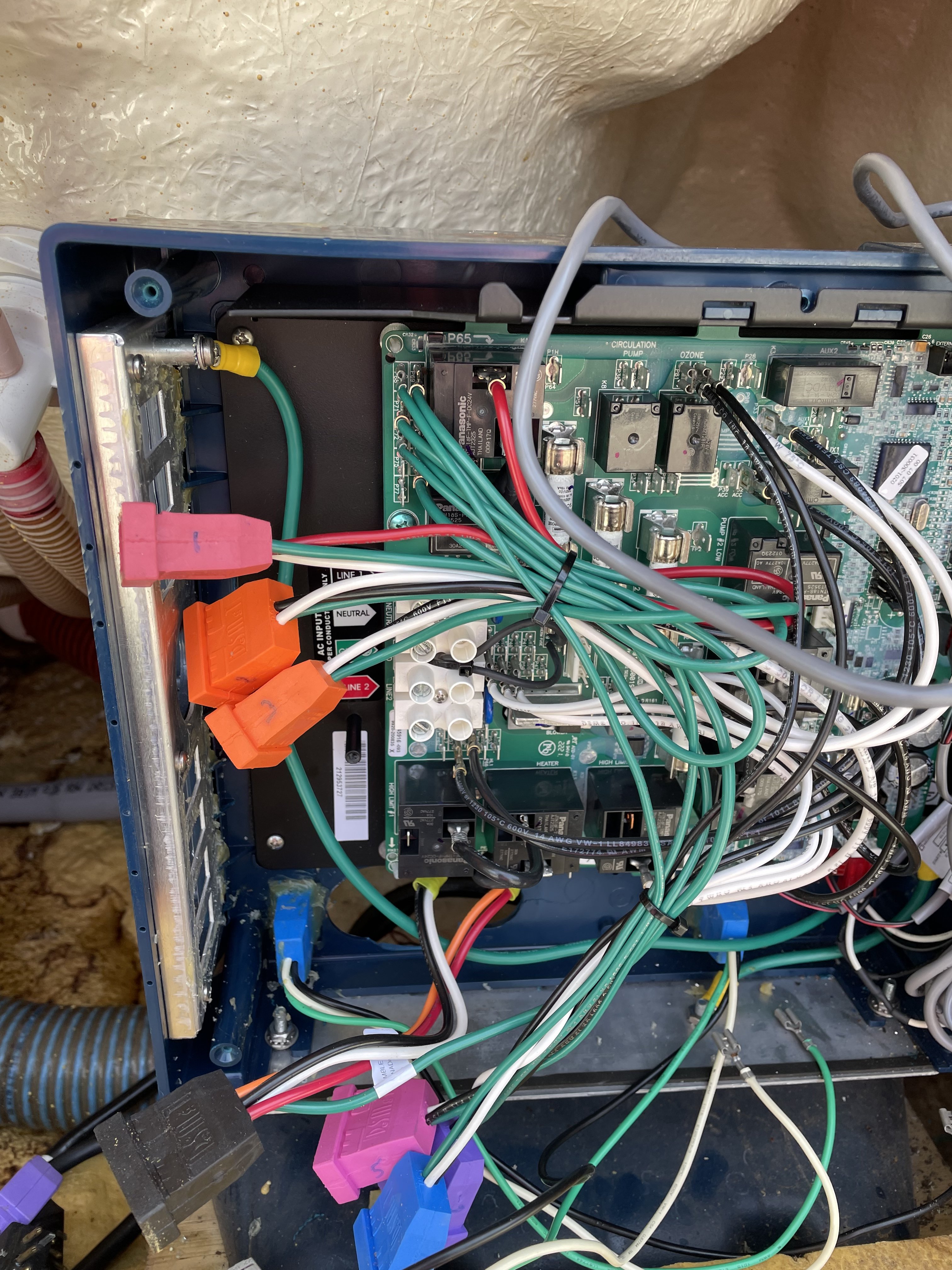

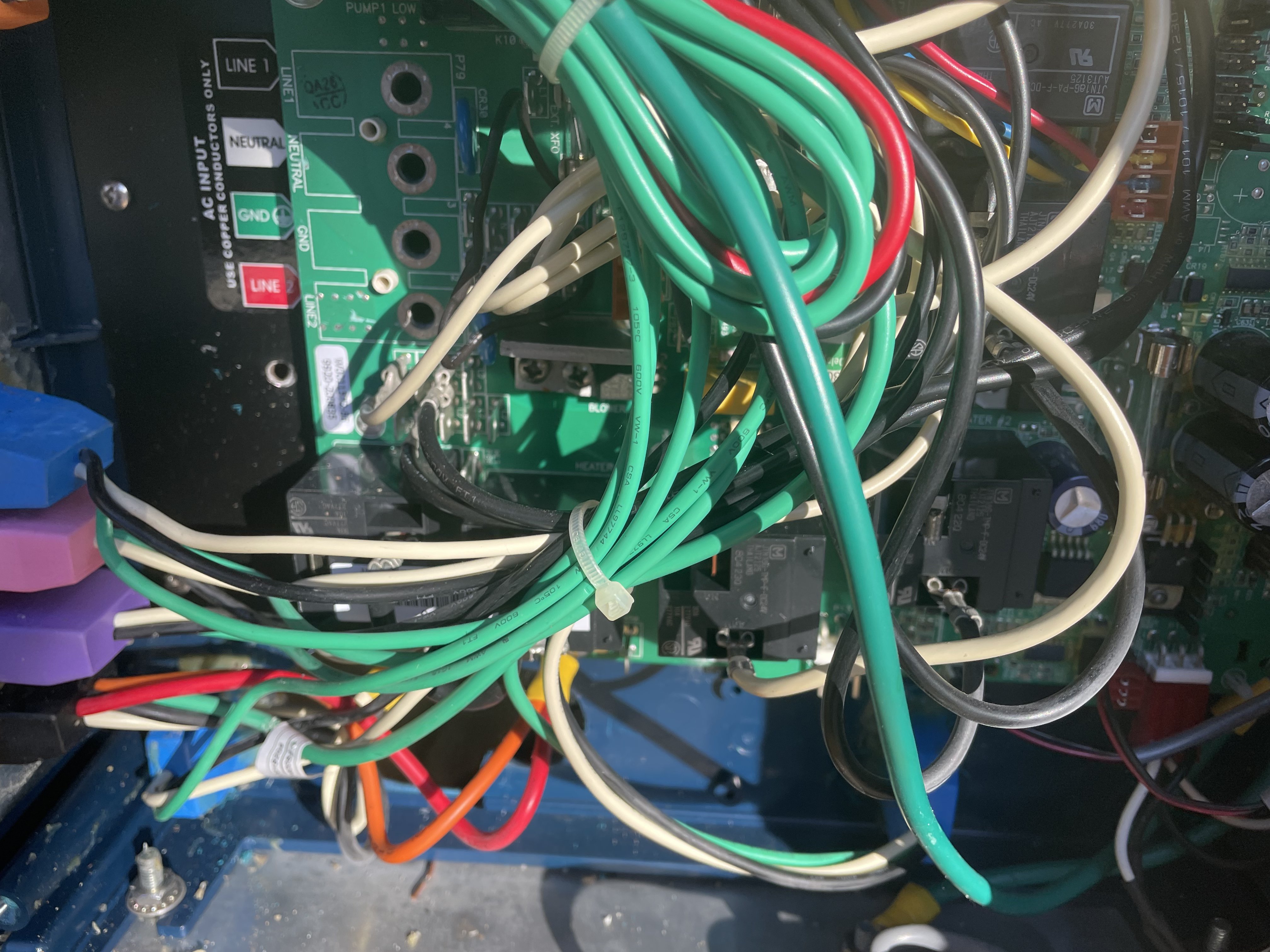

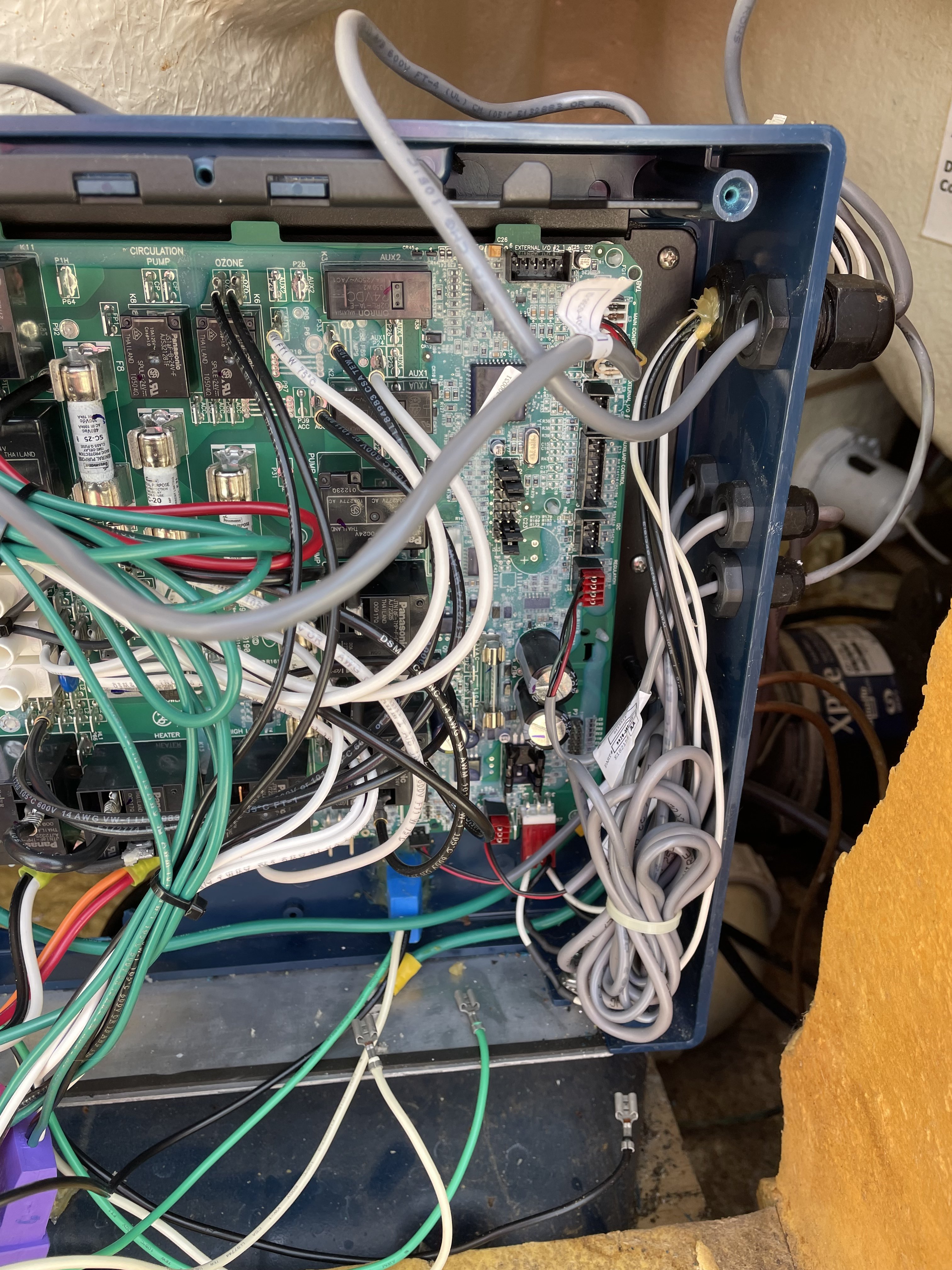

CardiffKid Posted May 12 Report Share Posted May 12 Hello all, I recently acquired an Arctic Spa hot tub. I had to replace the motherboard because the main power lugs were broken. No idea how it happened. Mothers handyman disconnected it. No telltale signs of arcing on old board. When I turn power on, nothing happens. I have 240 at board and 120 individually at board. 2 power lines, ground and neutral. I have power at various relays on the board. No power to control panel at all. Swapped with known good panel and still nothing. Control panel disconnected results in nothing. I am a beginner with a multimeter but am pretty good at following directions! I have not checked transformer or heater.I included pics of transformer and a couple of new board and old where you can see power lugs broken out. Any guidance would be much appreciated! Quote Link to comment Share on other sites More sharing options...

CanadianSpaTech Posted May 13 Report Share Posted May 13 MSPA Tech Manual. See page 40 here: https://www.geckodepot.com/fichiers/documentsProduits/GDA/en/Serv_Man_M_CLASS_EN.pdf Need to test for power into and out of the transformer. Quote Link to comment Share on other sites More sharing options...
CardiffKid Posted May 13 Author Report Share Posted May 13 New info. Transformer was plugged in to wrong pins. I’m plugged in to correct pins now and GFi trips. New transformer or anything to test before I get a new transformer? Quote Link to comment Share on other sites More sharing options...
