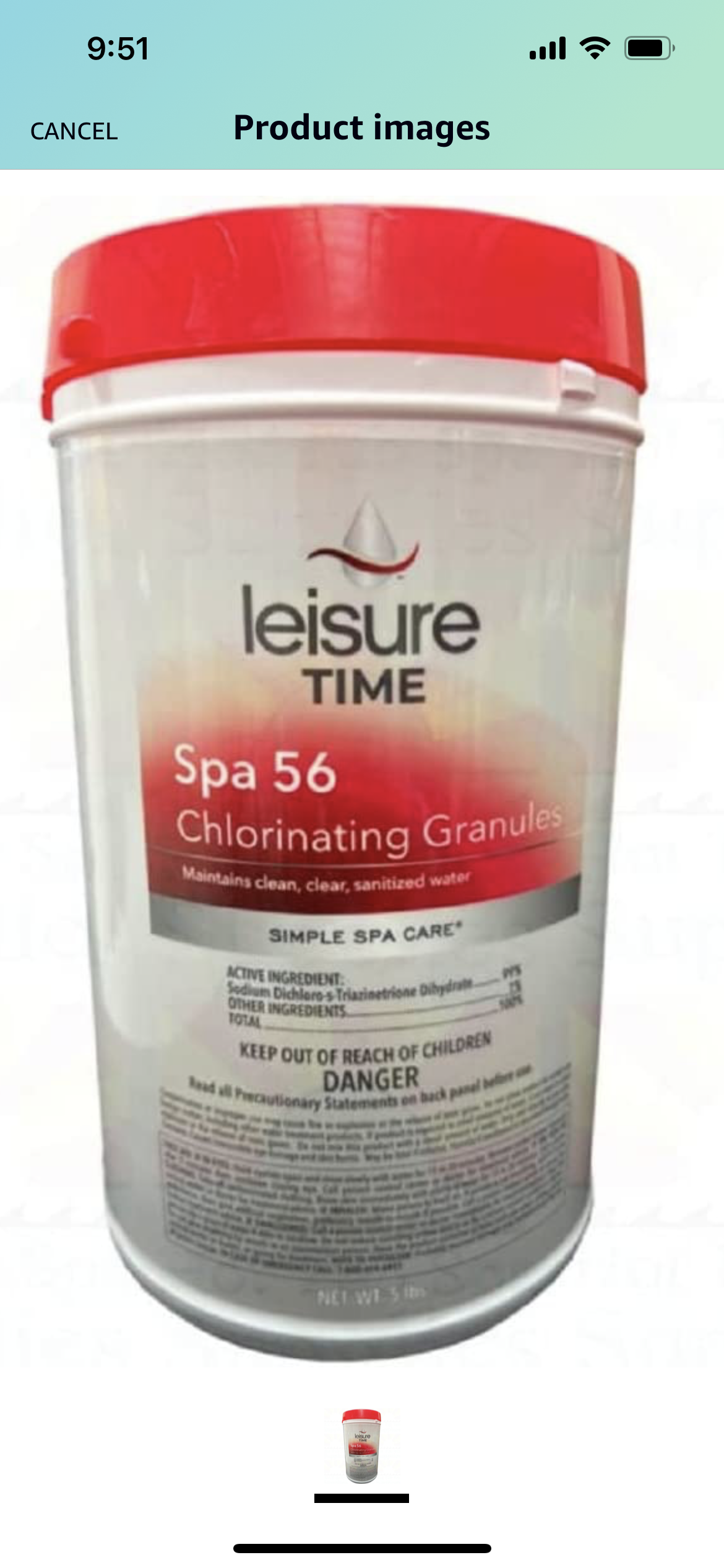

ItchyandFrustrated Posted March 16 Author Report Share Posted March 16 Thanks again. It’s amazing how little guidance we were given when we purchased this. I maintain a 30,000 gallon in-ground swimming pool all summer and I expected the hot tub to be easier but it is, in fact, the opposite. Obviously, our sanitizer (or lack there of) is the issue. I will lower the pH and start checking the chlorine daily before we enter the pool. What level do I you keep your chlorine. The test strips say 1-3 but I’m now being told to keep the chlorine much higher around 5-10. Also, I know you said you add 10-15ppm of chlorine after each use but what does that translate to in a unit of measurement (say a tablespoon). I will review the stickies and I’m sure they explain the bleach but when do you add that on top of the chlorine? I’ve included a photo of the chlorine I have. If there’s something different/better that I need, please let me know. I’d buy/pay anything to be able to get back to soaking! I can’t thank you enough for your willingness to help. Quote Link to comment Share on other sites More sharing options...

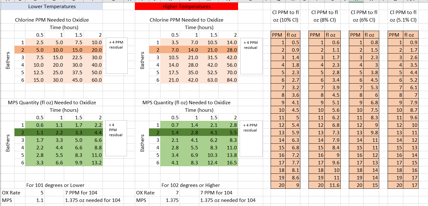

dashmer Posted March 16 Report Share Posted March 16 The recommended range for free chlorine is 3-5 PPM. You are looking for a residual Cl in your hot tub the next day after your soak the previous day that is in this range or perhaps a little lower. For amounts you should use the pool calculator located here: https://www.poolcalculator.com/calculator/ You specify the gallons in your tub and it will tell you how much you need to add to reach your target. I made this chart to have handy to the tub that would help me know how much chlorine was needed after a soak (based on 360 gal): Have a look at the top left two orange charts. They tell me that I need to add about 10 ppm of Cl for a one hour soak for 2 people if a "cooler tub", say around 100 degrees. For a hotter tub (104) the chart says 14 ppm for the same soak. I use liquid pool chlorine (as my bleach, in the dichlor then bleach) so I take 10 ppm + 4 for residual (total 14 ppm) and I look in the orange columns on the right. When my liquid chlorine is new and at 10% strength, I would put 6.3 fl oz of it in the tub when I get out. If you are using Cl granules as in your picture above, 1 fl oz gives you 12 ppm Cl and 10 ppm CYA. All of my numbers are for a 360 gal tub. You should find your Cl in that 3-5 ppm range the next day. If higher or lower than that, you need to add more or less Cl when you get out on the previous day. Chlorine granules are referred to as dichlor. If you use just dichlor you will build up CYA really fast and will need to changed your water every month or so. That is why the dichlor then bleach method was created. You only use dichlor until you get to 30ppm CYA and then you switch to bleach (that contains no CYA). I am not familiar with the frog system and the information I am giving you does not have any other Cl sources. If you would like to try this method, you should remove your frog system. You need to read the section on setting up for dichlor then bleach as it requires your TA to be quite low. Good luck. Quote Link to comment Share on other sites More sharing options...
