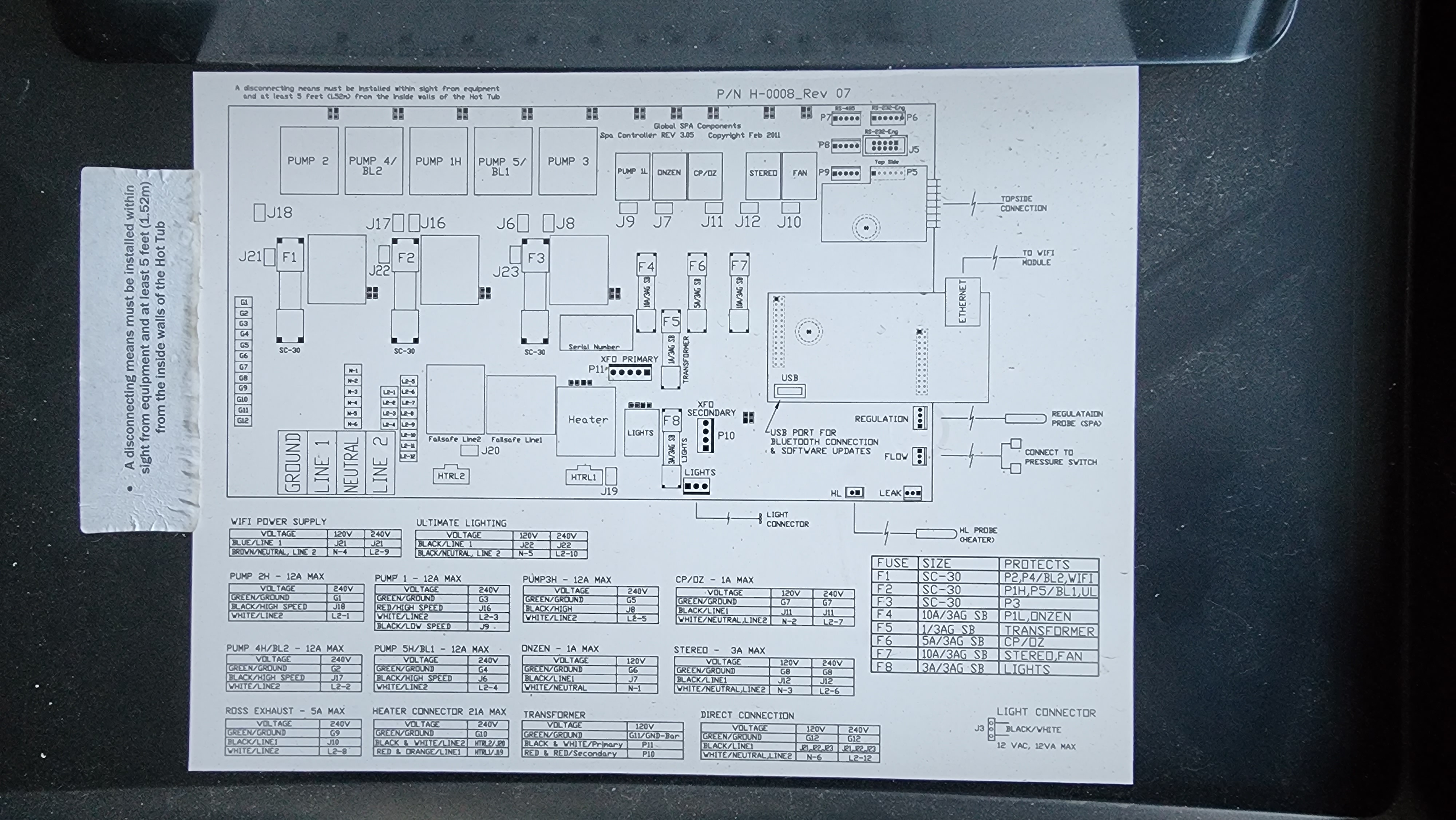

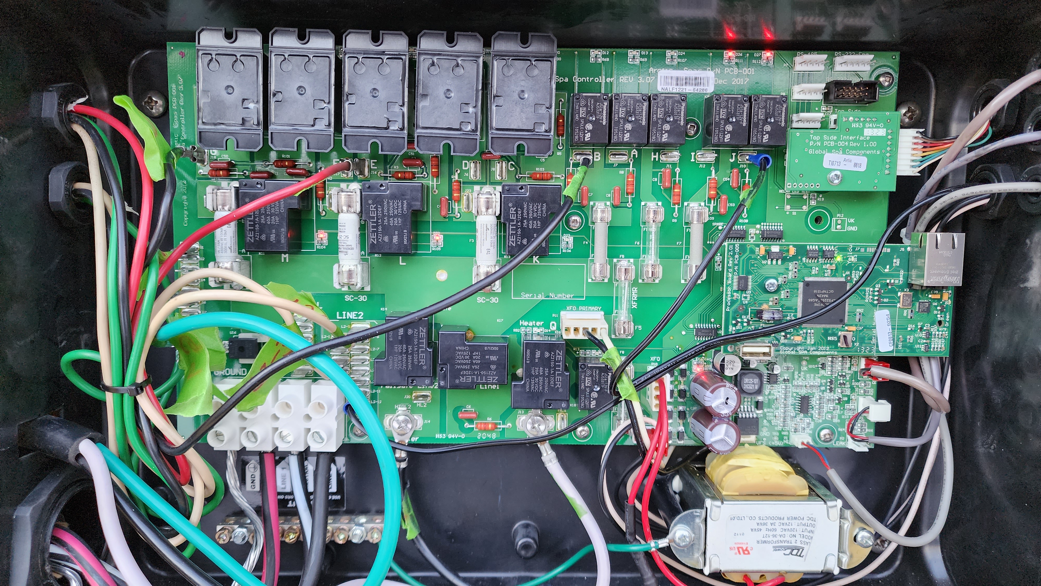

Anyone have any advice on what might be the issue? It seems like the spa just keeps running forever once it starts its filter cycle. Would this be an issue with the pump 1 low relay? Unfortunately, that relay is one of the ones that is soldered onto the board. There are five relays that can be swapped out but it doesn't look like any of them are related to pump 1 low. I've tried changing out Pump4/BL2 and Pump5/BL1 (just randomly trying different relays) but that didn't seem to change anything. Here are a couple picture of the board and diagram. The led "D19" next to the capacitor on the bottom right is always lite up, not sure if that means anything?
