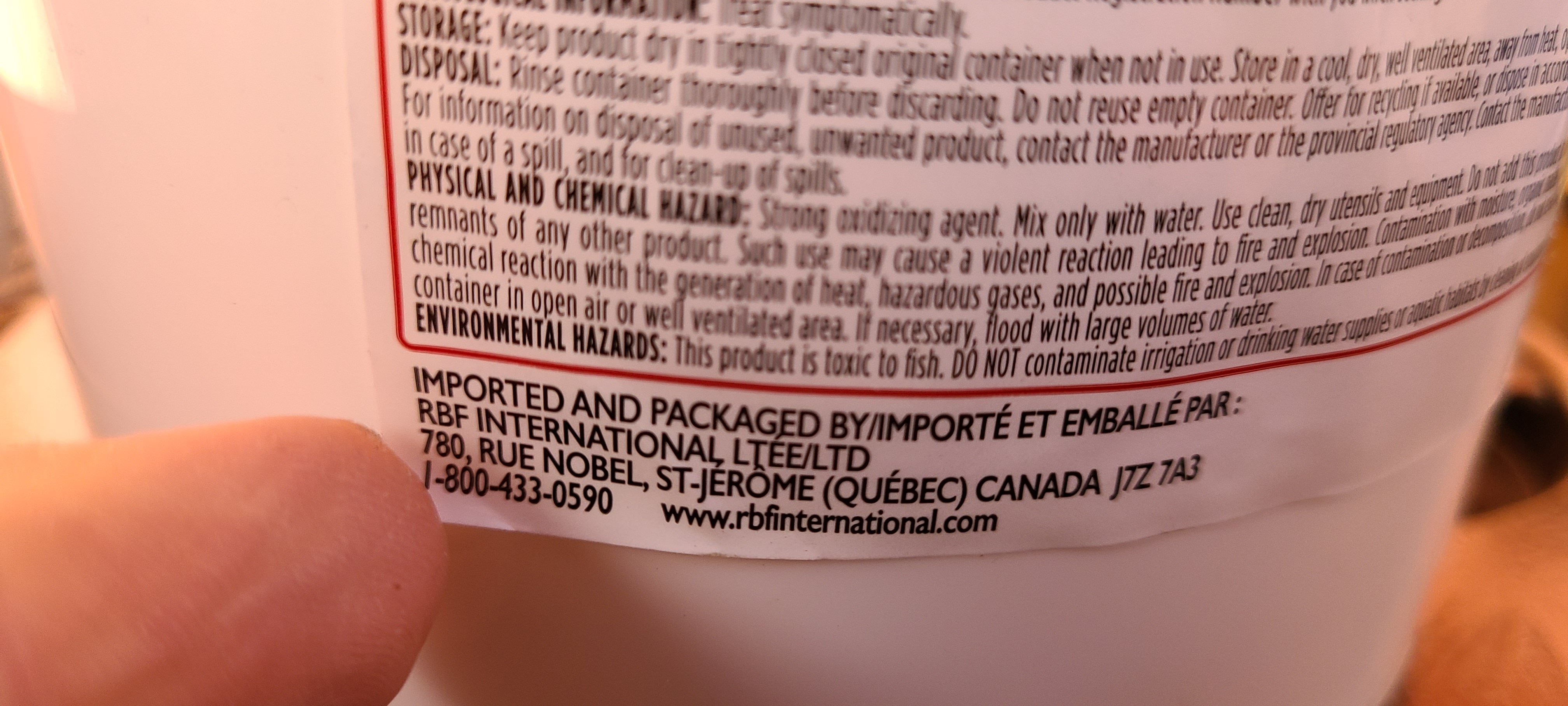

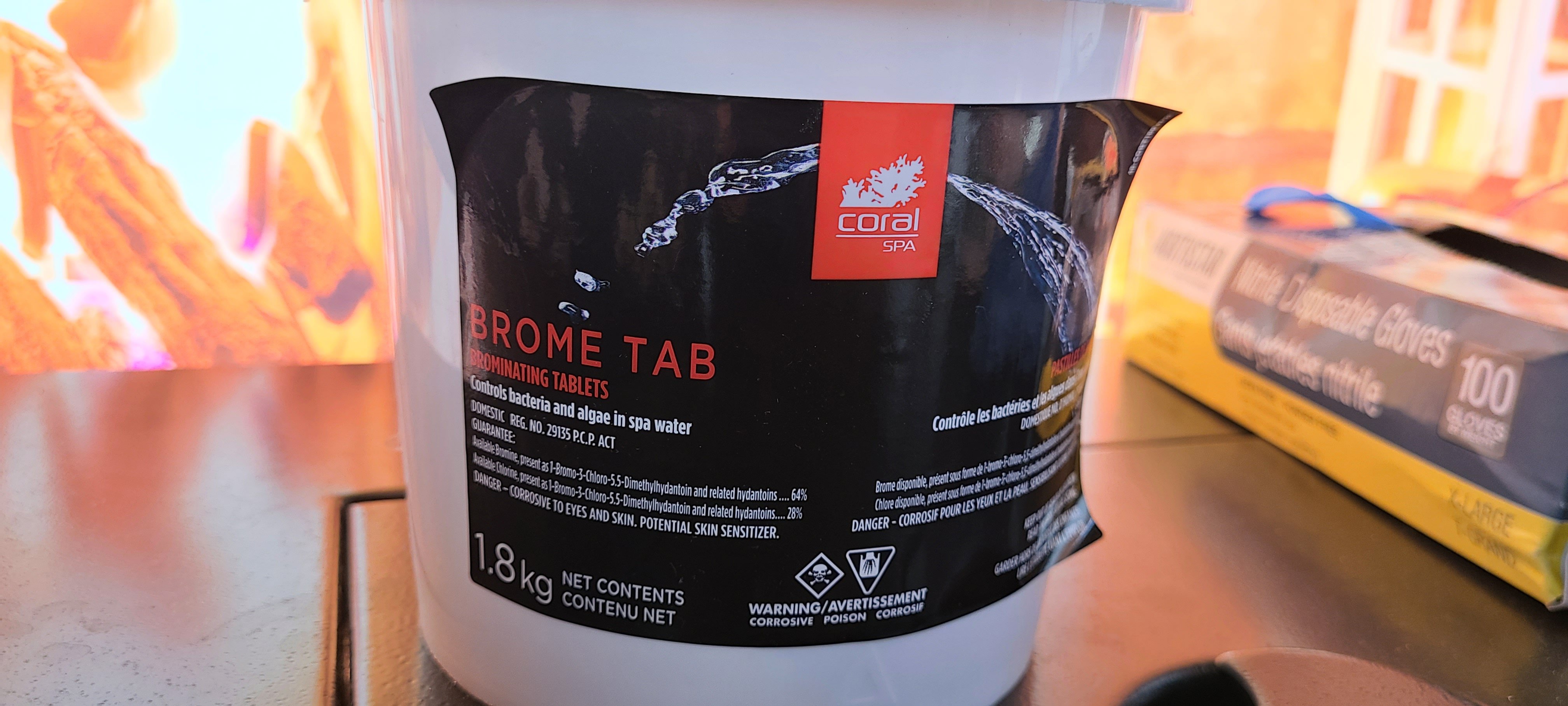

PolarisRich Posted February 7 Author Report Share Posted February 7 I went back into my local spa store today with bucket in hand and asked for the manager and the owner. I told them my story of what happened and they had an extremely surprised look on their face. The manager opened the bucket of bromine and took a smell and said 100% this is chlorine pucks. My problem with that statement is that some of the pucks lasted 3 to 5 days and others less than 2 hours. I thought it was very unsafe if chlorine and bromine tablets were mixed in the same bucket. My best guess is that the mixture in the bromine pucks we're wrong. The owner and the manager went over to the Shelf and took off five buckets and open the tamper proof seals and smelled them. Three out of the five buckets smell like chlorine the other two had almost no smell. They then decided to pull all bromine pails off their Shelf and stop sales of that brand. I gave them my name and phone number because I wanted to hear what the outcome will be when they contact their supplier. They wanted to compensate me for this incident by giving me two buckets of a different brand of bromine tablets. They also said that they will get back in touch with me after they get done talking to their supplier. Quote Link to comment Share on other sites More sharing options...
PolarisRich Posted February 7 Author Report Share Posted February 7 This is the product that I purchased that has the questionable puck! Quote Link to comment Share on other sites More sharing options...

PolarisRich Posted February 9 Author Report Share Posted February 9 RBF International just contacted me to let me know what they're findings were into the investigation of what happened. The representative that I talk to was a very nice fellow and seem to be very knowledgeable about the incident and about their different product lines. He was also in contact with my local spa store immediately after receiving my email. He and his team went and searched for the buckets with the same date codes and lot number to find that the product was mislabeled and was also a product for a different Brand other than Coral spas. He said after their testing they found that the product that was in the bucket was NOT Bromide but a form of Dichlor, the quick-dissolving puck formulation used for shocking hottubs. He mentioned that they dissolve almost instantly when in contact with water. That seems to be what had happened but he could not explain why the first couple pucks I used took three to five days to dissolve. He then went on to explain that it's "near" impossible that the bucket was mixed with standard chlorine pucks but not 100% impossible. He then asked for my address to send me a compensation package for my troubles. Whatever that may be I won't know until it comes in. Quote Link to comment Share on other sites More sharing options...
