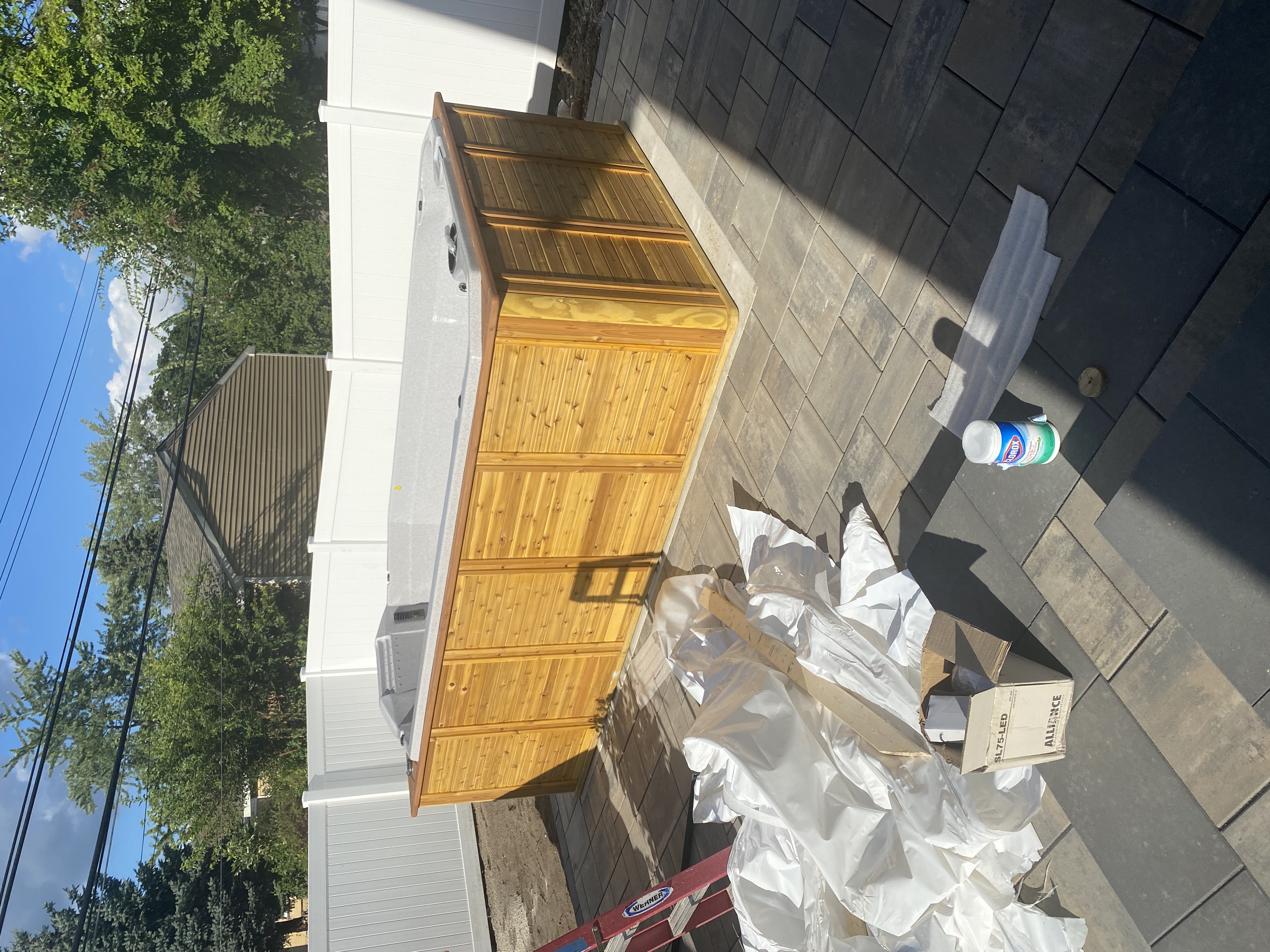

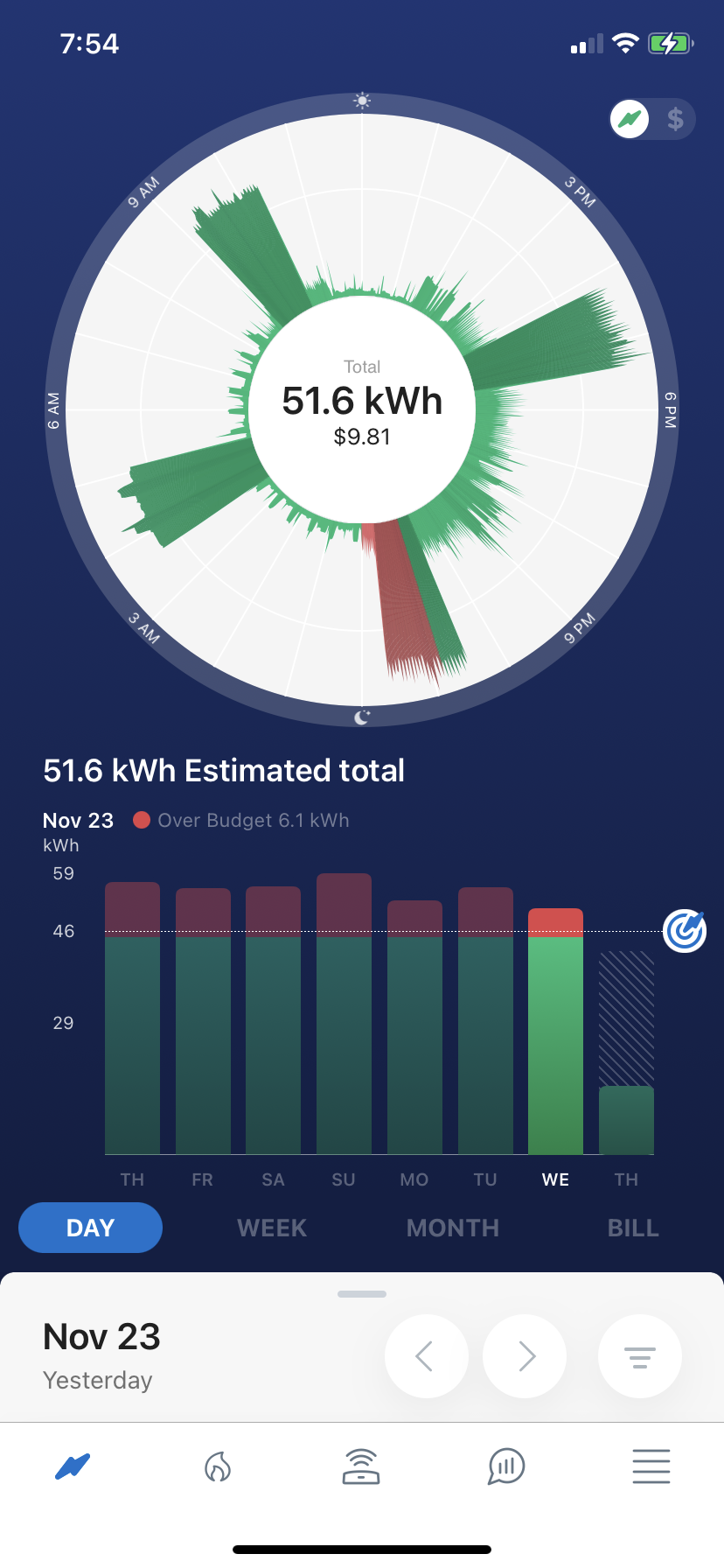

I purchased a spa from SwimSpaManufactures based in Florida this July.  Unfortunately I did not do my homework well enough and purchased a spa with no insulation.  Idiotic move, I’m the biggest dummy don’t need to tell me that, but they certainly did a share of lying and being new to this industry I was very trusting seeing they had been in business 30+ years.  They pushed how energy efficient their tubs were and now I’m spending 341-400 a month on electricity.  My previous bill in the same month last year was 115 and it was colder.  With the hot tub I’m spending around 260-300 more a month.  I have had the spa insulated with little difference.  So instead of the heater in standard mode kicking on 5 to 6 times a day it kicks on 4 times a day.  It takes 1.5 hours to heat it 1 degree and loses 1 degree every 4-5 hours.   So you can see quickly it’s completely useless if I put it in economy or sleep mode because it loses heat faster than gaining.  By the time the 12 hour cycle goes by it’s losses about 2-3 degrees.  And it does not matter if its at 80 98 100 102, when that heater kicks on in standard mode it turns on 4 times a day running at 1.5 hours it cost around 7-9 dollars(for the heater and this is only if I’m not in the spa and it’s completely sealed up cover on tarps closed.  About $1.28 hour again if it’s not in use. I have a 6KW heater 240 voltage exchange a balboa 500sz system.  What is up with this,  I’m hearing 30-50 a month difference from people with swim spas.  I have 8ft by 14ft holds 1200 gallons. It’s stuff with insulation, it came with a decent cover I don’t see any heat lost coming from the top.  I have tarps surrounding the sides, it’s under a pergola so the top is open.  But I just want to know if the spa itself is just junk or if the cost is correct.  I saw one forum out there where a guy said it could cost 100-200 to run a spa.  And one more thing it takes 1.5 hours to take it up 1 degree and the cavity is now filled with insulation.  Forums are reading I should get 3 degrees an hour with the kind of heater I have.  I that to say should it be this way? Picture of spa below.  Cedar wood cabinet.

I’m in Southeastern part of Michigan about 30min from Canadian border.  I put the pink fiberglass insulation owens Corning R33, nine inches thick with reflective insulation surrounding with 3/4 inch gap to create a radiant barrier. The vinyl surrounding my pergola is Marine grade 20mil to help with wind blockage.

The filter cycle I have set runs for 2 hours every 12hour.  I’ve run the filter cycles on sleep mode to keep the heater off and noticed filtering takes very little energy almost unnoticeable. But the heat loss is so fast that it’s not useable in sleep or economy mode.  The money saved from running in economy quickly is used.  I ran a test paid 4 dollars a day in economy mode over a course of 4 days that was about 16 dollars of savings.  However it dropped 4 degrees during that time.  I had to run it 6-7 hours to get it back to the normal temp -that cost $8.  Getting in cost 4 (jets running heat on) and then it had to warm back up from top being off and heat lost cost 4 dollars.  $16 dollars savings gone and had to wait to get into tub.  So yeah not fun.  But I’ve never heard of the camera I will look into it.  Thanks
