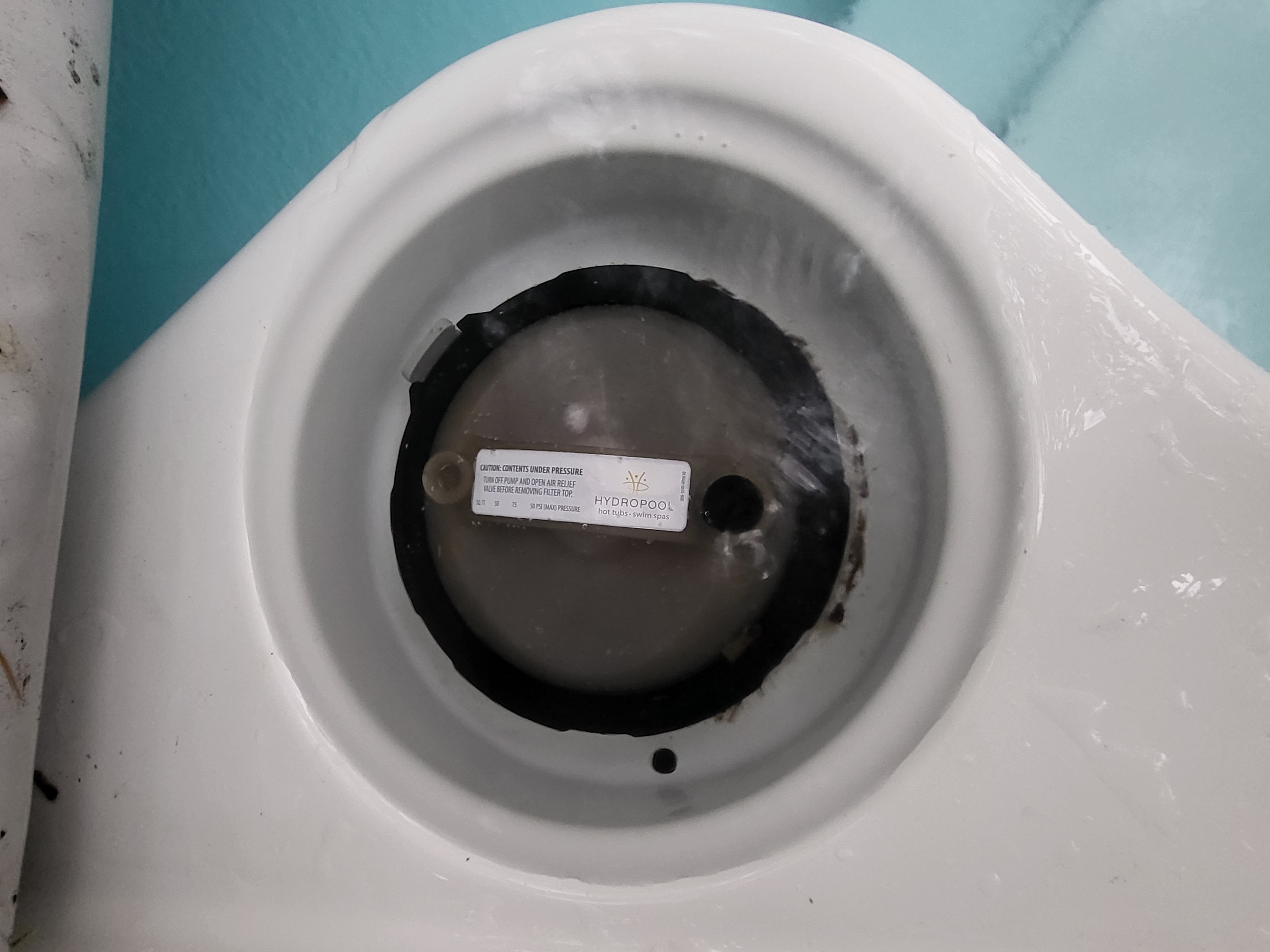

justinmd Posted October 31, 2022 Report Share Posted October 31, 2022 I overfilled the tub on accident. Once I drained it, water is constantly coming out of this hole in the filter cartridge reservoir. In the picture, the water is coming from the little hole shown below the filter cartridge. I don't believe water was coming from it before because it never filled up with water before other than when water came in from splashing etc.... Any help would be greatly appreciated. Quote Link to comment Share on other sites More sharing options...

RDspaguy Posted October 31, 2022 Report Share Posted October 31, 2022 That is a drain line, and usually goes to the ground, or to a jet air intake or mazzie valve. If it is pumping water out then you have a blocked or broken jet or mazzie. 1 Quote Link to comment Share on other sites More sharing options...
justinmd Posted November 1, 2022 Author Report Share Posted November 1, 2022 3 hours ago, RDspaguy said: That is a drain line, and usually goes to the ground, or to a jet air intake or mazzie valve. If it is pumping water out then you have a blocked or broken jet or mazzie. Thank you for the reply. Is this an easy fix? Quote Link to comment Share on other sites More sharing options...
justinmd Posted November 1, 2022 Author Report Share Posted November 1, 2022 3 hours ago, RDspaguy said: That is a drain line, and usually goes to the ground, or to a jet air intake or mazzie valve. If it is pumping water out then you have a blocked or broken jet or mazzie. Actually, I bet it's clogged with pine needles. I live in a very foresty area and I am constantly battling pine needles. Is there a simple way to clear it out? Quote Link to comment Share on other sites More sharing options...

justinmd Posted November 5, 2022 Author Report Share Posted November 5, 2022 On 10/31/2022 at 2:15 PM, RDspaguy said: That is a drain line, and usually goes to the ground, or to a jet air intake or mazzie valve. If it is pumping water out then you have a blocked or broken jet or mazzie. I just used my compressor and ran air through it and it worked Quote Link to comment Share on other sites More sharing options...
RDspaguy Posted November 6, 2022 Report Share Posted November 6, 2022 On 11/5/2022 at 4:52 PM, justinmd said: I just used my compressor and ran air through it and it worked Great! Ran air through what, exactly? Quote Link to comment Share on other sites More sharing options...
