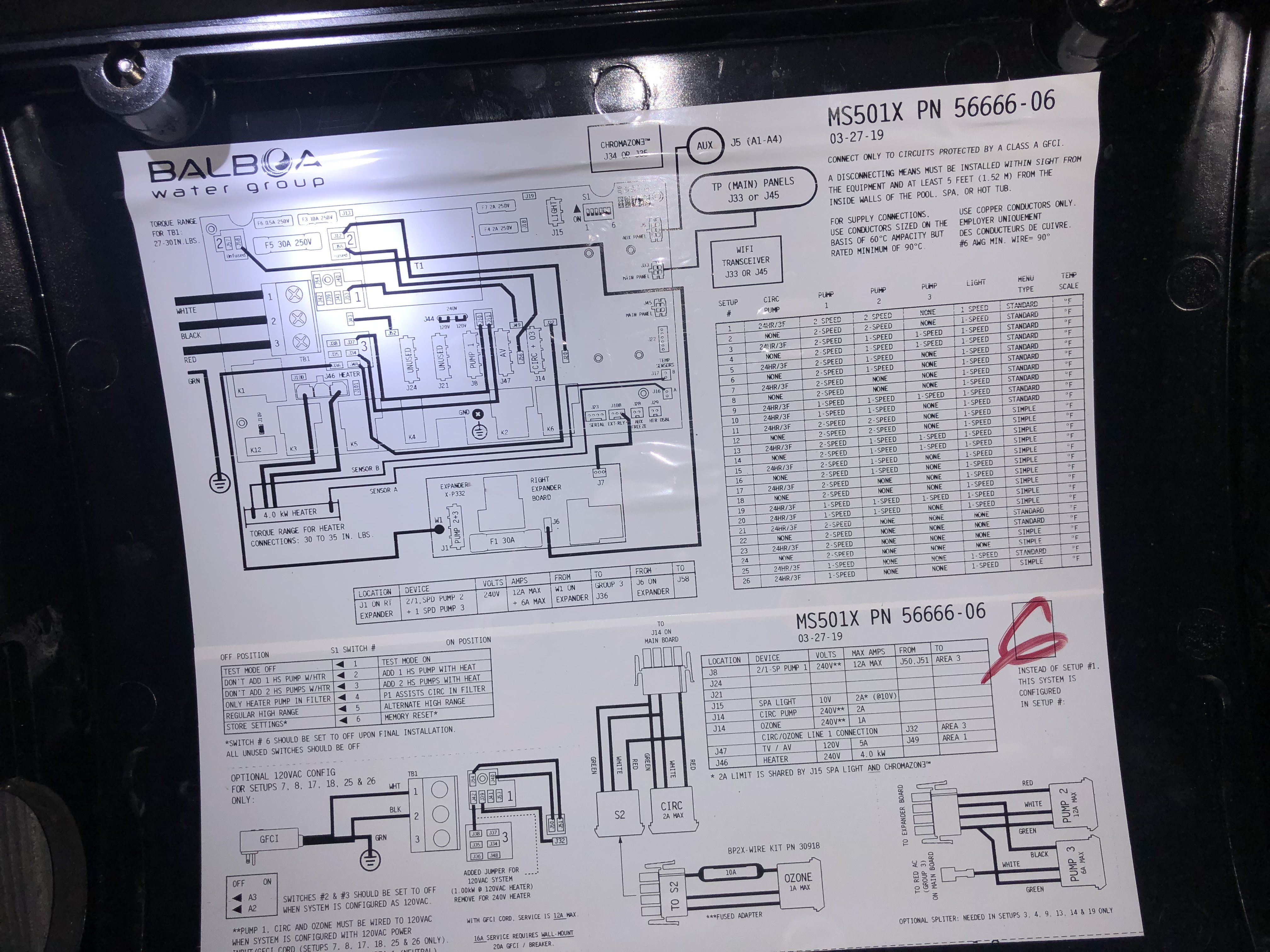

Hot tub is equipped with a Balboa ms501 board. Motor will not shut off when selecting high speed there is a loud noise and then motor will shut off after pause starts back up on low speed. Read the topic of bad relay so pulled the board and used 9 volt battery to trip relays with ohm meter across switched pins and when tripped I do get tone when released tone stops. Did this test on both the big and small relays. My question is could it still be relay stuck issue? Could top side control cause relay to have constant power if so how do you test that signal? Is there a test for whatever(if I am tracing correctly looks like a small chip?)sends the voltage to the coil to see if that is continuously sending power and bad?
Additional info that might be pertinent.   The water is heating fine but 2 of the 3 heater relays(K1 & K5) measure 76 ohms at the coil and all the other large relays on the board measure in the 150 ohm range. Maybe could cause motor to continue, if so would this also cause the can’t switch to high speed issue? Pump 2 is single speed on a separate board all works fine. Pump 1 when connected to pump 2 connection works fine on high speed.
