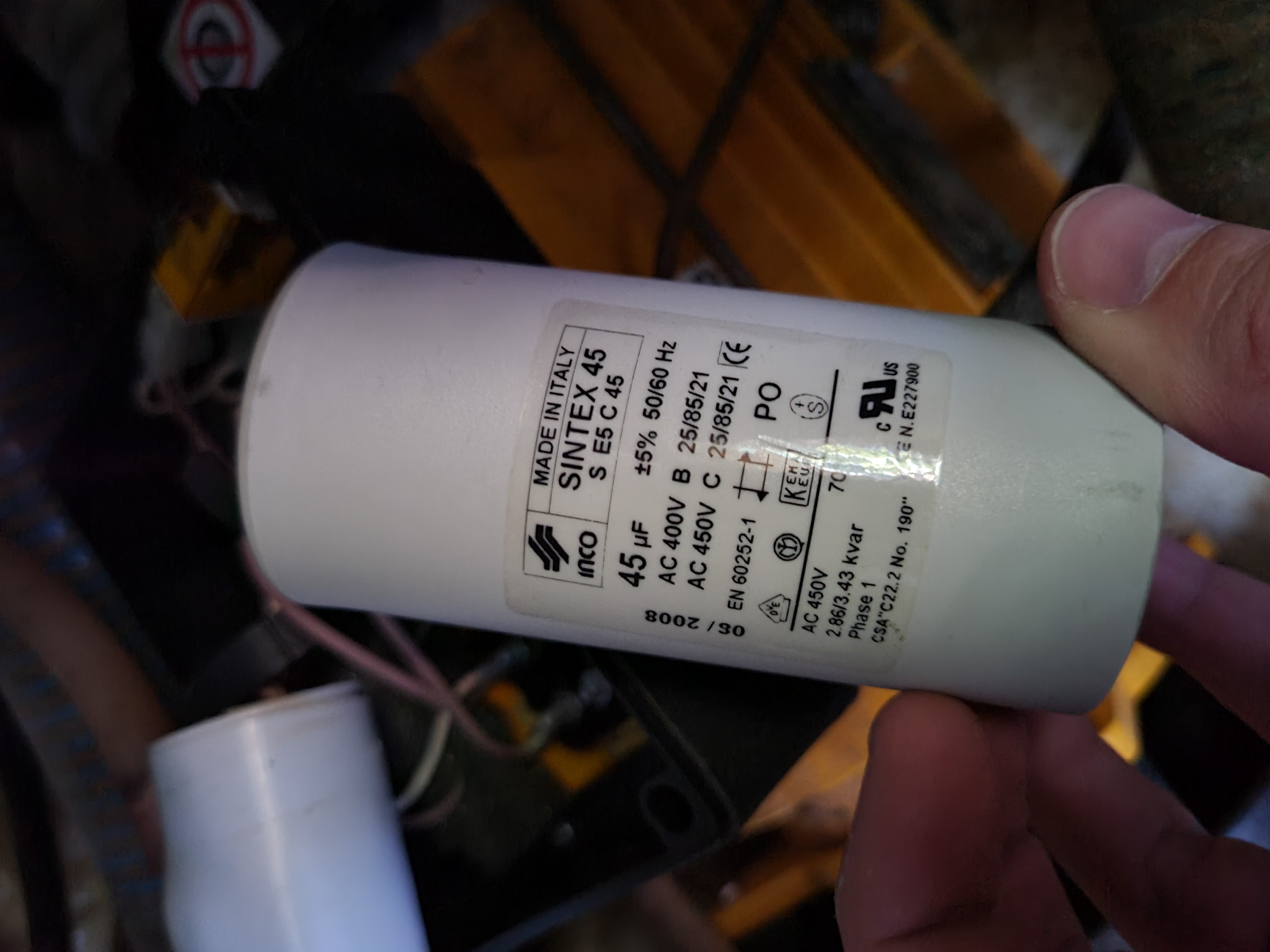

I opened up the pump and took a photo of the specs written on the start-up capacitor, but I don't have enough electrical experience to identify an appropriate replacement.
Could someone take a peek at the photo I've attached and let me know what an appropriate replacement start-up capacitor would be?
The details on the current capacitor are:
SINTEX 45  (manufactured August 2008)
S E5 C 45
45 uF
+- 5%   50/60 Hz
AC 400V  B  25/85/21
AC 450V  C  25/85/21
AC 450V
2.86/3.43 kvar
Phase 1
Thank you!

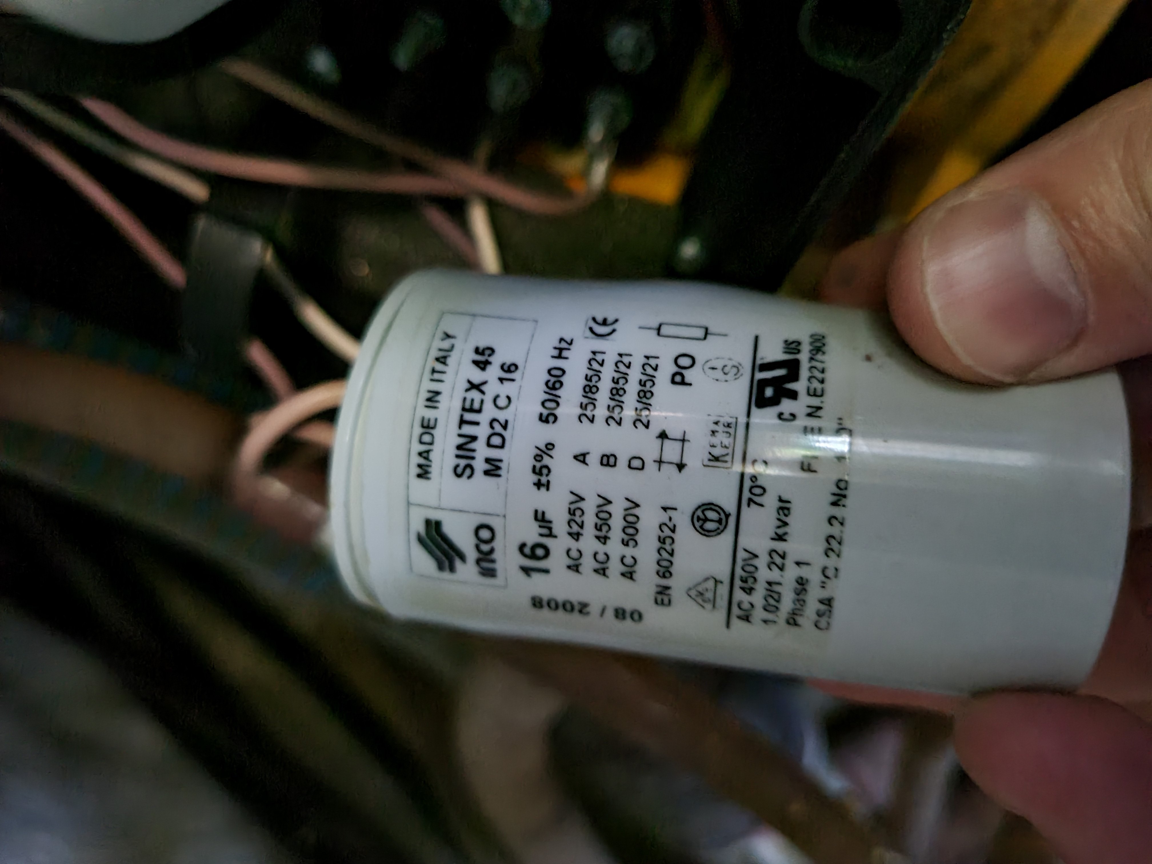

Dug a little bit more into this issue. My hot tub is an Arctic Spa and the pump model is NEW41. When I search Arctic Spa pump websites, I see they have listings for low speed capacitors and high speed capacitors.
So I'm probably mistaken about which capacitor needs replacing. The high speed capacitor is the larger one and works fine (not a start up capacitor). The smaller capacitor is for low speed operation (not a "run" capacitor) -- and since low speed is malfunctioning by my logic then that's the capacitor that needs replacing.
I've attached a photo of the smaller low speed capacitor.
Does this look like a suitable replacement? https://www.arcticspastore.com/arctic-spa-parts/low-speed-capacitor-arctic-spas/
