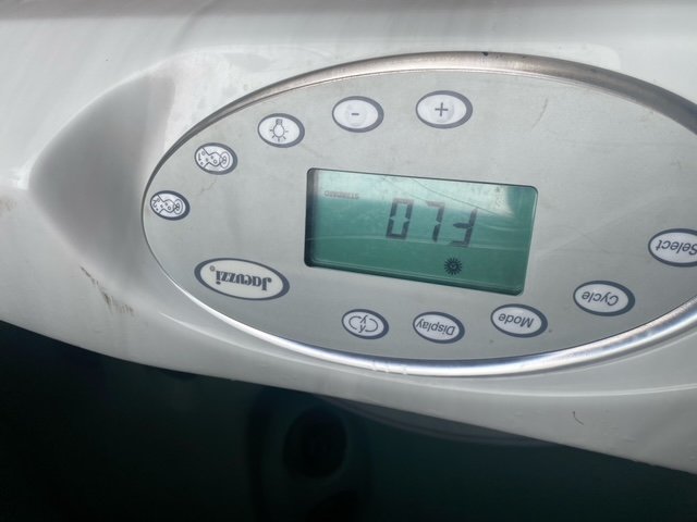

Bend089777 Posted June 6, 2022 Report Share Posted June 6, 2022 Hi All, I hope you are well, just wondering what the likely issue is for my 2005 J355 Jacuzzi, i have an intermitted FLO error, I have checked there is no air lock and it doesn't appear that the circulation pump is working, it is making a humming noise and when working sounds fine. Some photos and video attached, I have heard upgrading the circ pump and deleting anti freeze return line should sort it out? Thanks in advance! Ben 1624921021_spa3.mov Quote Link to comment Share on other sites More sharing options...
CanadianSpaTech Posted June 6, 2022 Report Share Posted June 6, 2022 Dirty filters? Remove the filter and run without and see if error comes back. Try that first. 1 Quote Link to comment Share on other sites More sharing options...
Bend089777 Posted June 6, 2022 Author Report Share Posted June 6, 2022 Hi, I did remove the filters and put new ones in about 4 months ago, I kept the caps on top of them, the change filter warning did not go away, I removed the filters then it did, replaced them without the little caps on top and it seemed to be ok for a while. I was going to run a cleaning solution through the spas system? may be clogged up, also give the filters another clean. Quote Link to comment Share on other sites More sharing options...
CanadianSpaTech Posted June 6, 2022 Report Share Posted June 6, 2022 Any time you get an error on the topside always remove the filters first and reset the breaker off/on. Run without them until issue is fixed. Remove them from the equation. Dirty filters are flow killers. 4 Months is a long time. Filters should be cleaned bi weekly and deep cleaned every 6 weeks with filter wash. Cleaner you keep your filters the better it will run. 1 Quote Link to comment Share on other sites More sharing options...
Bend089777 Posted June 7, 2022 Author Report Share Posted June 7, 2022 Thanks a lot! I did not know they have to be done that often! I have removed them and still have the clean filter error, any idea if running a cleaning solution through could fix the issue or will likely need to break down the lines and find out what is causing a blockage? if not what has burned out and causing the FLO issue.. Quote Link to comment Share on other sites More sharing options...

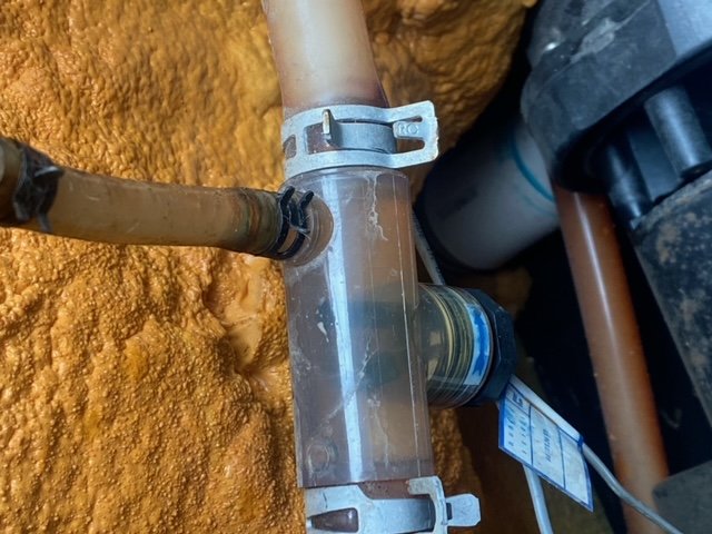

CanadianSpaTech Posted June 7, 2022 Report Share Posted June 7, 2022 In your second photo you see the flow switch. It has a post and a toggle. When the circ pump is running the toggle should be pushed up against the post making a connection. When the spa starts from an off position at the breaker and you power up the first thing to start will be the circ pump. It will move the water through the heater and across the flow switch closing the toggle against the post and this connection tells the heater that there is flow of water through the heater tube and that it's ok to turn the heater on. If there is a restriction of flow (Dirty Filters. Faulty circ pump, air lock or bubbles) it will send a flo error to protect the heater. If the toggle is against the post and you have a flo error you need to test/bypass the flow switch. Disconnect the flow switch from the circuit board and you will see 2 pins sticking out from the board. Use a flat head screwdriver and touch the 2 pins at the same time and this should bypass the flow switch and if the flo goes away replace the flow switch...or you could cut the wire and join the 2 wires together. Very important to make sure you have flow before bypassing the switch. If the heater fires with not flow it will boil the water in the tube in a second and can cause damage to the heater or even fire. 1 Quote Link to comment Share on other sites More sharing options...

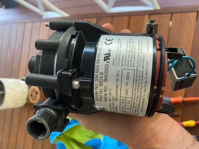

Bend089777 Posted June 10, 2022 Author Report Share Posted June 10, 2022 Update 2: The circulation pump does switch on but I have to move one end of the pump up (end with no tubes) once its in that position the flo switch closes and the circ pump starts. I have wedged a small ceramic non combustible item under it, the bracket the circulation pump goes into appears to be not fit for the pump installed or it has been moved? Quote Link to comment Share on other sites More sharing options...
CanadianSpaTech Posted June 10, 2022 Report Share Posted June 10, 2022 Not uncommon with the Laing E-10 circ pumps. They are magnetic drive and have small bearings inside the post sits on and they can get wonkey and start/stop. You will likely need to replace it. As for the bracket it sits in it is not a big deal if it is removed and just use a screw to hold it in. It's not going anywhere...unless you are going to move the spa to a different location. I normally just drain the spa and run AHH-Some plumbing line cleaner through it before draining if you have not done a purge on it in a while. 1 Quote Link to comment Share on other sites More sharing options...

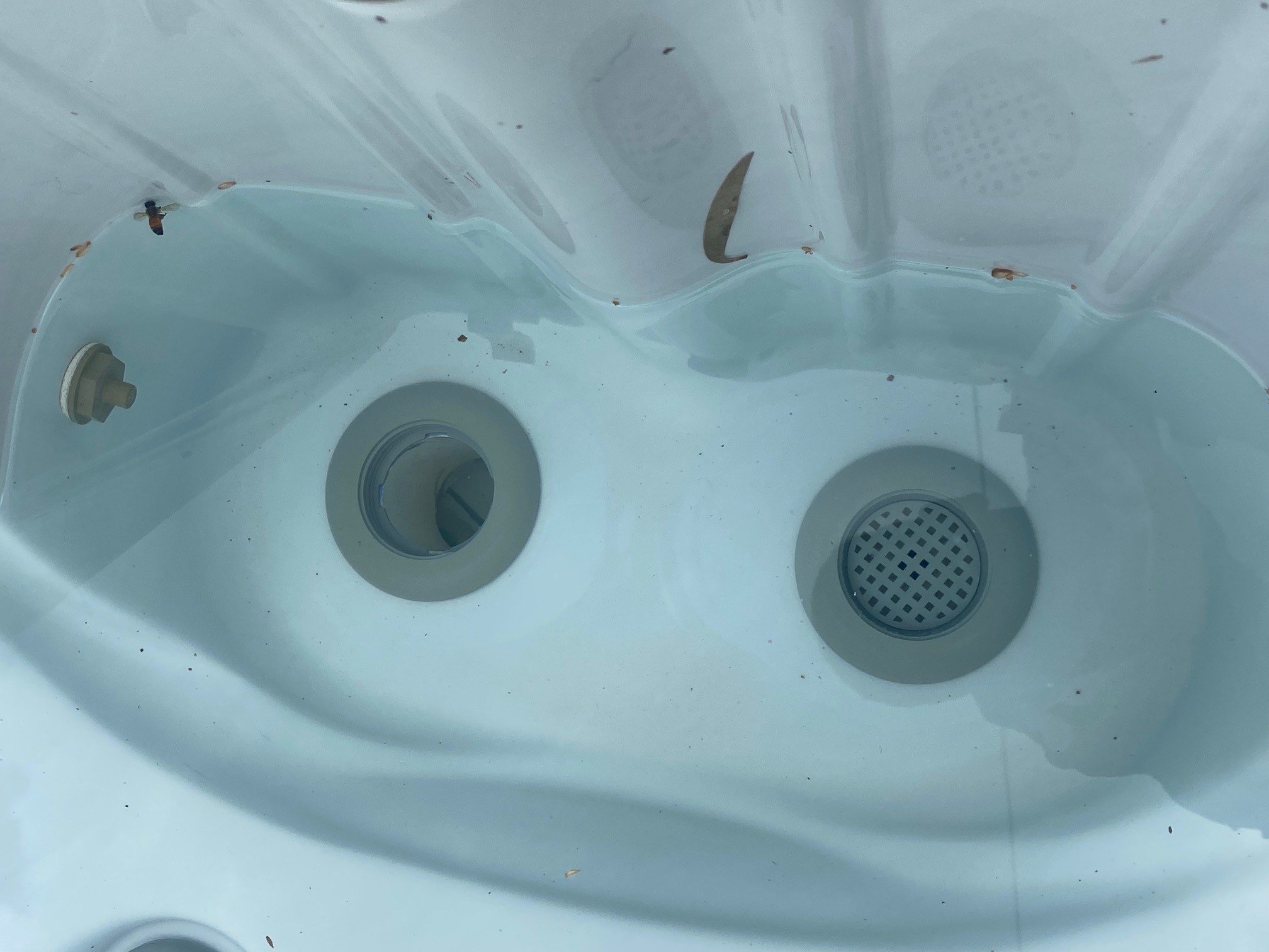

Bend089777 Posted June 15, 2022 Author Report Share Posted June 15, 2022 Thanks Surf! Anyone know where i can get this filter part from? one is broken as seen below. Quote Link to comment Share on other sites More sharing options...
CanadianSpaTech Posted June 15, 2022 Report Share Posted June 15, 2022 Not all systems with circ pumps produce bubbles. It's not broken. they come like that. Right side feeds circ pump left side feeds a pump. Quote Link to comment Share on other sites More sharing options...

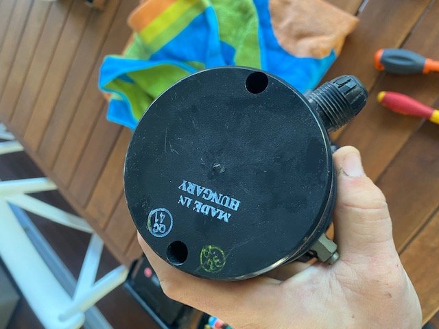

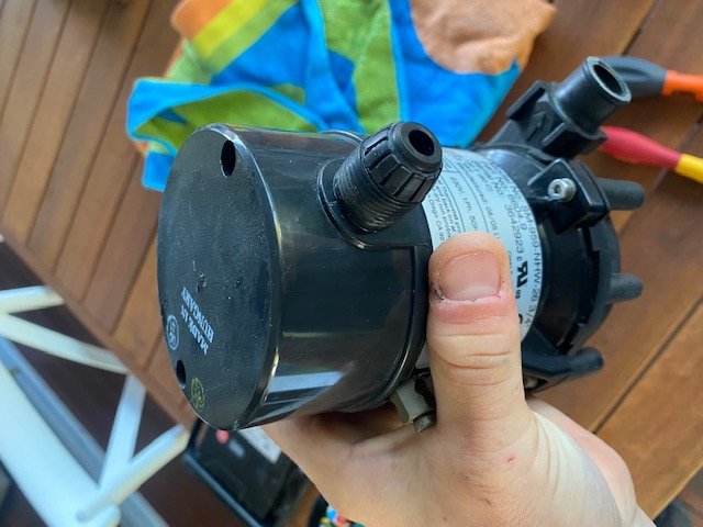

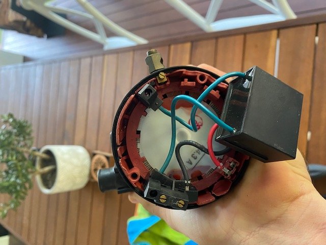

Bend089777 Posted June 20, 2022 Author Report Share Posted June 20, 2022 HI All, I have installed the new circ pump, as pictured the old one i have pulled apart, is the impeller meant to be as loose as pictures and in video? Was thinking could get it rebuilt (magnetic bearing) Thanks! Video.mov Quote Link to comment Share on other sites More sharing options...

Bend089777 Posted June 22, 2022 Author Report Share Posted June 22, 2022 Thanks, all it was showing is the internal impeller within the pump and the bearing/shaft it was on had some play in it, moved around quite a bit, was wondering if it would be worth trying to get it fixed, however appears access to the area behind the pump may be tricky. Quote Link to comment Share on other sites More sharing options...
CanadianSpaTech Posted June 22, 2022 Report Share Posted June 22, 2022 If you open the front you will see the impeller there wil be a "chrome" ring. If you pull it it should pull apart. The magnet is holding it in place and when you go to put it back together the magnet will pull it out of your hand. Inside you will see the tiny bearing ring and this is where they get loose/wonky. I normally just replace in this case (time is money) but think there is a rebuild kit available. Make sure to order 230V if buying new Quote Link to comment Share on other sites More sharing options...
