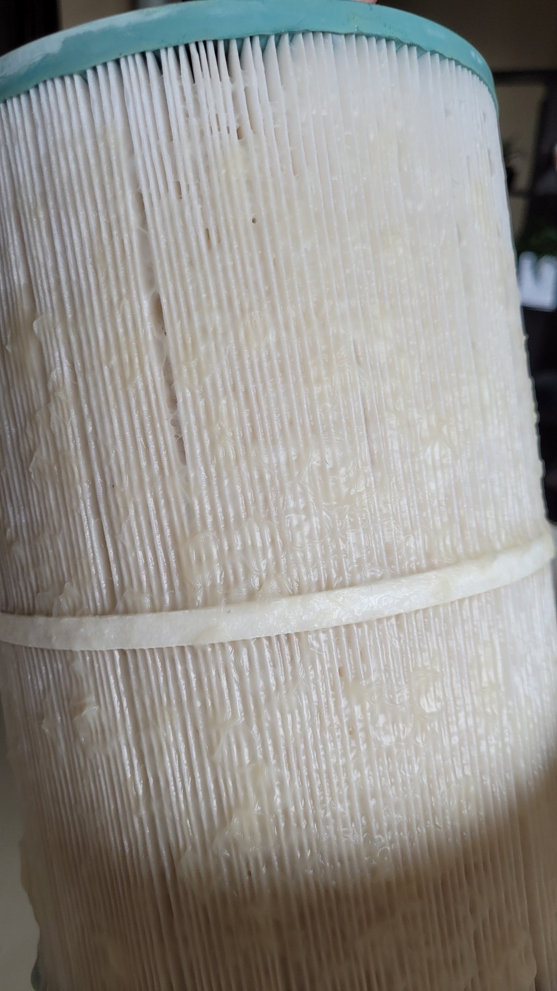

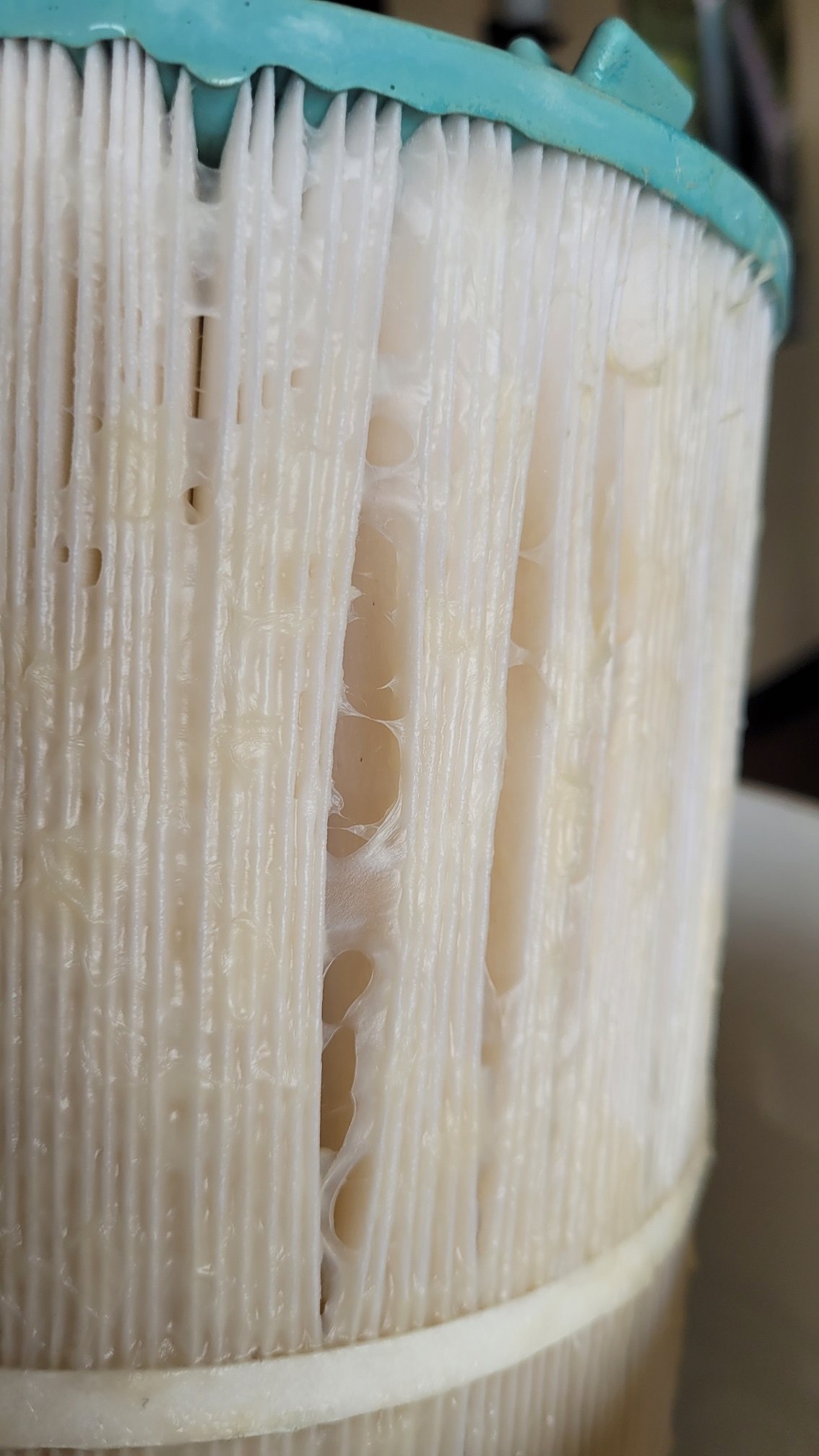

wookinpanub Posted December 24, 2021 Report Share Posted December 24, 2021 I've seen this referred to as white mold, but not sure that's it? It is almost like a gelatenous material that starts to spread over the outside of the filter element - primarily on the jets filter (not as much water flow on a regular basis) while I've not found any on the circulation filter. Things I've done / tried Bleaching my filters after washing them Replacing the ozonator (was broken for some period of time I believe) For 5 straight days I overloaded it with chlorine to the point I had to wear a filter mask and goggles to even be in the room. All filters were floating in the tub for that period Since that time, I still see that white material just barely starting on the filters again. At this point I don't know what else to try, as I've even heard that draining the tub doesn't help as whatever it is may go 'dormant' and just come back? Spa is a Dimension One Diplomat, 2014. Any thoughts are greatly appreciated!! Quote Link to comment Share on other sites More sharing options...
RDspaguy Posted December 24, 2021 Report Share Posted December 24, 2021 Use ahhsome spa purge, per package directions, repeatedly until no new gunk comes up on the foam. Ozone is not a sanitizer, and it does not eliminate the need for one. Ozone is an oxidizer that burns off cc and excess fc. You still need chlorine after each use and once or twice a week at minimum. Quote Link to comment Share on other sites More sharing options...
wookinpanub Posted December 24, 2021 Author Report Share Posted December 24, 2021 1 hour ago, RDspaguy said: Use ahhsome spa purge, per package directions, repeatedly until no new gunk comes up on the foam. Ozone is not a sanitizer, and it does not eliminate the need for one. Ozone is an oxidizer that burns off cc and excess fc. You still need chlorine after each use and once or twice a week at minimum. I looked that brand name up, it appears there are a number of options and types (gel, liquid, etc). Can you help me narrow it down with a specific name? And I have been using chlorine, but potentially not as diligently as I should have. I'll keep an eye on that as well. Quote Link to comment Share on other sites More sharing options...
