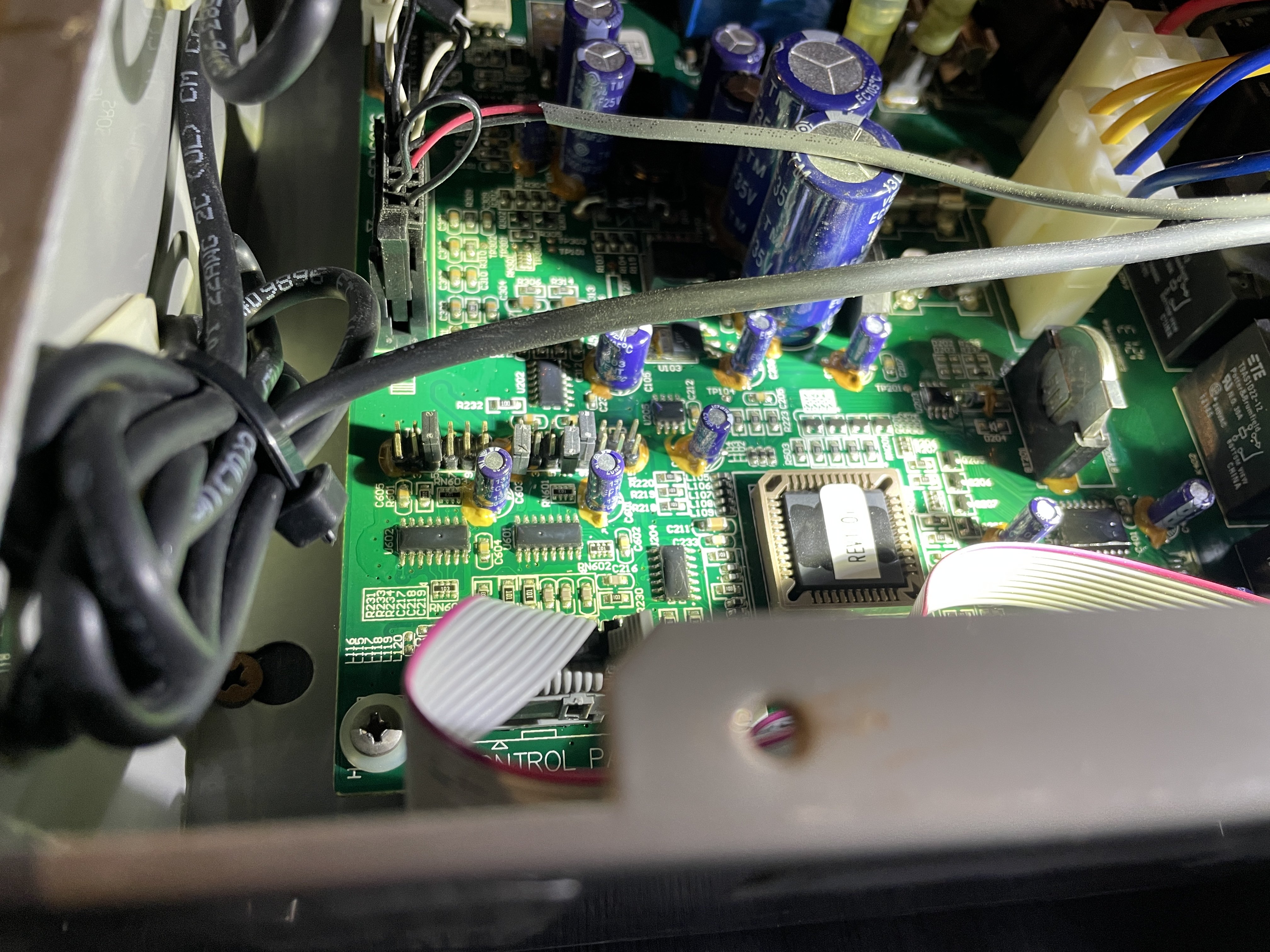

CanadianSpaTech Posted October 21, 2021 Report Share Posted October 21, 2021 Post photos of the circuit board and the schematic on the inside cover so we know what you have. Quote Link to comment Share on other sites More sharing options...

CanadianSpaTech Posted October 24, 2021 Report Share Posted October 24, 2021 Is there a Persistent Memory reset on that board? Post photos of the entire circuit board and the schematic on the inside cover. Quote Link to comment Share on other sites More sharing options...
