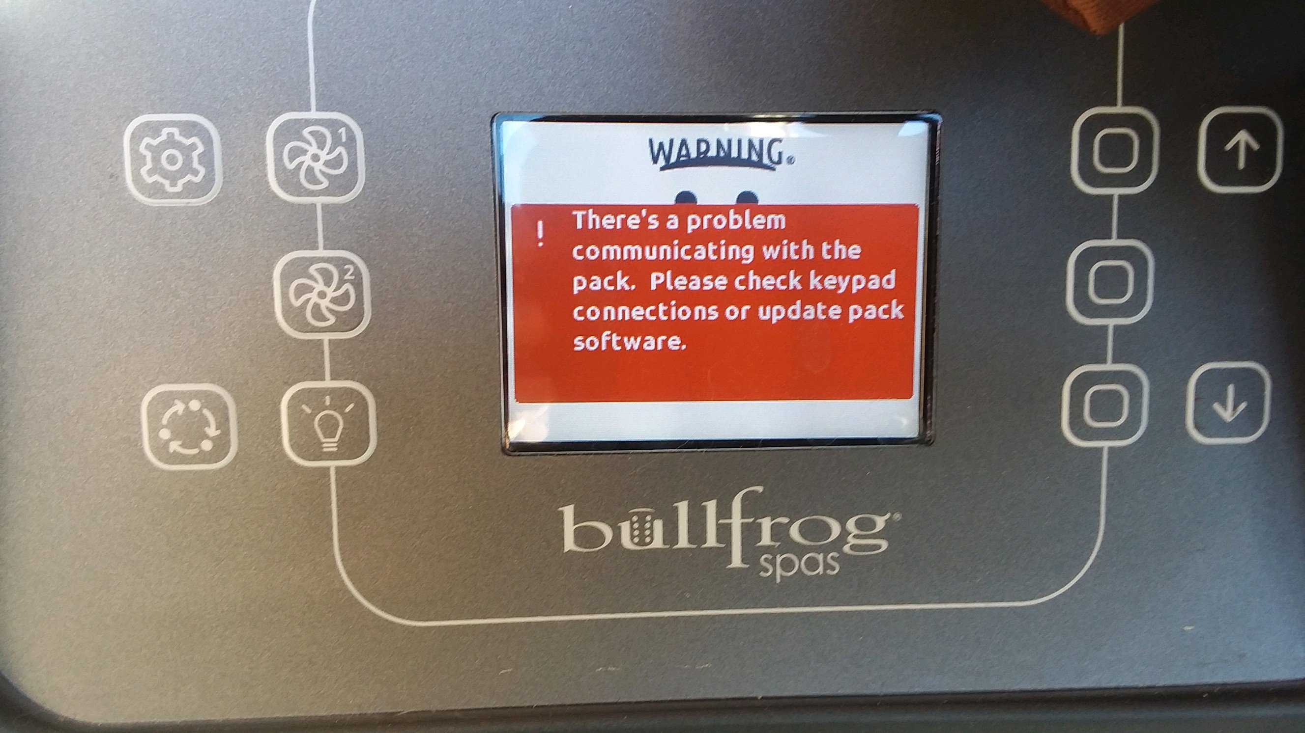

SoakerDude Posted August 30, 2021 Report Posted August 30, 2021 Hi All, My Hydropool Self-Clean recently stopped working with message on the LCD that says "Problem communicating with the pack, check keypad connections or update the pack software". My local service dealer can't make it out until middle of next week but suggests I will need to replace the spa pack (my tub is 5 years old), so while I sit with a cold tub I was just wondering is this usual? Do they only last that long or could I have perhaps done something to save it? These last few weeks have been major hot here (in the 40's with humidex) so I wonder if the heat contributed to it's demise. Thanks for the input, SoakerDude Quote
RDspaguy Posted August 30, 2021 Report Posted August 30, 2021 The heat and humidity could play a role, but it's not likely. More likely is mice chewing on wires. I would check all the wiring for damage. Quote
ciderjack Posted August 30, 2021 Report Posted August 30, 2021 Every single one I've seen that says "problem communicating with pack" was a bad pack. Quote
SoakerDude Posted August 30, 2021 Author Report Posted August 30, 2021 1 hour ago, RDspaguy said: The heat and humidity could play a role, but it's not likely. More likely is mice chewing on wires. I would check all the wiring for damage. That's what I'm hoping just due to the age of the tub. Not that a chewed wire is a good thing, but also kinda hoping maybe a rodent ran by something and jarred it loose. Quote
SoakerDude Posted August 30, 2021 Author Report Posted August 30, 2021 1 hour ago, ciderjack said: Every single one I've seen that says "problem communicating with pack" was a bad pack. But what makes the pack "go bad"? Do they really only last 5 years? Quote
RDspaguy Posted August 30, 2021 Report Posted August 30, 2021 The computer circuit board in the pack is exposed to some pretty rough conditions under that cabinet, and if you put your laptop under there it wouldn't last a month. Be impressed it lasted 5 years, not upset it only lasted 5 years. Circuit board failures are uncommon, but can occur any time. Often they result from power surges, lightning strikes in the area, or transformer failures. But a small leak in the equipment area and high sanitizer levels will corrode everything under there, including the electronics. 1 Quote

BSchirm Posted September 27, 2022 Report Posted September 27, 2022 12 hours ago, Ayberk said: Hi, I am experiencing the same issue. Did this get resolved by any chance? Thanks. I ended up replacing the spa pack and that fixed the issue. So far no other issues. Quote
Whitty Posted April 21 Report Posted April 21 I have the same error on my hydropool 495g SC. I opened up the power pack and saw that there were three fuses inside - an SC-20, an SC-25 and a 0.5 amp which i guess is probably for the display. I am thinking of replacing the two time delay fuses - would that fix this power pack communication error? Quote
