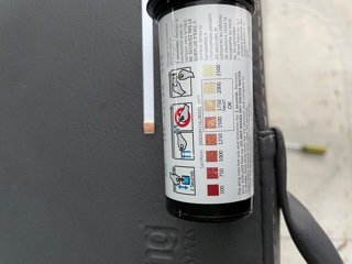

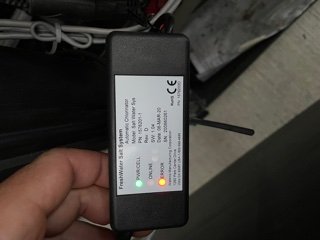

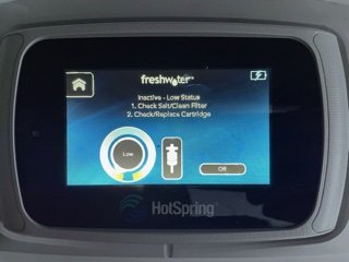

Thanks for the reply.  Yes, I have a FreshWater Salt System.  I just replaced the cartridge yesterday.  The system status shows Inactive - Low Status.  This is after adding about 9 cups of salt.  Current NaCl level shows around 1500 ppm.  Upon removing the front panel, the FreshWater Salt System error light is flashing red.
