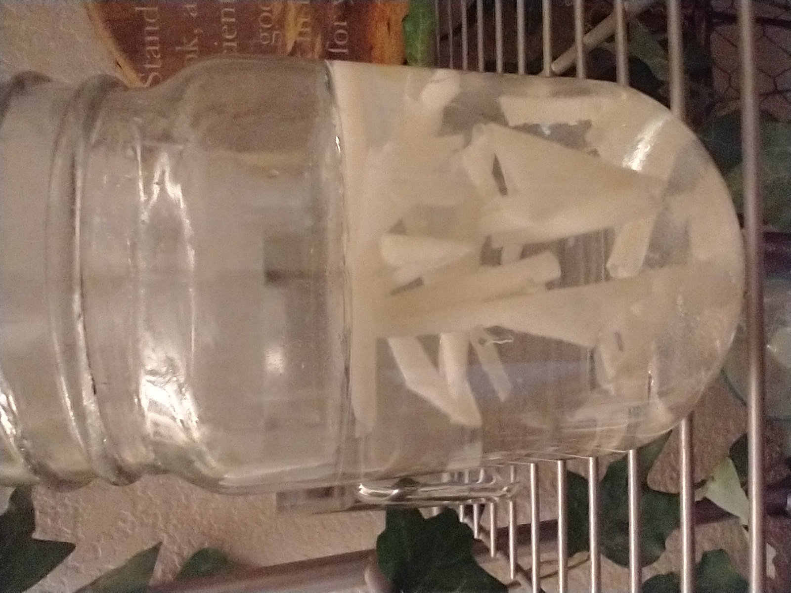

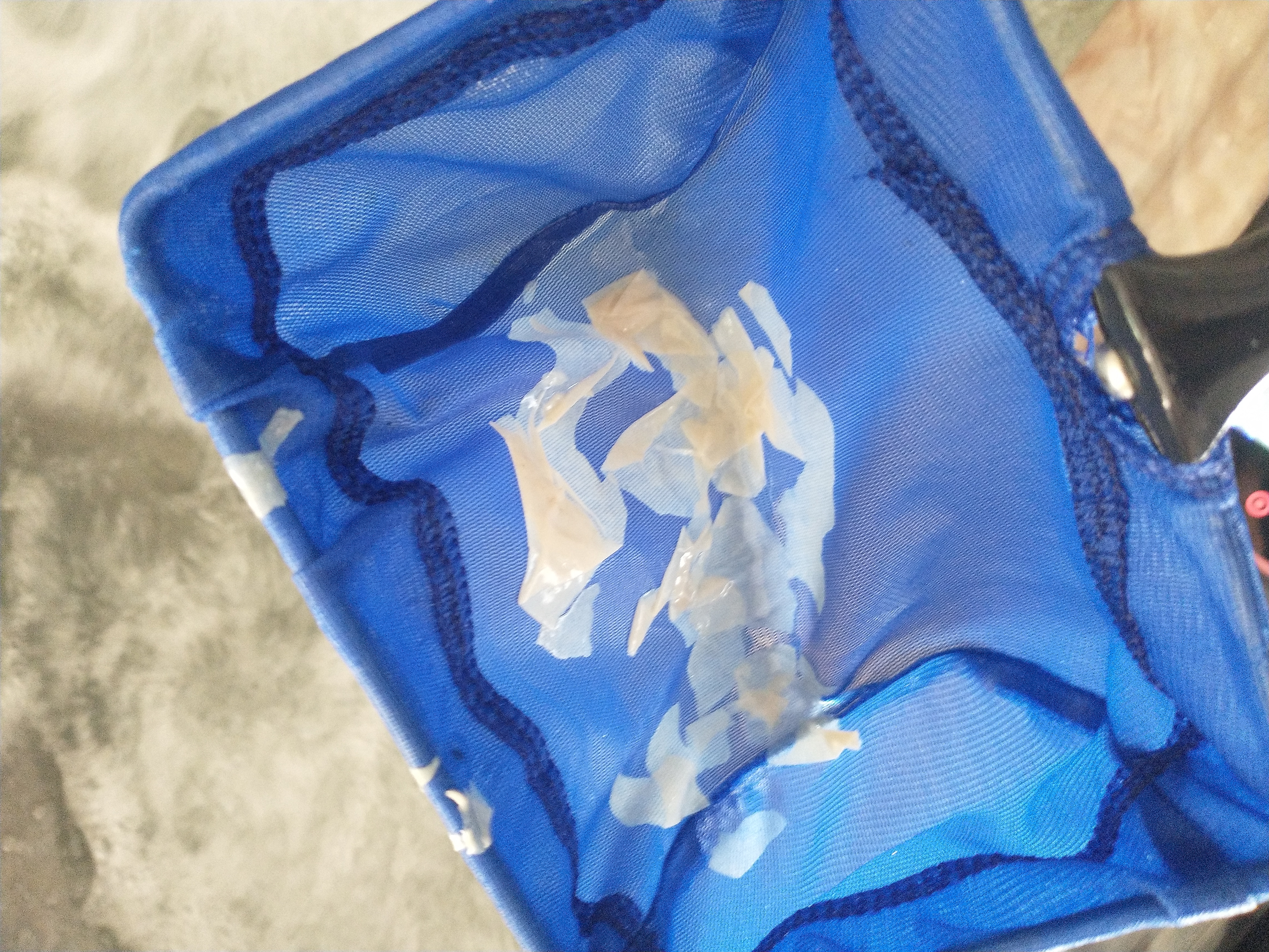

Jessmzam Posted June 8, 2021 Report Share Posted June 8, 2021 Has anyone seen this before!?! My hot tub is less than a year old it's a Dynasty Palm Island II everything works great it has lots of extras like the ozone thing a gecko motor blah blah blah... But after only about 2 months in these little flakes started to appear, I have been a stickler for checking the water chemistry at least 2 times weekly. At first I really thought it was like someone's dead skin that came off 🤢 but it gradually got worse even after shocking, lowering the PH, water changing. We stored it for the winter after about 3 water changes for cleaning and pulled it back out, they are still here!! Bigger and way more, 4 water changes, shocking, vinegar, bleach testing for biofilm (didn't desolve by the way) it's still here, less but they are so big. I haven't found anything on the same level. My dealer is dumbfounded, I'm stuck. Quote Link to comment Share on other sites More sharing options...
waterbear Posted June 15, 2021 Report Share Posted June 15, 2021 Could be: 1) calcium stearate from lube used in the manufacture of the pipes (however, this mostly affects tubs built between 2016 and 2018) 2) calcium silicate (a type of scale that does not dissolve in muriatic acid) 3) scale (calcium carbonate) that will dissolve in muriatic acid but not necessarily in vinegar A full set of test results will tell us more so we are not just guessing. However, I suspect that your calcium hardness is high and your pH has been high also. I will also bet that your TA is high. (most of the 'recommended' ranges for these parameter put them way too high for tubs. The ranges recommended are more applicable to pools that are running trichlor tabs. DO not test with strips, they don't have the resolution needed to determine what is going on and they cannot test calcium hardness, only total hardness. They are also prone to testing the pH lower than it really is. 1 Quote Link to comment Share on other sites More sharing options...
Gadino22 Posted February 5, 2022 Report Share Posted February 5, 2022 I have the exact same issues. Ive drained the tub, changed the water, shocked the system.. going to use a different garden hose in case that's an issue other wise I'm stumped. And super frustrated.. Quote Link to comment Share on other sites More sharing options...
Ahhsomeguy Posted February 5, 2022 Report Share Posted February 5, 2022 Quote  Both individuals with the same issue say they have drained their tubs to change the water but are not mentioning as to whether or not they have employed an effective plumbing purge product.  Draining the water is absolutely recommended periodically but the one thing you should do just prior to draining is putting in a plumbing and jet cleaner to clean the insides of the plumbing infrastructure.  I tend to share Waterbears hunch that it may be a calcium issue. It is very unlikely that you have a calcium stearate issue.  Most manufacturers purchase their tubing from a very large and popular manufacturer.  If there was another calcium stearate issue this forum would be lighting up with lots of affected tubs.  Be sure that you are both using chlorine or bromine in the correct ongoing dosages.   2 Quote Link to comment Share on other sites More sharing options...
RDspaguy Posted February 5, 2022 Report Share Posted February 5, 2022 At a glance I'd say biofilm. Use ahhsome spa purge as directed. 1 Quote Link to comment Share on other sites More sharing options...
Cusser Posted February 5, 2022 Report Share Posted February 5, 2022 My guess is calcium carbonate. Carefully take some residue in a glass container, wear eye protection, and add muriatic acid dropwise. If there's any bubbling, indicates carbonate. Quote Link to comment Share on other sites More sharing options...
