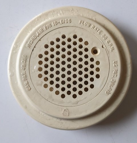

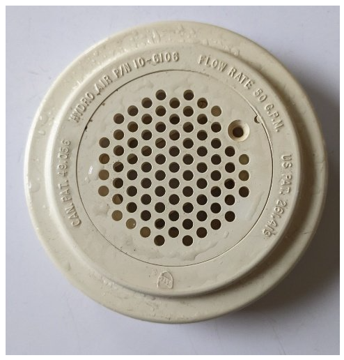

We purchased ourselves a 30-year-old Crown Nemco spa, "cheap"...
So far it's been an education, but I don't quite regret it (yet!)
This safety discussion is a good 'reality check', I do appreciate the shocking descriptions, awful as they are.
Is it likely that the suction cover on this old tub is VGB compliant? When did that standard go into effect? Our drain is on the side at the base of the foot-well, so at least it can't be sat upon.
The suction plumbing has a wye near the drain, which also goes to the in-pool filter, which then takes some of the suction that the pump creates, however I don't think it's much, the filter only has a 1" pipe feeding it.
Thanks.

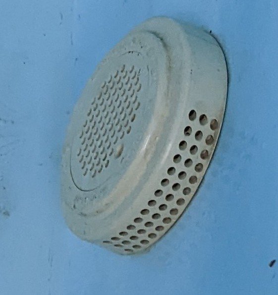

Hello, I'm trying to figure out how to remove this suction cover, but no luck.  It won't budge.  I'm obviously missing something and don't want to break it.  Any ideas on how to remove this cover.  I have a bunch of mold I would like to clean from it.  Please any advise would help.  Thanks.

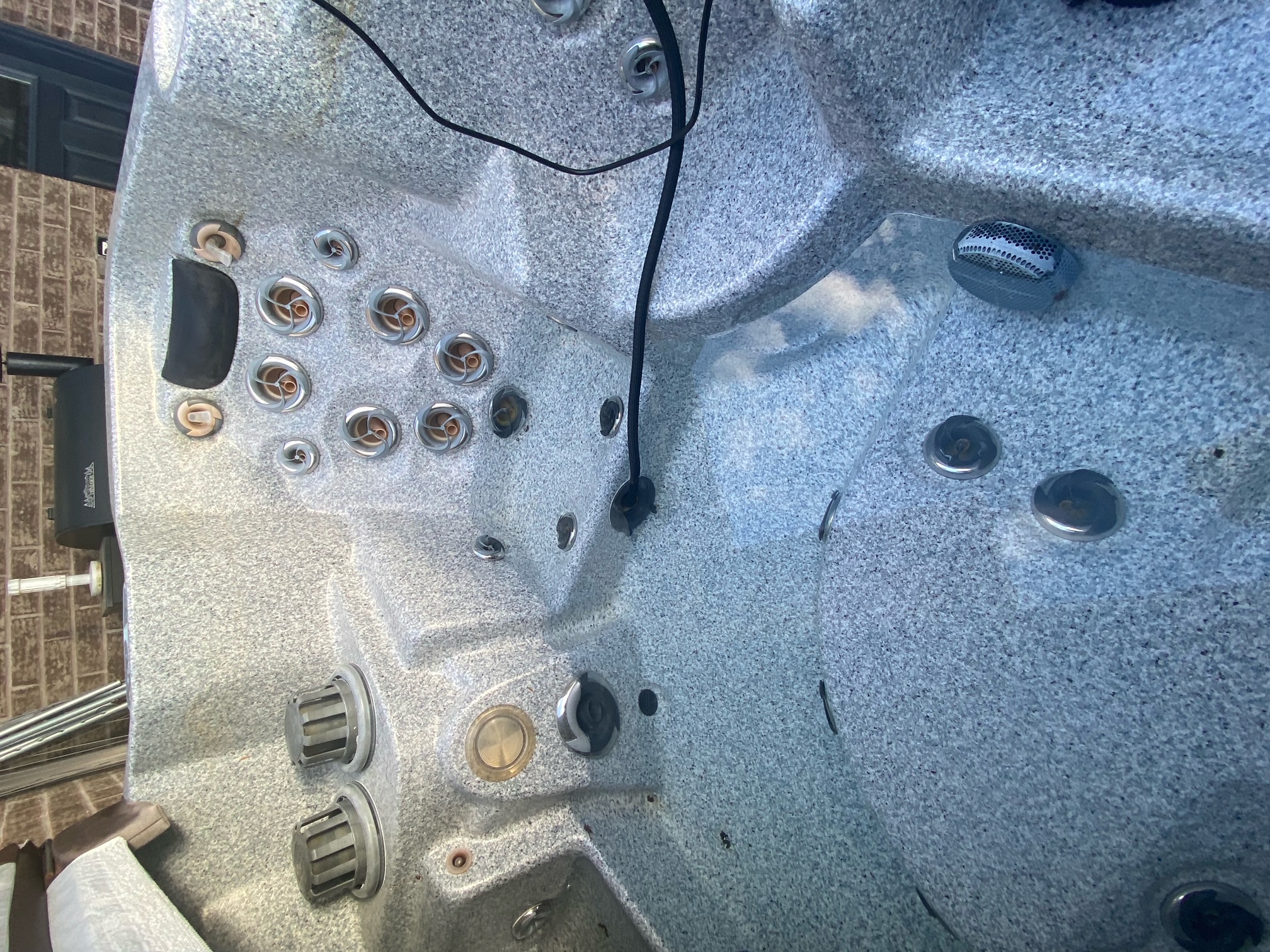

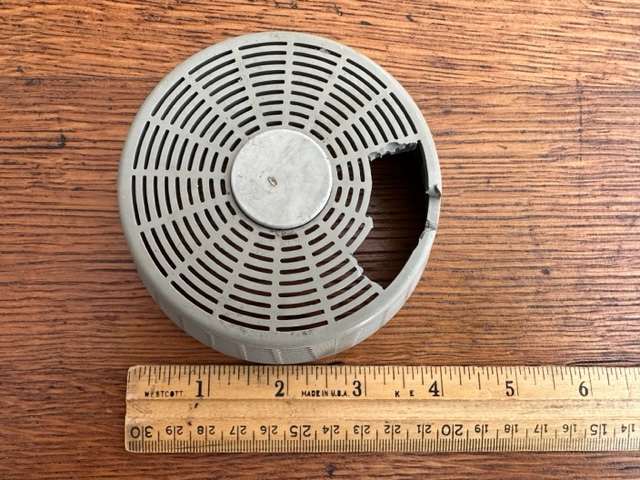

First time owners of a hot tub that came with a house we purchased. I now understand the importance of updating and replacing missing/broken suction covers. I have been unable to find replacement covers for our D1 Amore Bay (2008?) and am now afraid to use the hot tub! Hoping @CanadianSpaTech @waterbear @jimmythegreek or others can help suggest a solution. Can I purchase larger covers and attach them with screws to make the hot tub safe? I appreciate any recommendations. Attaching photo of an old cover.
Watch Video here: https://www.youtube.com/watch?v=zOUXMv_GTzU&t=49s
Website here: https://hottubpartsofamerica.com/suction-return-replacement-cover-cmp-4-15-16-diameter-170-gpm-dark-gray-pentair-replacement/
Not sure if this will help but you might want to contact HTP of America and give them all your measurements and see what they recommend as what you have is likely discontinued.
Including better/more photos might help us come up with a solution. Photo of the footwell with the cover removed so we can see what is there to attach to. Does the round center cap come off of the suction cover with a screw behind?
