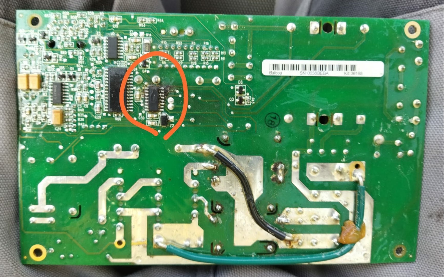

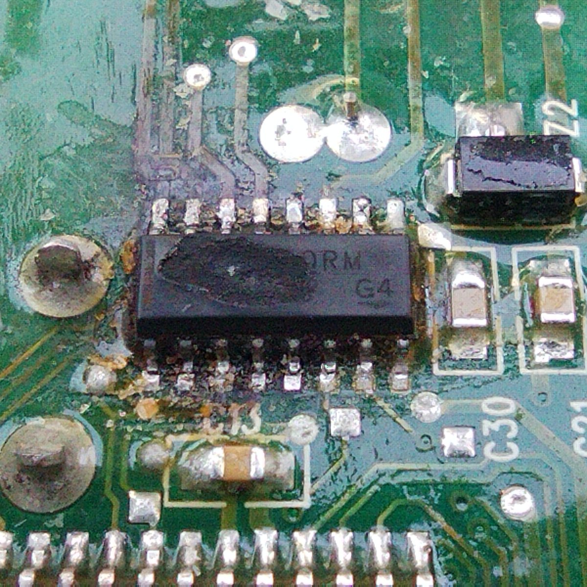

On 10/6/2022 at 12:17 AM, dodol said:
Hi,
Could anybody help me giving the reference of the IC that drives the relays? Mine has some how... Burn...
Thank you in advance
In my GS100 this is a TI SN75468.
